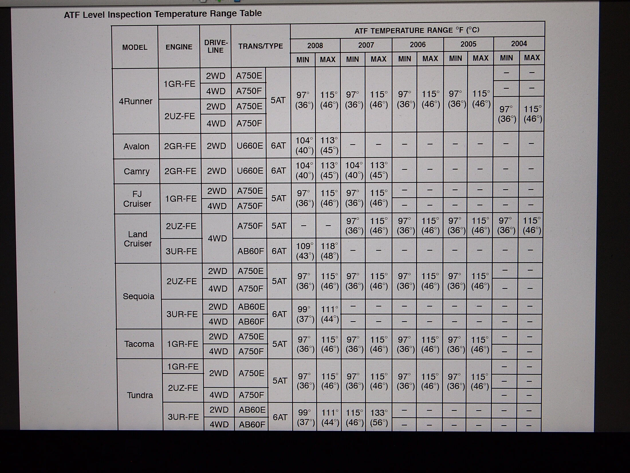

Notice: All 04-07 AT were underfilled at the factory (see TSB).
98-03, set level with A/T oil temp #1 at 158F to 176f. When using a full synthetic, set as close to the lower temp of 158F, is best.
04-07, set level with A/T #1 oil temp at 97f to 115f. When using a full synthetic, set as close to the lower temp of 97F, is best.
Toyota TSB, lower the A/T fluid temp in 04-07, due to factory underfilling them.

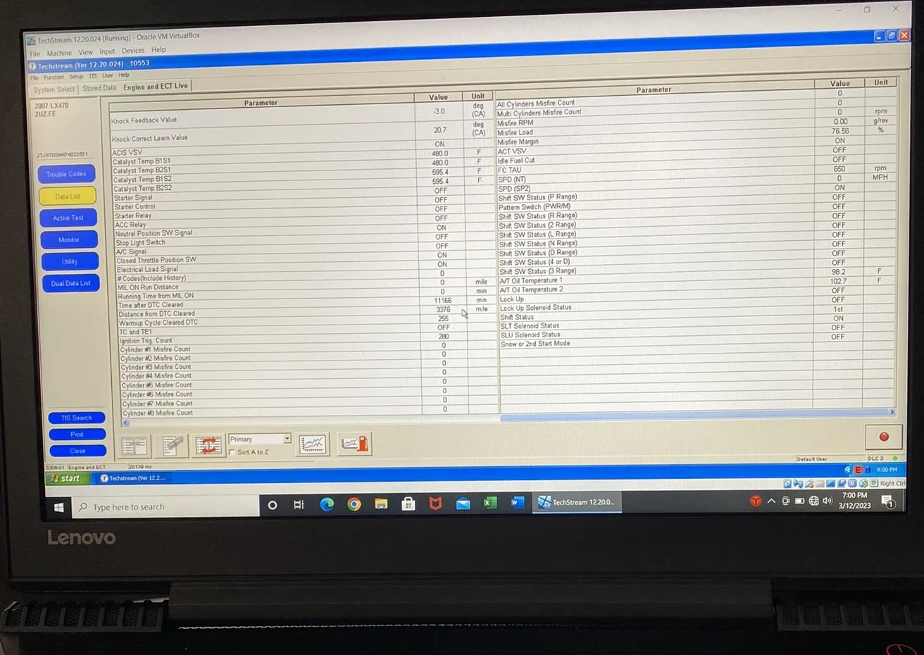

Tech stream. Note; 06-07 display more data point.

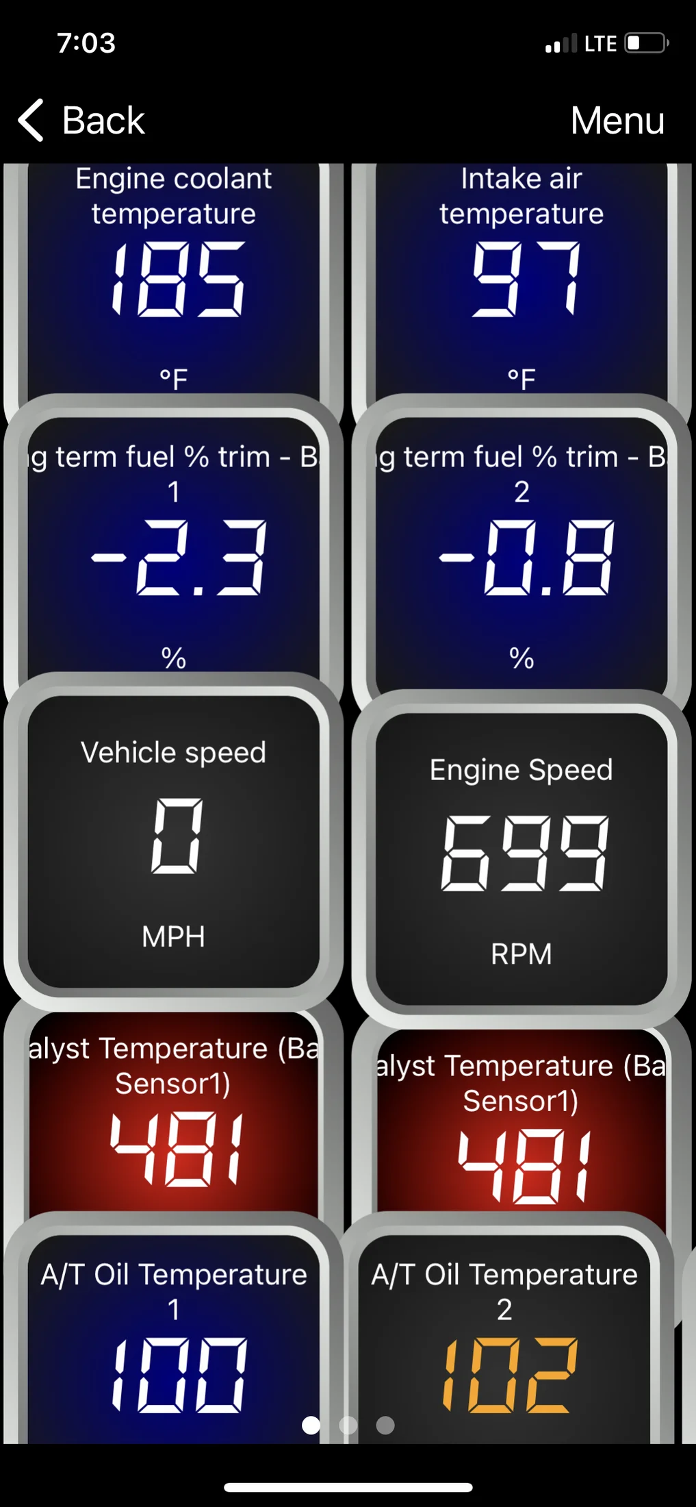

OBDmxII displays, wirelessly on iphone. Very handy data readings, while under vehicle in the 04-up, while pulling A/T level check plug.
TSB for 2004-08
04-07 DO NOT USE the FSM dash A/T oil temp light flashing procedure, in 2004 -07. Which is based on higher temp. Which will result in underfilling A/T
