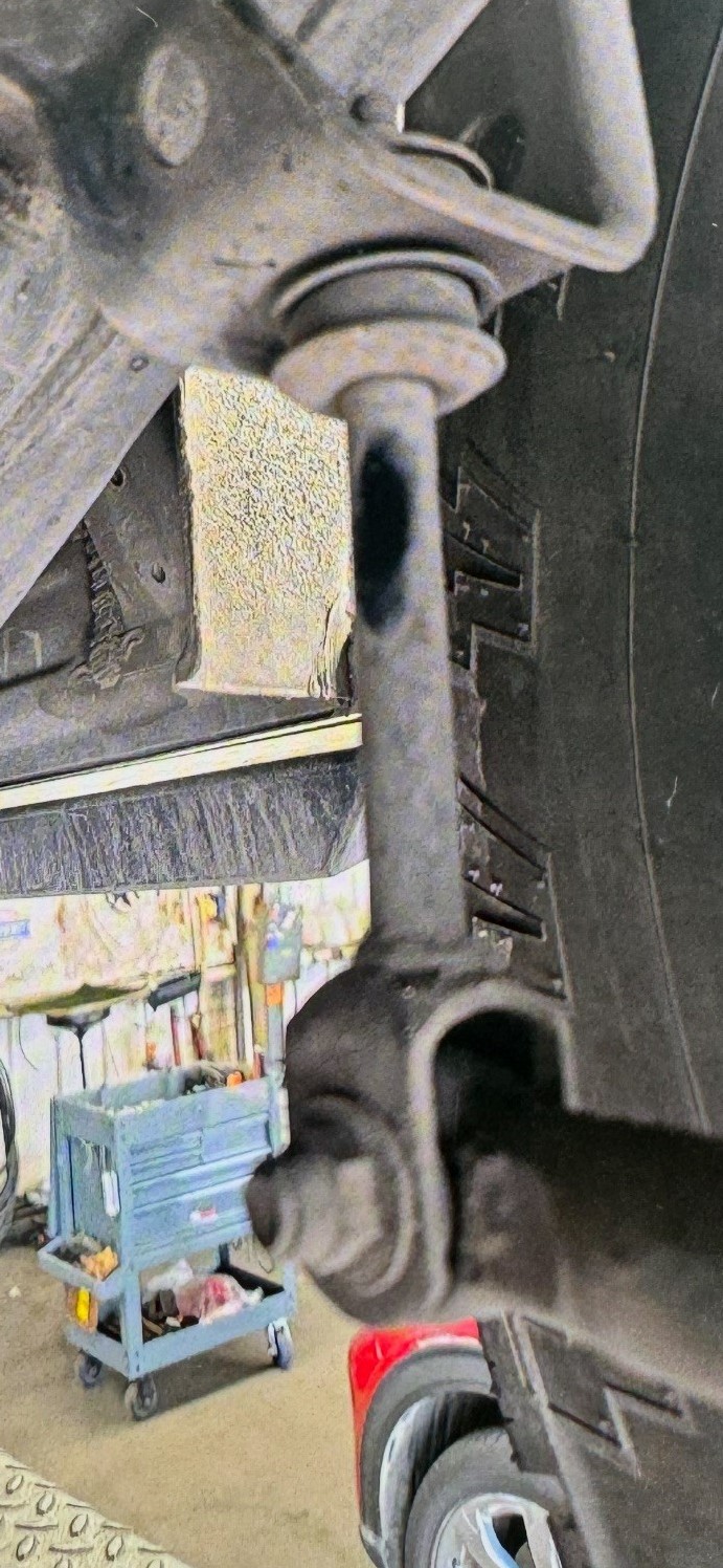

I had this occasional "jingle" when going over speed bumps, etc. and mentioned it when i brought it in for a "checkup". The mechanic has been spot on with other things...so I have no doubt this is where the noise is coming from. He showed me that my rear sway bar links are loose, creating that noise. He told me to get the sway bar links/bushings/hardware. FYI, I had an alignment done recently just because it had been 5-7 years and also to check ball joints, tie rods, etc...all was good and tight. Alignment was done by another trusted place, but different from mechanic.
Now...questions/comments:

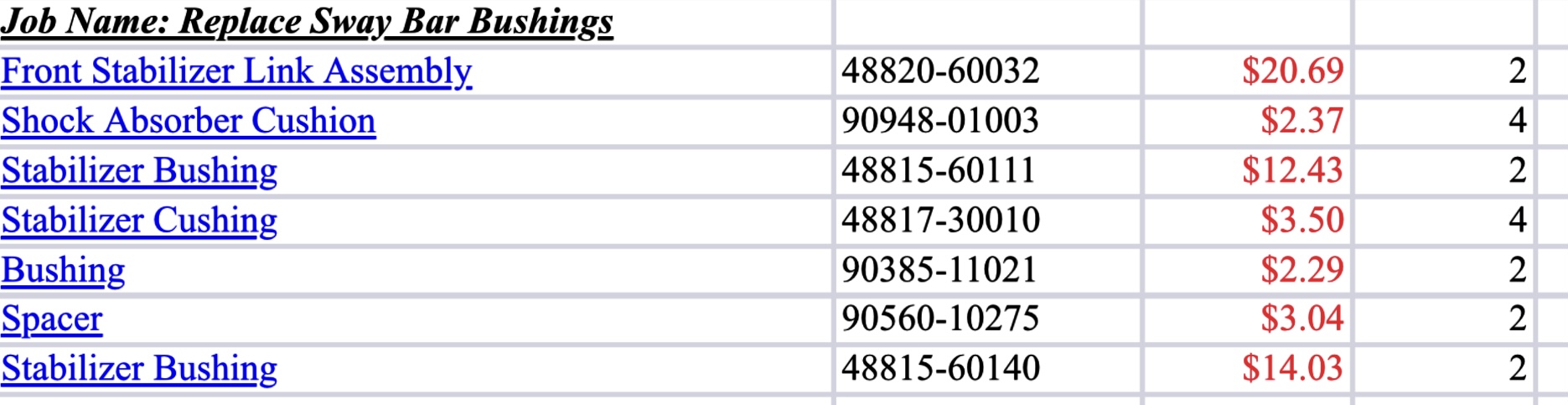

I just ordered these bushings for front and rear. I ordered a pretty bare bones OEM “kit” with ONLY the actual bushings because my truck is rust free and just has old bushings. I did get the front end link because the bushing is part of the assembly.
This looks what I was hoping to find...a list of OEM parts to order for front and rear.
Thank you!
There is a bushing that goes around the bolt and passes through the swaybar (90385-11021 listed above). It takes the most load and will fall apart possibly causing the noise you are hearing. It can also give a little of a loose or "tippy" feeling until you load up the springs in a turn.

I just ordered these bushings for front and rear. I ordered a pretty bare bones OEM “kit” with ONLY the actual bushings because my truck is rust free and just has old bushings. I did get the front end link because the bushing is part of the assembly. View attachment 3931544
This will replace the front AND rear bushings? Mechanic confirmed, all I need is the rubber/bushings, none of the links/bolts, etc. I do see your note about the front link as the bushing is part of the assembly.
Sounds like you did exactly the same as I am doing? Mine too is rust free...so to confirm, this did front/rear? TIA,
Yes, that's front and rear.
