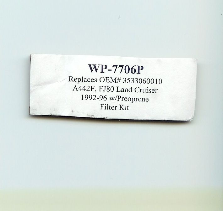

WORLDPAC Filter kit
I found an awesome aftermarket kit with a new filter and hard rubber gasket. It’s made by WORLDPAC and has an exact copy of the filter and the gasket is so much easier than messing with gasket maker. When you drop the pan with this gasket you won’t have to deal with the trouble of removing the liquid gasket seal which I found to be a PITA! I bought the kit from Napa for about $60.00 and it worked out great with no leaks at all.
George
My old local Toyota dealer stocked an aftermarket gasket for the tranny.
What is the filter, I thought the filter was just a screen?
Filter
The filter has a screen inside of it. It's impossible to properly clean it, it is easier to replace it.
George
