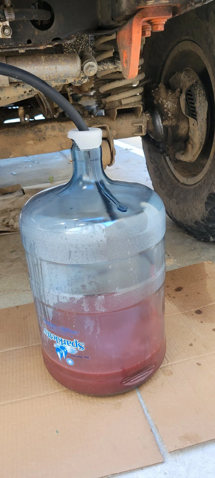

I have done the drain pan drain and then 4 QTs back in. (actually 5 and I had to siphon some fluid out). I think the tranny cooler on the JDM HDJ81 is on the bottom of the engine coolant radiator but I am not completely sure. I need to find the correct lines as well for the fluid exchange. Great thread.
Its called a Rodney Flush. Just recently did that to my tranny and it is running perfect. I just remove the bottom line to the tranny oil cooler fitting and let it drain away....fluid exchange plus flow test all in 1.
