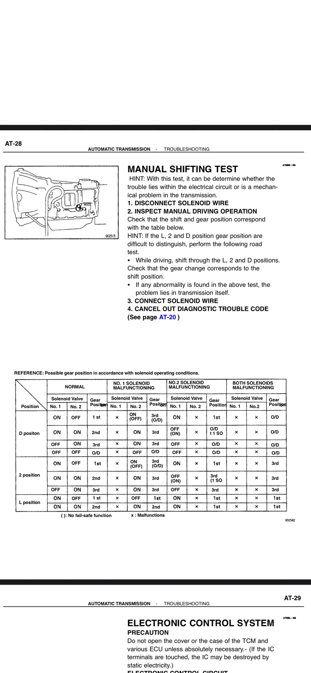

Try the manual shifting test. It will help determine if it’s the shift solenoids.

highly recommend you download the Toyota service manual (FSM). All of the testing procedures, adjustments, tolerances are contained within.
