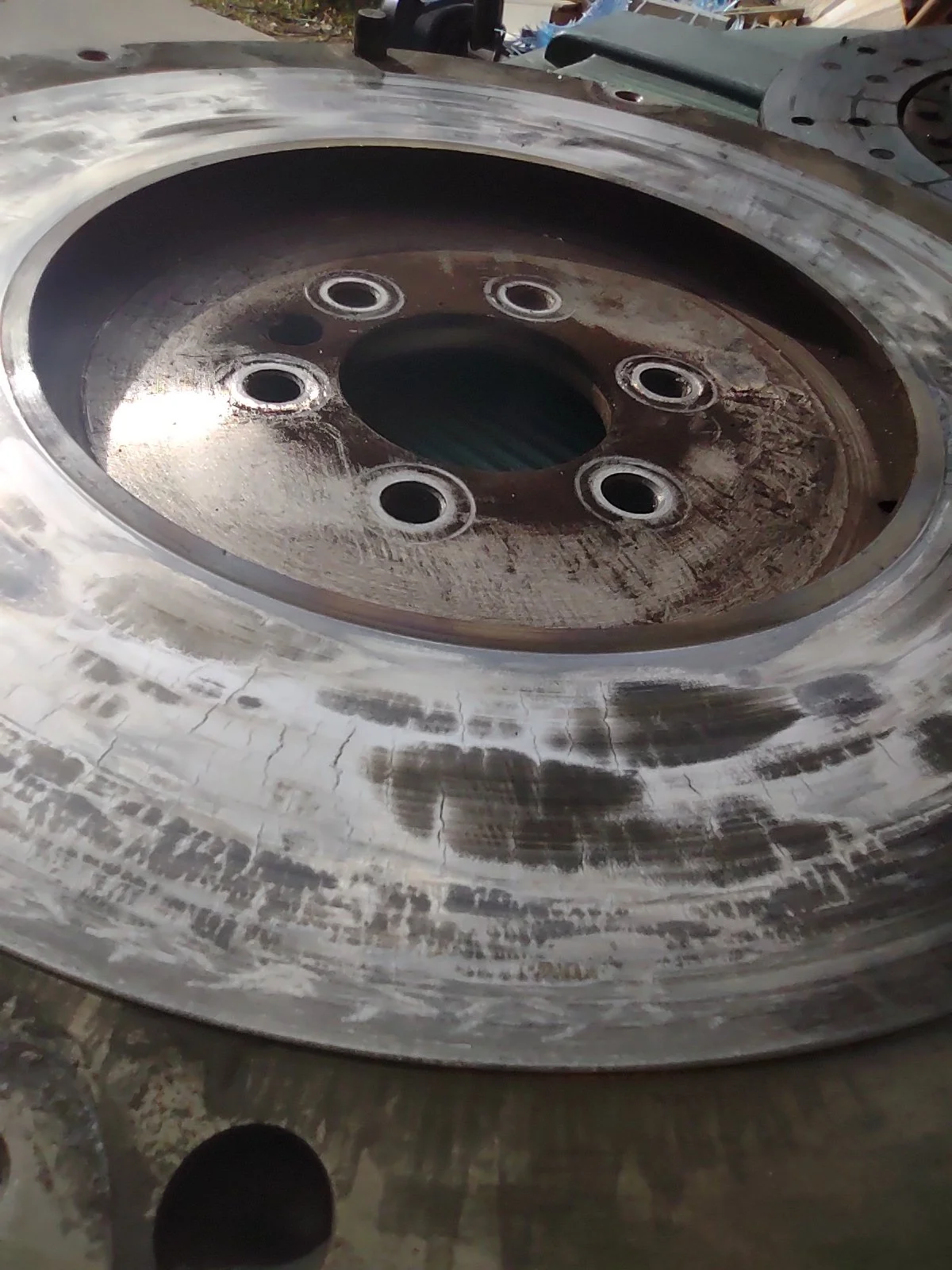

Well, that was easy. Supported the engine with a bottle jack and 2x4, set up the tranny jack, wiggled it back and it was out.
Now here is my dilemma. Nobody in Moab resurfaces flywheels. Second, look at those cracks!
PM me if interested. I'm heading to the Post Office this afternoon to mail a package to another MUD member.
You dont have an Oreilley near you do you? usually theres one in your town thats bigger than the other that serves as the hub for the smaller stores. If you find that shop theyll usually have a machine to resurface rotors and flywheels. Oreilley did my 22re flywheel some years back.

There isn’t an oreilly that has a lathe out there?
