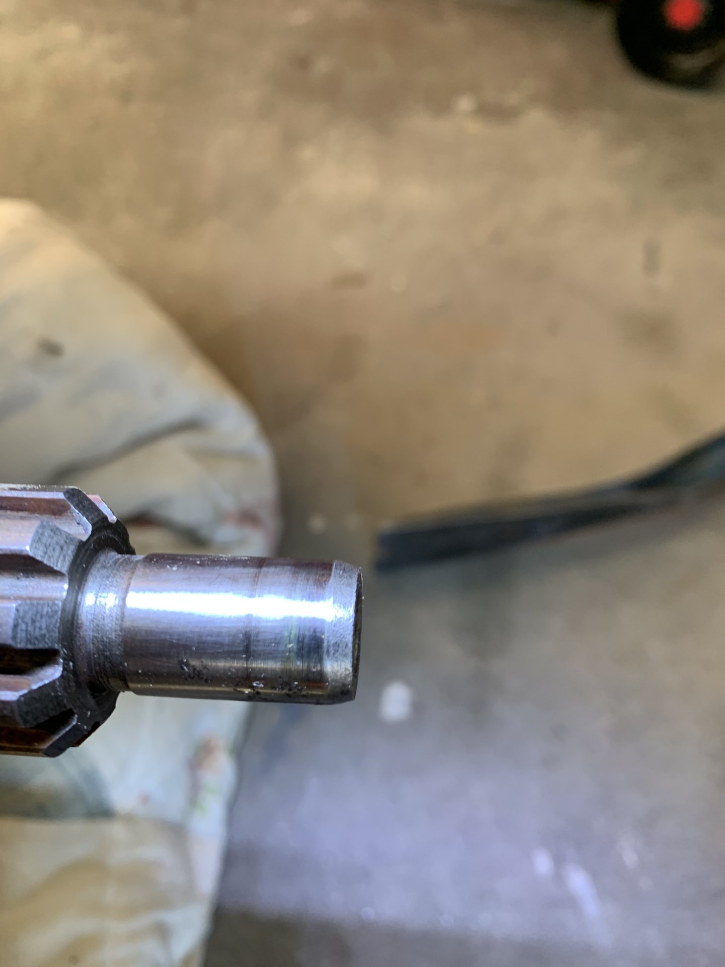

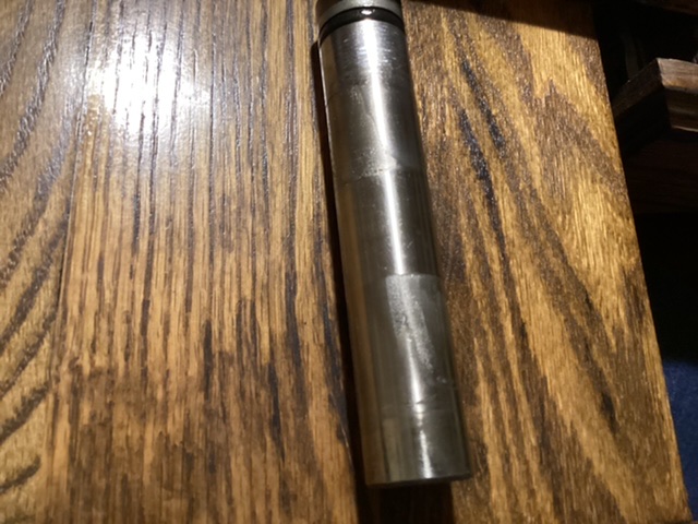

I got most of the t-case disassembled and cleaned a little while ago. It definitely was time to service.
Idler shaft cut thru the hard facing.

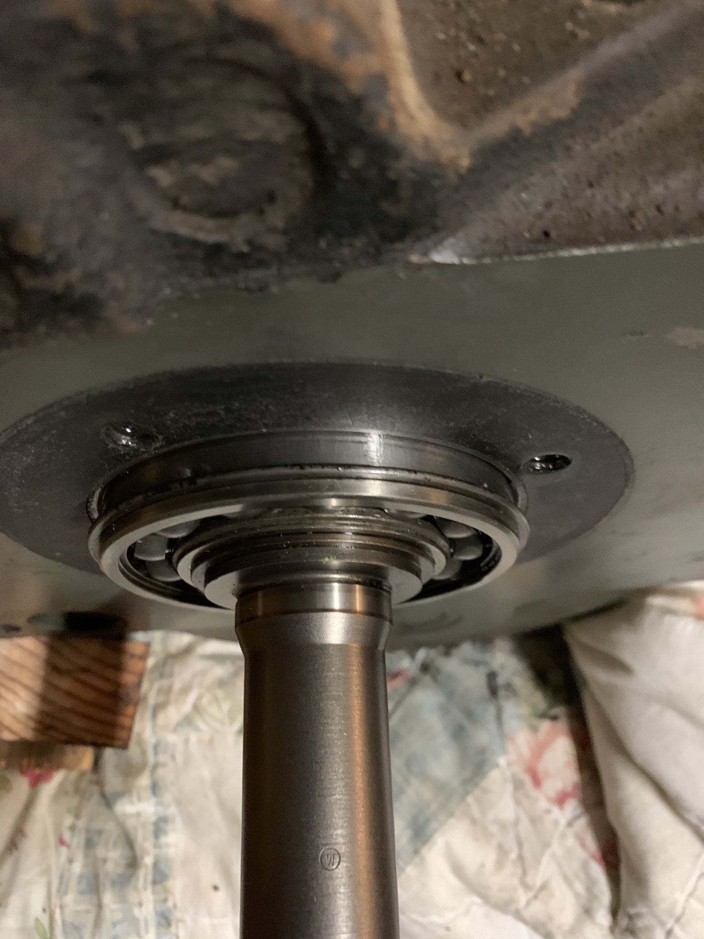

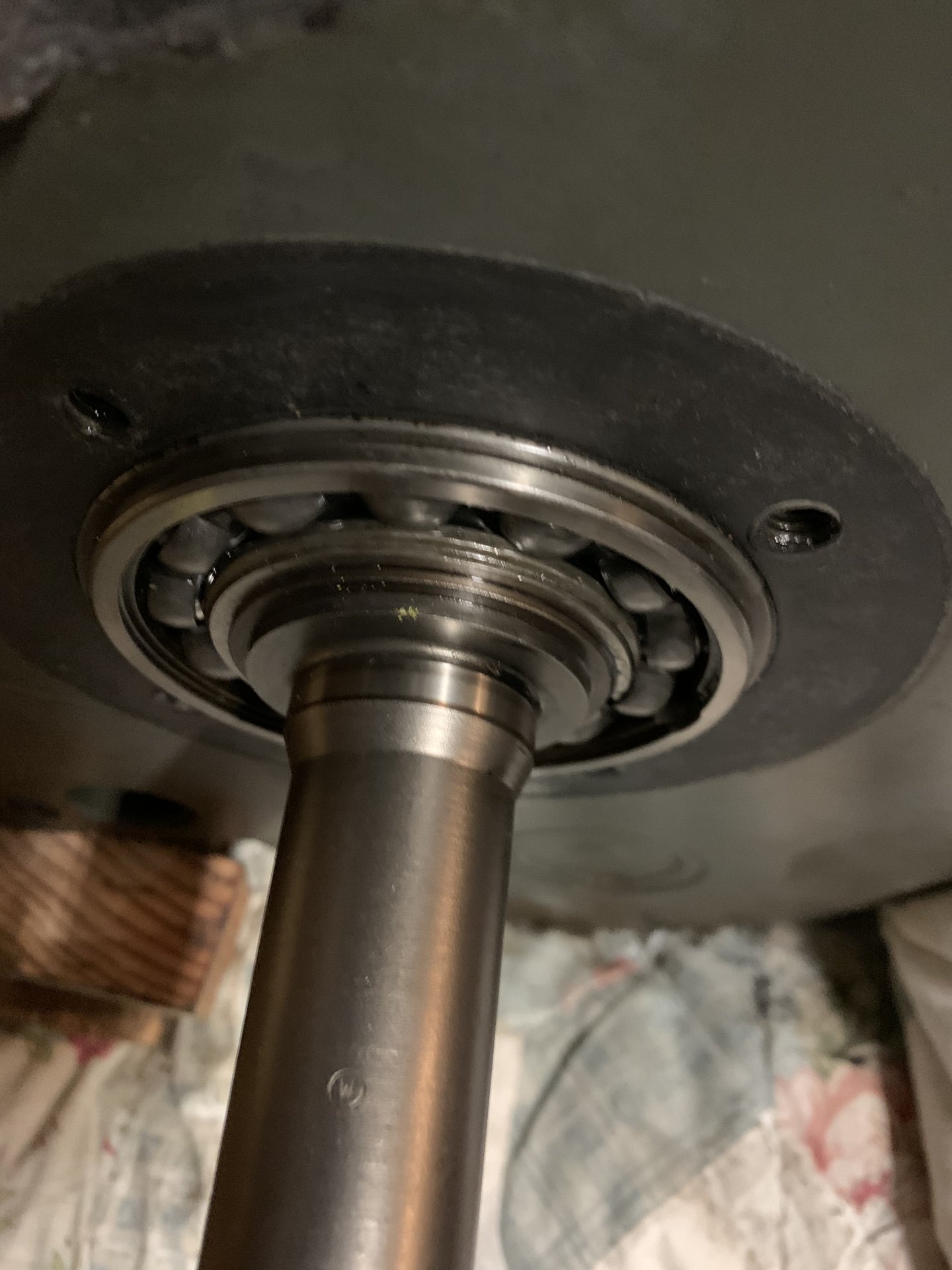

I’m referring to the Clutch Gear, output gear to the Clutch/engine. With the Clutch Bearing Retainer off, it pulls outward a half inch. See photos.
5) Is there risk of damage to the bearing when I’m reinstalling the retainer? I’m just wondering if that is why the retainer was on so weakly. Is there a way to check to make sure that I’m not going to stress the bearing?
Once you have the retainer off, you will understand the situation better. The bearing should have an external snapring which rests against the case. The retainer has a corresponding groove in it for the snap ring. DO THIS!!! Before you remove the retainer, note how much resistance it takes to spin the input shaft while the trans is in neutral. IF THERE IS MORE RESISTANCE when you reassemble, something is wrong. And that something will affect the ability to shift the trans properly.
Notice the photos above. The Snap Ring is 3/16 from the end of outside bearing flange. The Snap ring sits up flush to the case when the Clutch shaft is pushed all the way in. As you can see it pulls out about 1/4” then stops.
The Tranny seems to be neutral and both shafts turn easily without and noticeable play. The only thing I noted was the clutch gear pulling out 1/4”. Probably not an issue but I thought I would ask.
View attachment 2884702View attachment 2884703
