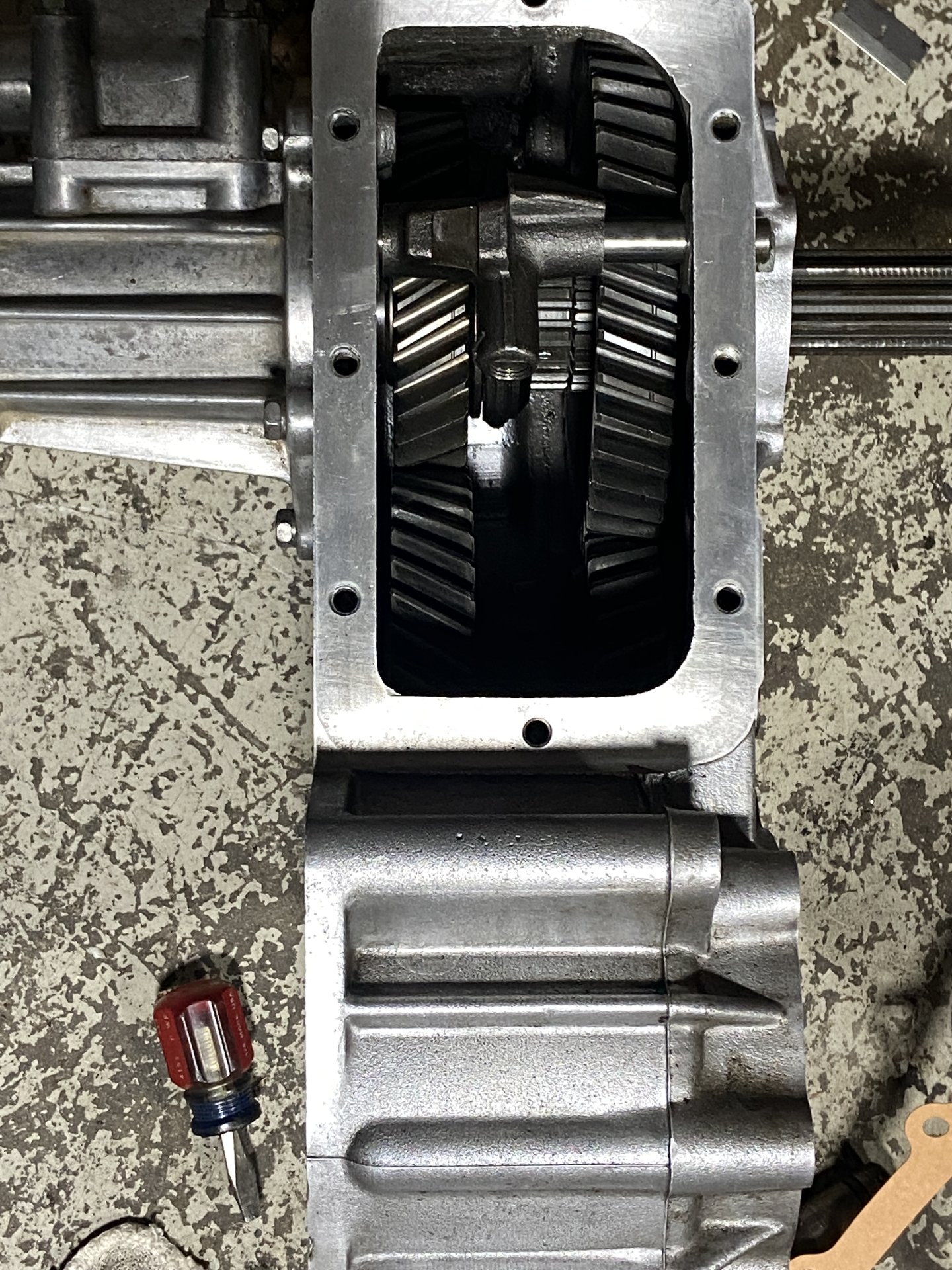

I bolted the Retainer on, dry, with original gasket. No movement on the clutch input shaft gear at all. How should I proceed now? The old gasket looks okay, but I doubt it will make a good seal if it's supposed to seal out oil. Should I use a thread sealant on the retainer mount bolts?

Why did you remove the bearing retainer? In the interest of clarity, let's stop calling it a clutch gear. It is a transmission input shaft.
When you say the input shaft doesn't move at all, does it still turn smoothly? If so, seal it and yes, the bolts too if the holes are open to the inside.
If the bushing is still round and mostly smooth, it is probably fine. You cannot be sure, however, unless you remove the clutch and put a centering tool in and seeing if it has too much clearance. It should fit, a close slip fit and turn smoothly.

Thanks for your feedback and comments. I appreciate it. Mark (65swb45) asked me to bolt the retainer on to see if it was holding the bearing and shaft without any movement. I was looking for guidance from him on whether I should replace the gasket (or do anything else in terms of sealant/FIPG). I appreciate your advice to use the sealant on the bolt threads.

1. Since you have a new gasket, use it.
2. Apply a very thin coat of sealant. My current preference is a grey RTV sometimes referred to as FIPG. For that particular gasket a contact cement would be ok too.
3. As @h82crash pointed out, it’s important to seal the bolts too, and the fipg is good for that.
