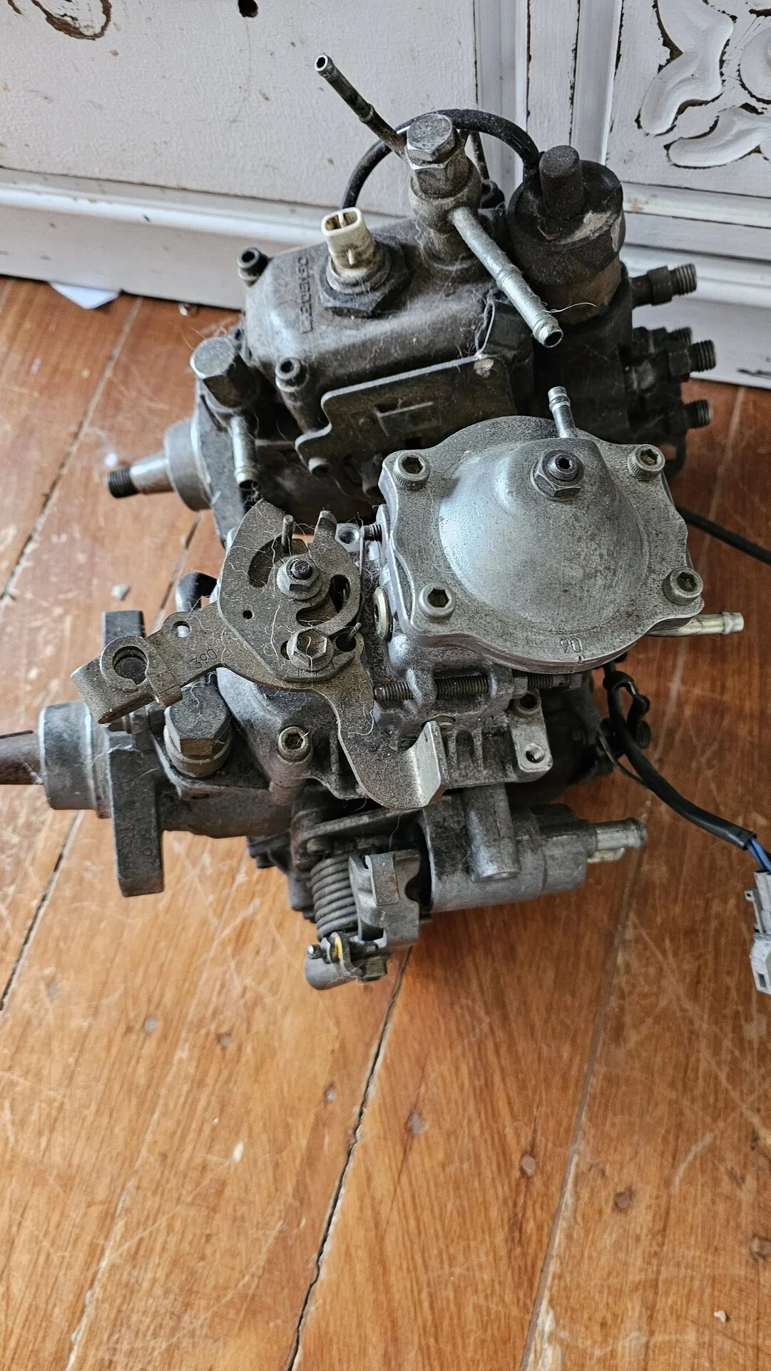

Many of the injection pumps on the 2LT-II mechanical injection engines (from Japan market) have a TPS already integrated on them to provide input to the EGR computer. Maybe you could find one of those? Or at least a parts diagram to see what you need for your mechanical pump?
I think the 2LT-II pump with TPS is 22100-5B280. Not a great picture of one, but this is how they look:

Thanks! I will have a go at tracking one down! The auto gear box step down wire still has me scratching my head.
I do now wish I had asked that question weeks ago! Thanks for the heads up on the pump!
