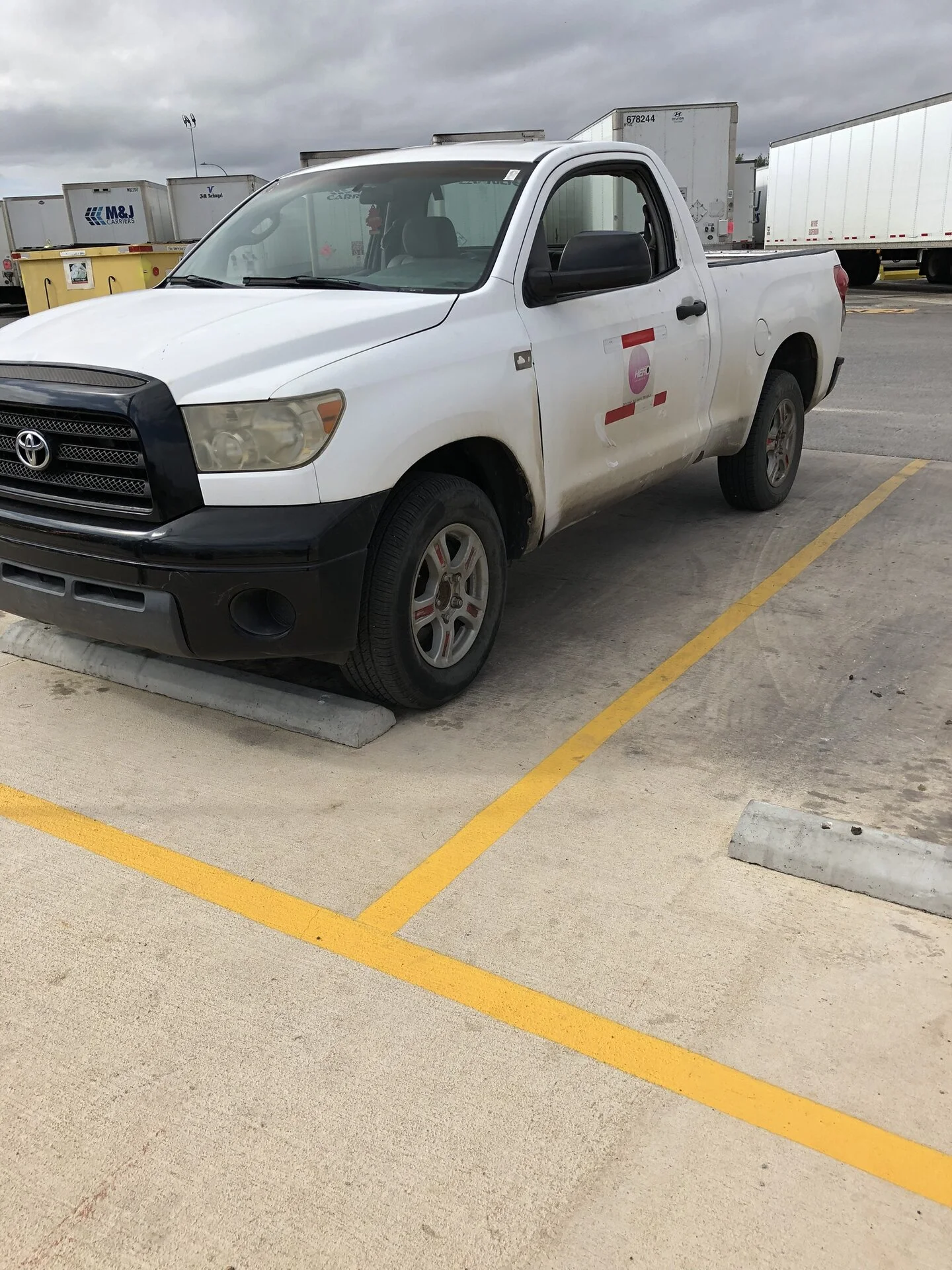

These were the best sized 2007+ Tundras. The regular cab with the 6.5” bed.
I owned one with the 5.7 and it was a beast.
Photo below is of one at the Tundra plant. Been used for heavy duty since 2007. Even has roll up crank windows too.
