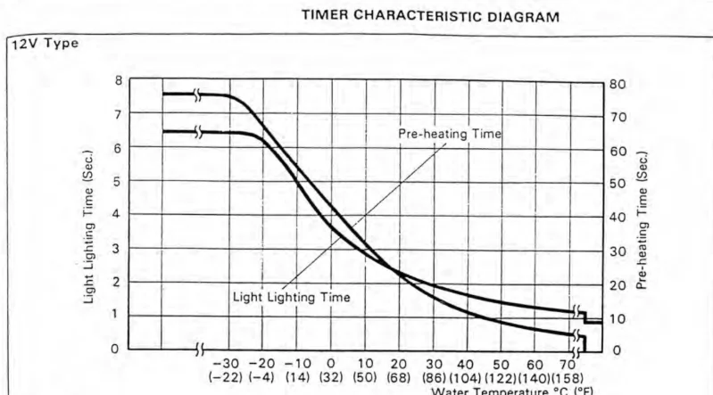

What was temp outside when starting? On a warm summer day it probably should start slightly better than that... but not a lot. This is life with an old diesel... they are hard to start, smoke on cold starts, and make the neighbours nervous. This is just what it is. This will never start as simple, smooth and clean as a modern vehicle. ever.

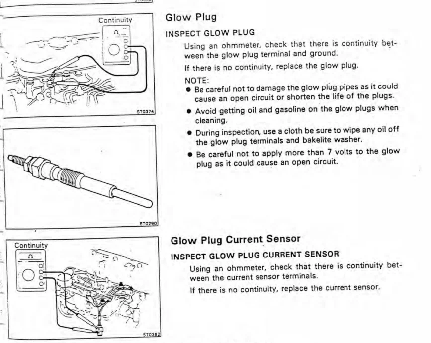

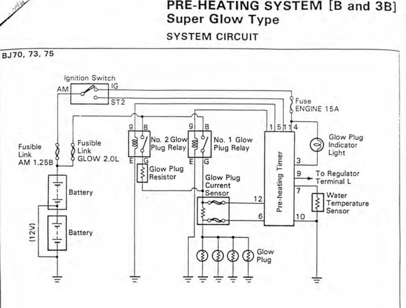

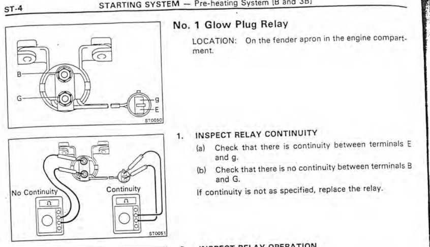

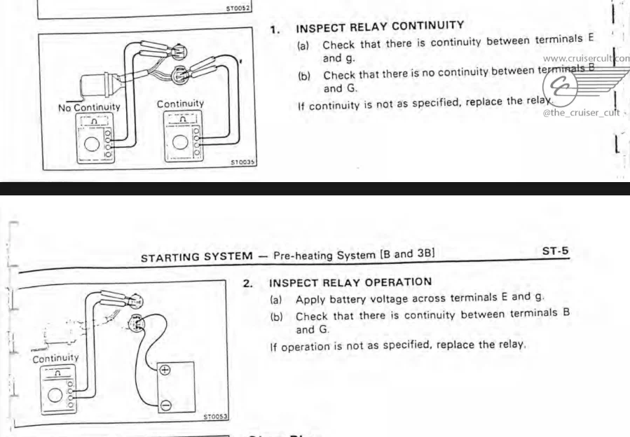

A few things to check... make sure your glow plug system is healthy:
1. check glow Relays... there is a big glow relay on the port side fender... it should click on/off when the glow plug lights are on.
2. Test for voltate at the glow plugs immediately after turning the key. Should start at 12ish volts briefly, then drop to about 8, then to zero when they time out. Time of glow is based on engine temp... there is a dedicated temp sensor in the thermostat housing just for timing the glow plug cycle. There is a chart in the FSM how long each stage should run based on ambient temp.
3. No voltage? Check fusable links. I think the glow plugs 'fuse' through fusable link at the 12V battery terminal.
4. Test each glow plug... there should be a certain amount of resistance through them. Too much/little, it is burnt out and needs to be replaced. replace them all if one is bad.
BUT>>>>>>
overall... seriously, this is kind of just how they work. Some start better than that, but it does start after just a few cranks <- that's a win. The direct injected variants (like the 12Ht and the 13BT) are excellent at starting, and they spring to life, but the indirect injected diesels like the 3B... this is just how they work. it will never not smoke on a cold start. Remember, modern diesels are 5 generations newer than this. The 3B represents really the most basic of 2nd generation of commercially produced diesels. That engine was engineered in the 1970's. Smoking was very popular back then, even for engines. I would run those tests I suggested, and if they pass, then you got nothing to worry about. Just enjoy that vintage technology.

Thanks for the tip!
I have those PDF manuals — @Felde sent them to me. I'm actually going through them right now, really interesting stuff.
I'll definitely start by checking the glow plug system — seems like the most logical first step.
