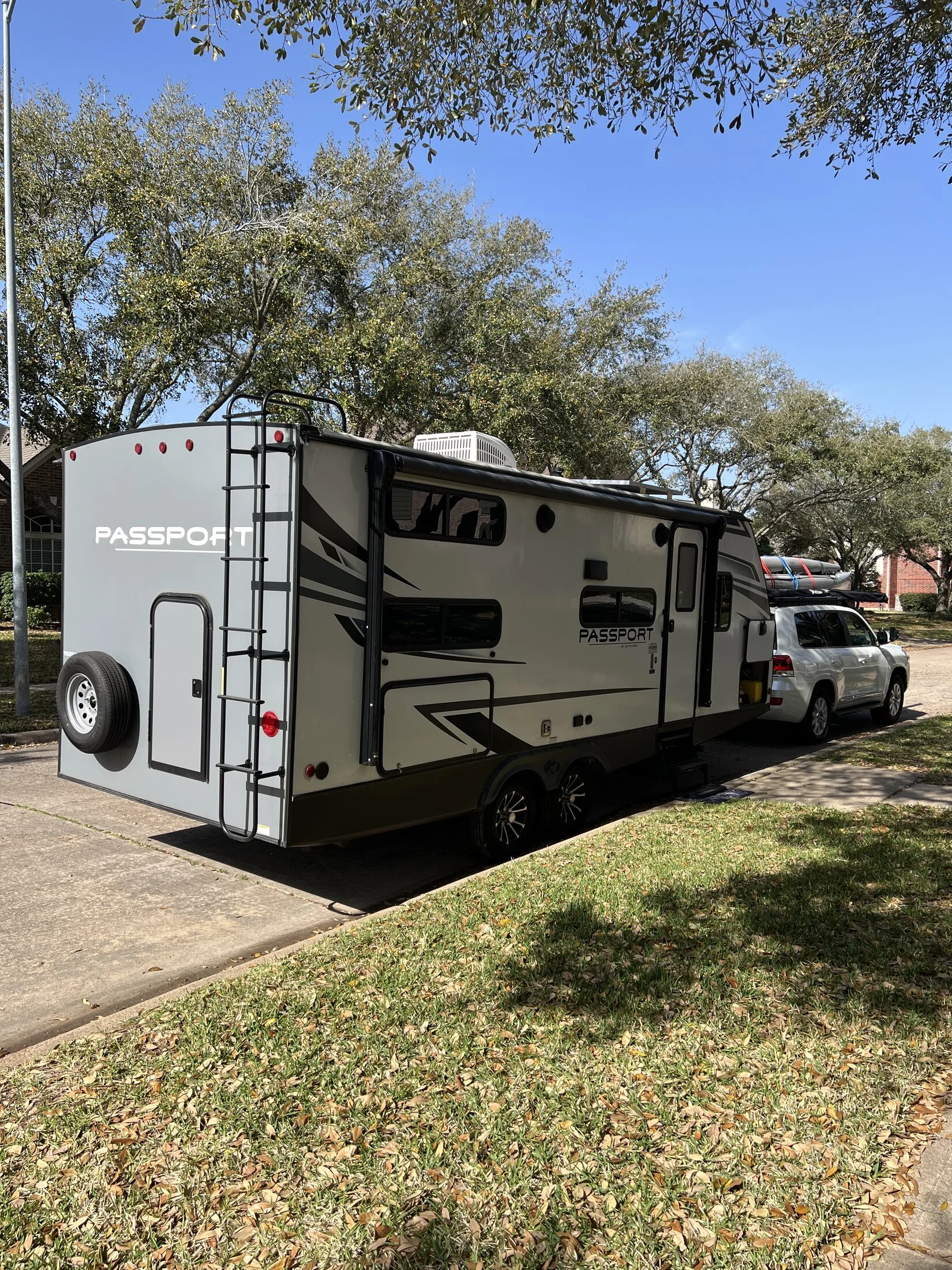

Towing with a 200-series Toyota Land Cruiser
You can certainly get away without using a WDH, just as you can get away without using countless other safety-enhancing features. But in an emergency situation, you'll want the odds stacked in your favour.
Europe and Australia are not directly comparable to North America. They have much lower speed limits (especially when towing) and they have trailers that are frequently designed differently (for example, axles shifted further forward to lower tongue weight, utilizing surge brakes, etc.).
For what it's worth, my Andersen WDH hitch does not affect maneuvering in any way whatsoever.
I knew we would not agree. Enjoy your WDH.
For good order Europeans were wearing seat belts front and rear and by law sooner than in most if not all US states. Also ABS was introduced there by Mercedes on the S class. I would not want to do without either. A WDH is useful for longer combinations but not for what I have.
Hey I noticed that too! I like them a lot as well.
But I worried that the holding clamps might possibly vibrate loose.
So I made a bracket-hook that hooks under the rear view mirror and is secured with 2 sizes of zip ties for a fool-proof securing of the mirror.
The hook is made from metal strapping & cushioned with gasket material that I had laying around.
When I'm done towing I just snip the narrower zip tie.
The mirror cannot come loose.

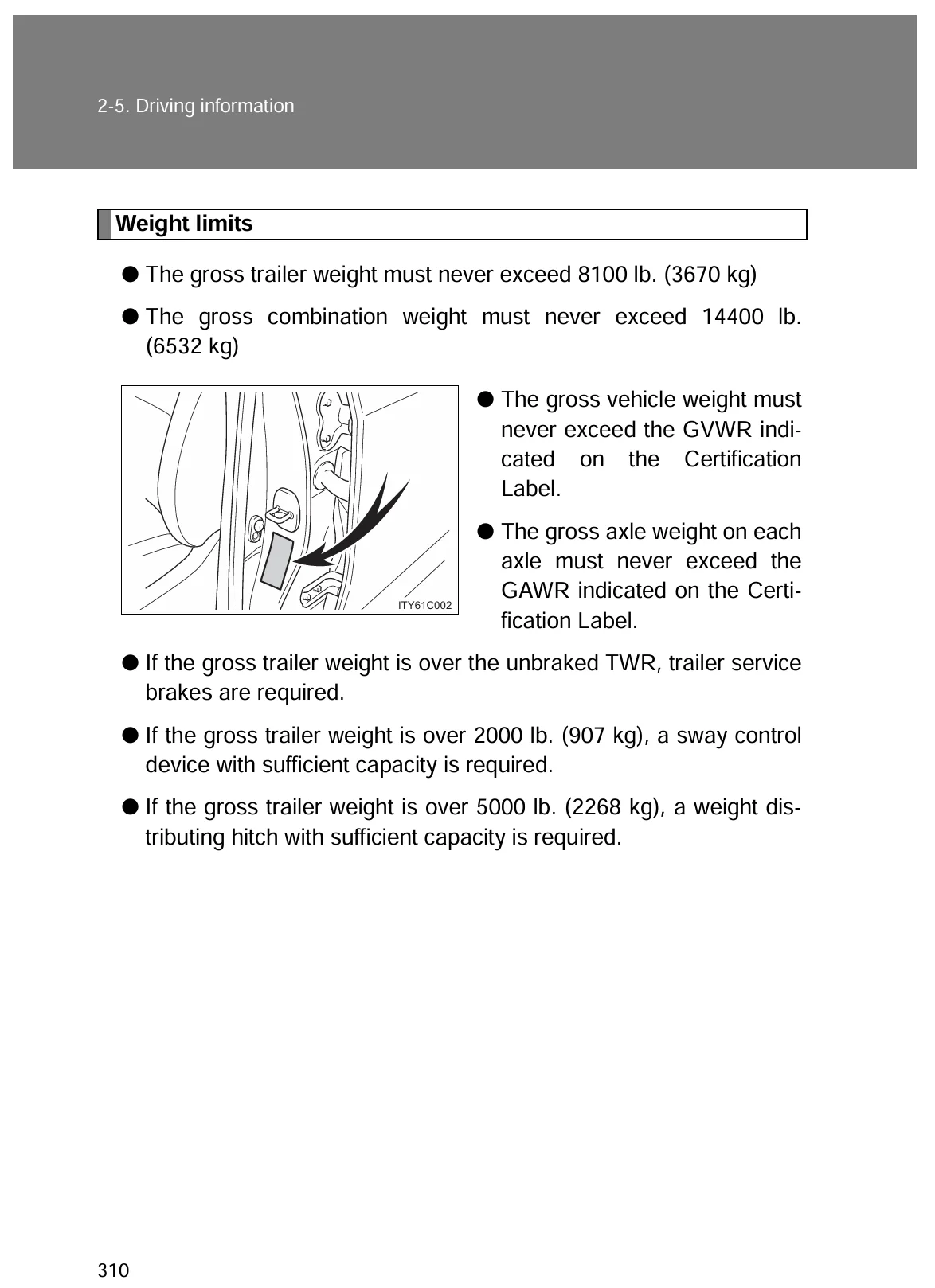

Aren't the guidelines in the Owner's Manual clear enough? Or are they incorrect?
From my 2013 LC200 Manual:
Written by Americans from Toyota US
They are very clear. And they are basically identical to the instructions in the owners manual of every BOF SUV, and every half ton pickup, of every auto manufacturer. And you can go to every boat ramp in Florida, with boats in excess of 10K lbs being launched, and you are unlikely to find anyone who has a WDH. Especially on any SUV pulling 8300lb or less (Land Cruiser rating range). Most of them will have no trailer brakes, or at best surge brakes, which won’t work right with a WDH. Many will have surge brakes that are rusted and not functional.
I’m not defending this as best practice. I am saying it has always been this way, since before anyone ever heard of a WDH.
