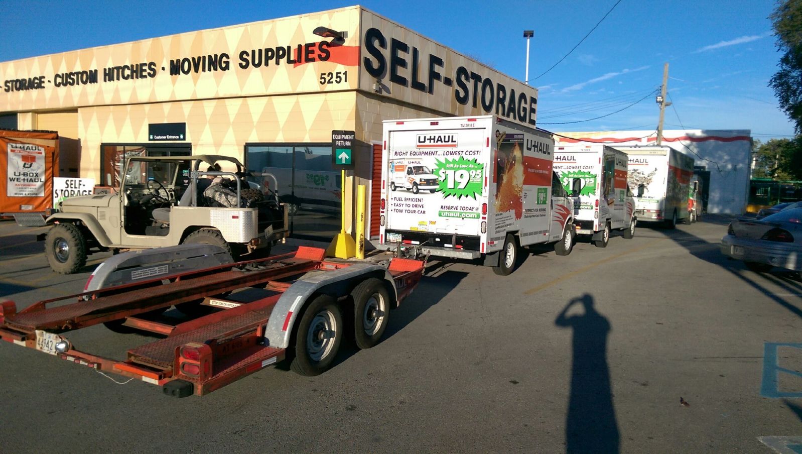

We flew into Phoenix, grabbed a Uhaul in Tuscon, drove down to Elgin, grabbed the cruiser, and headed back up to Flagstaff in day 1. Totally kicking myself now, didn't even get a single picture at John's place. I know I was too thrilled to be back in the possession of an FJ40 and overwhelmed with John's fleet (amazing 80 with pretty much everything you could need from the sahara to the hammers, two FJ40s, a Tacoma, a 100...all armored out and in various levels of build), I don't know what Brittany's excuse is :hmm:! Actually, Brittany did get a pic of my s***-eating grin on the test drive:
Here it is in tow shortly after picking up:

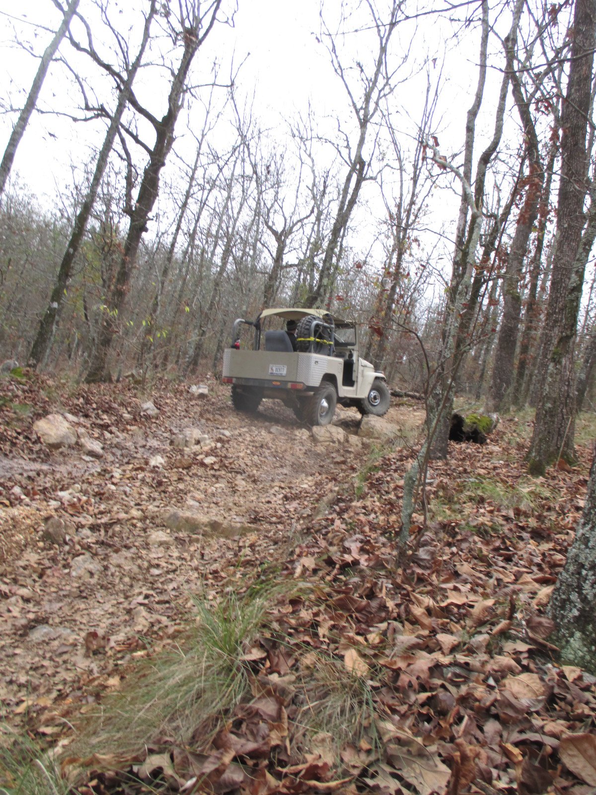

So about a month ago we went to the Badlands, quickly discovered that prior to being concerned about getting the front and rear locked I need to be concerned about getting some rocker protection for it.
Brittany got a few action shots:
I was very impressed with how point-and-shoot it was...biggest hindrance was certainly clearance and my lack of interest in bashing the hell out of the rockers and steps. It will definitely go anywhere I need it to at this ride height/level of body armor.

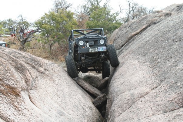

Unfortunately despite my concern for the rockers I managed to eye up a climb that led to what I'll call a combo of el Caballo and myself running out of talent; got to the top after threading the needle between two trees, didn't quite make the crest and slid down hooking the windshield frame:
The windshield frame is salvageable...the glass not so much. Also going to have to piece together the left hand dash-to-frame knob assembly too. Needless to say I was unhappy with myself, but didn't let that slow down the fun for the day-these things can be fixed!

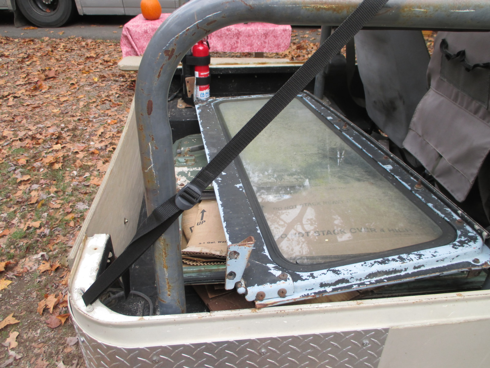

Went to pick up the doors and believe it or not, Keith (sold doors to us) had a windshield and frame for me as well!:

NOTHING! The only thing we had to Macgyver was the windshield for fear it wouldn't sustain 75mph speeds...absolutely in awe at how great a rig this is. Can't wait to now take the downtime over winter to give it a proper once-over and refresh of oils if nothing else! As a sidenote to this...I actually had to use the cruiser to jump my other fun (and apparently less-reliable, cracked me up) vehicle because I'd left it sitting so long while driving the 40!:
So now on the short list of projects is getting the glass in, a complete refurb of the doors I picked up (they definitely need work [full rebuild]), gauge cluster rebuild/dash refurb, install of new seats (currently en route via Fastenal), and install of a Metal Tech half cage. Can't wait to get to it!

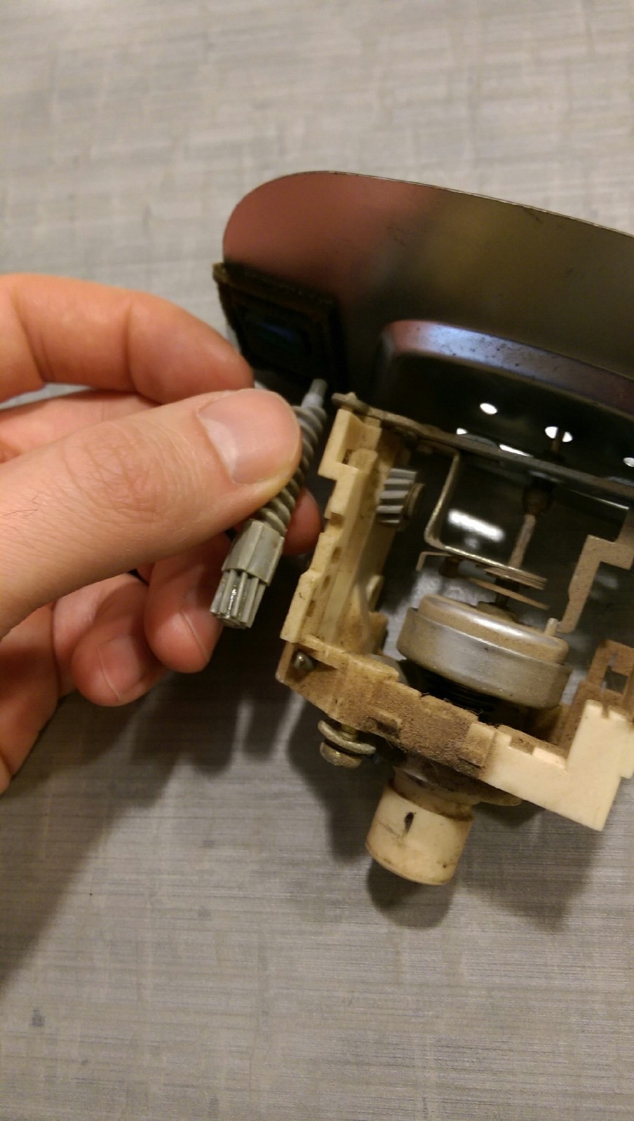

Been a long time since I've updated this thread....have made slow but steady progress I'd say. First thing I went about doing while it sat in the garage was fixing the odometer. Unfortunately that proved to be a non-starter, upon disassembly I found one of the worm gears that runs it to be missing one of the pins that locates it:

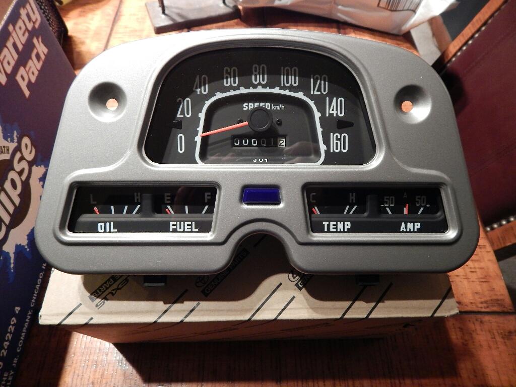

I had some thoughts about trying to drill the gear and add a dowel, but because I have too many other projects going I opted to buy a NOS cluster from 96Newf:

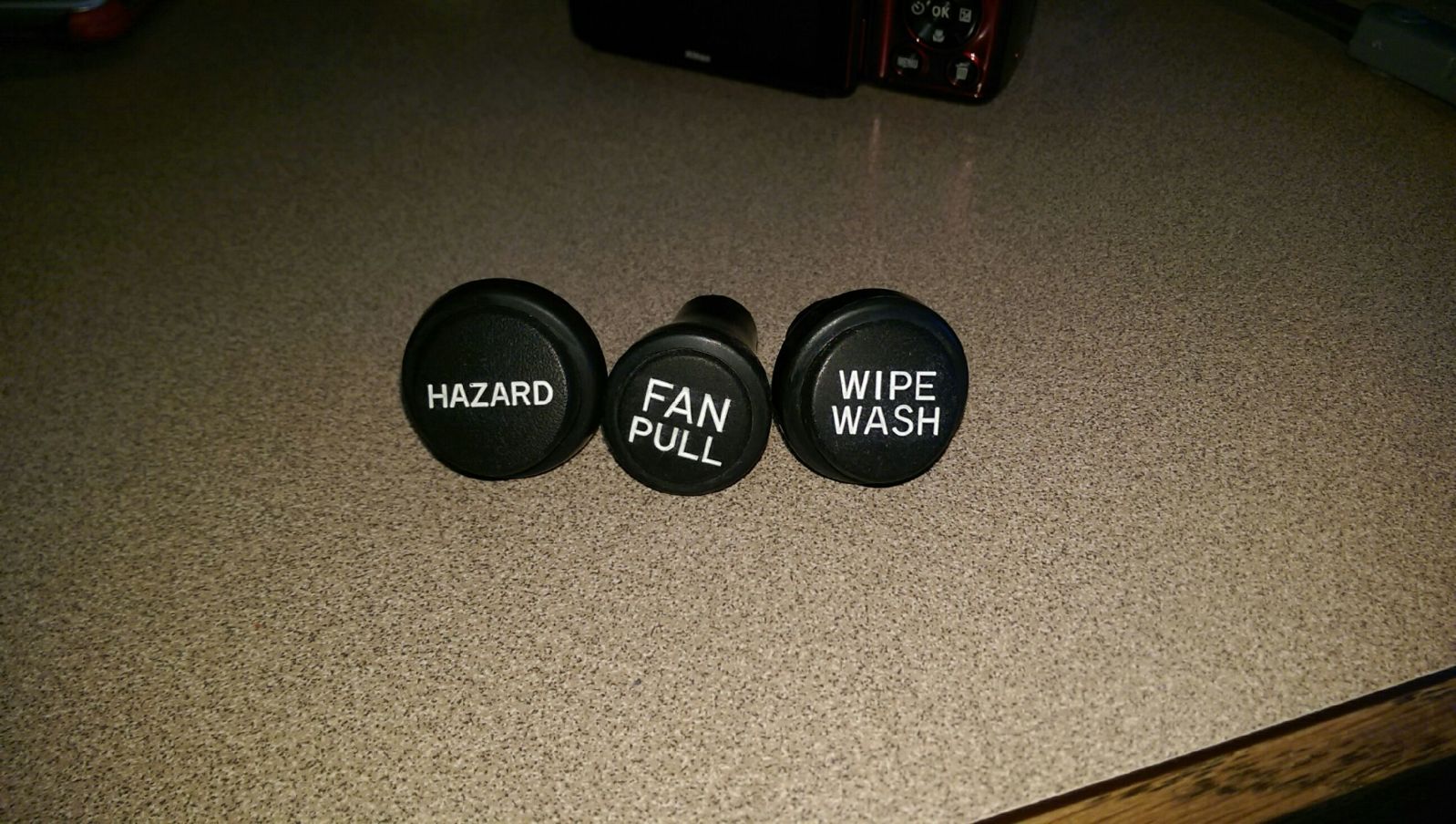

It looks amazing, and is right at home with the dash post-refurb (following). Because I bought that, I have a cluster that has seen better days (looks suspiciously like it lived the last 30+ years in the desert...), but aside from the odometer and the temp (which I can't account for because it was disconnected) is fully functional. If anyone could use it for parts let me know I'd be happy to box it up and send it your way:
In addition to the cluster I did the typical knob refurb with some simple green and nail polish (is hazard supposed to be red?):

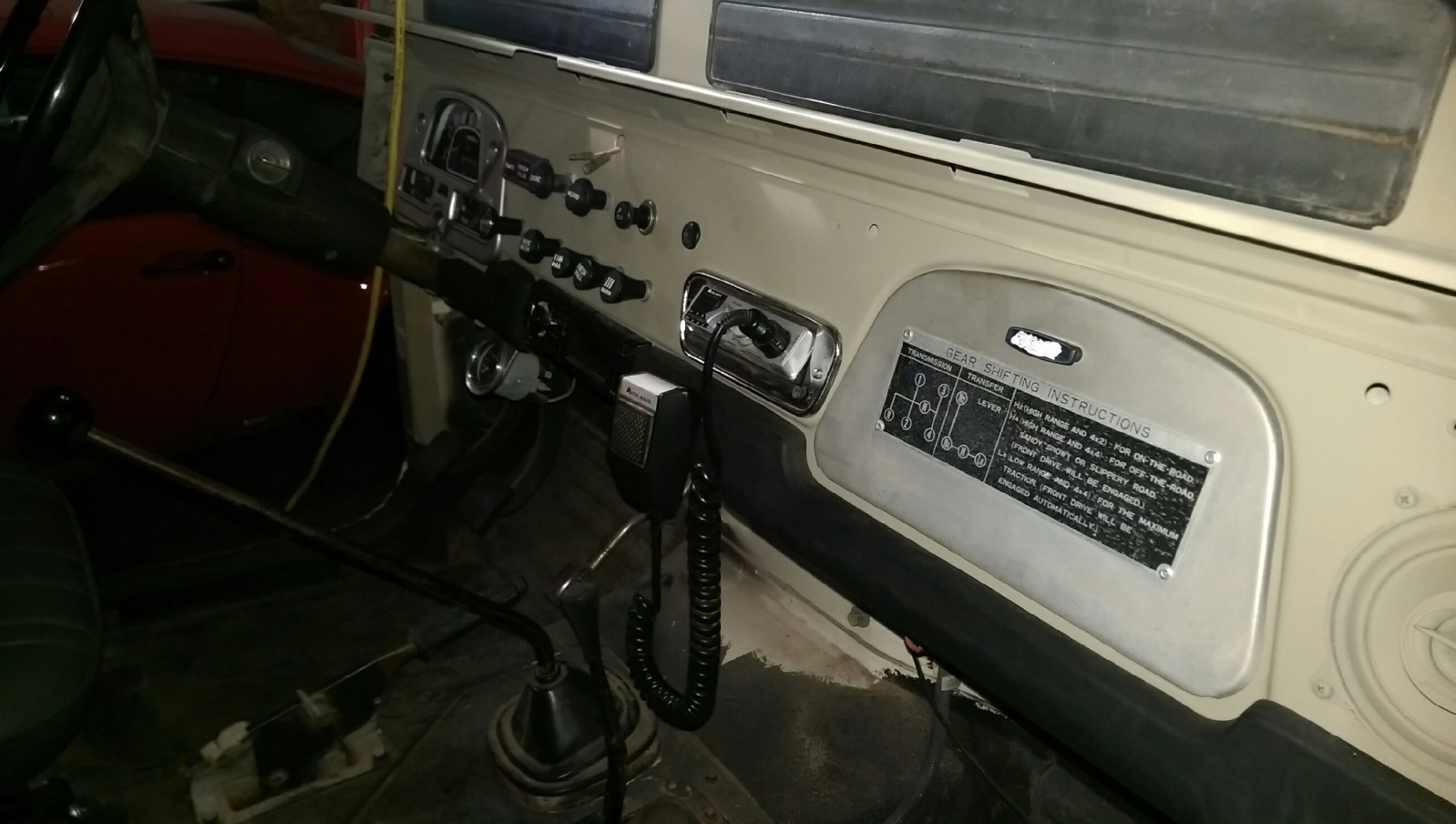

Also installed the ashtray-mounted cb and painted the dash tan (it was previously still it's factory white). I somewhat begrudgingly (as there are much better ways to communicate) installed the cb to fill the hole in the dash, but it looks too at home so I ordered a firestik and coax and am waiting on that. I actually painted the speakers when I painted the dash as well, I figured I wouldn't be hurting the audio quality enough to matter and think it turned out pretty cool:
Second is a pretty bad pic and is before I finished up the glovebox knob, but shows the cb mounting better:
I'm really pleased with how much the dash actually cleaned up...I need to get an upper dash pad to round it out.

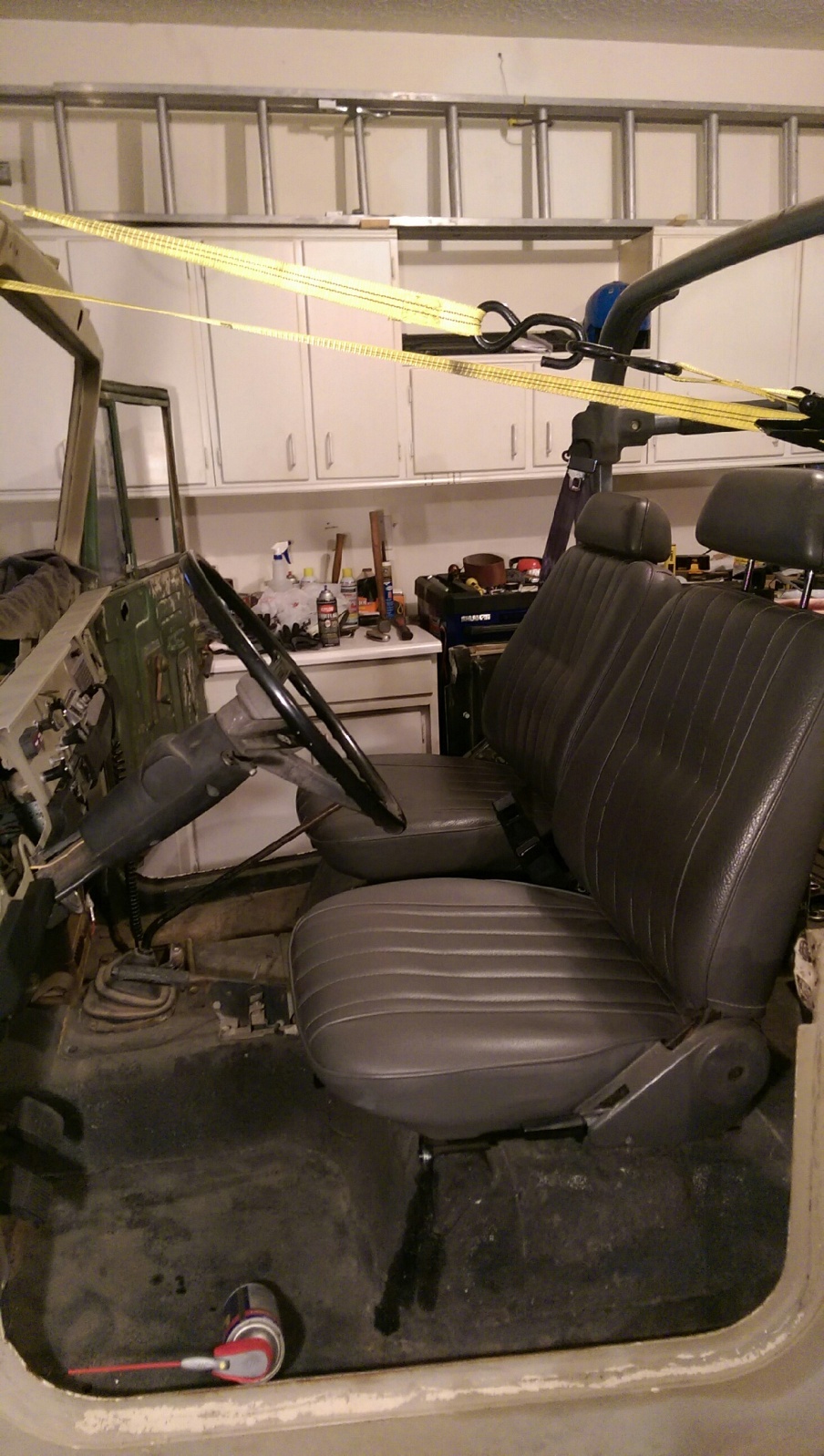

My seats finally also showed up, so installed them with new belts from specter. Don't mind the ratchet strap bending the windshield frame back so glass could be reinstalled!:
I am very very pleased with the seats...feels much more proper and puts occupants probably 6" lower, should be much safer and allow Brittany to actually reach the floorboard! I do have one question with respect to factory seats...what dictates whether they have a sheetmetal back or not? I thought it was a year thing, but I swear I've seen 79+ with the sheetmetal seatback. That's one thing I would like these seats to have which they do not, I think they look cooler plus are quite functional with respect to mounting things.

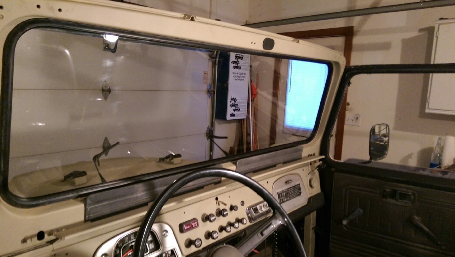

Shortly after getting the seats in I finally fit a new windshield...I got the windshield frame 'tweak' down to about 1/8" so I opted to not use one of the others I've picked up in my now two parts hauls (more on that in my next post):
Must say, despite the glass being a flat pane and fairly straightforward to install, I am pretty happy to have it in. Between this and the 911 (which still isn't really sorted as the lexan rear isn't an awesome fit) I am fxxxing over glass installs.

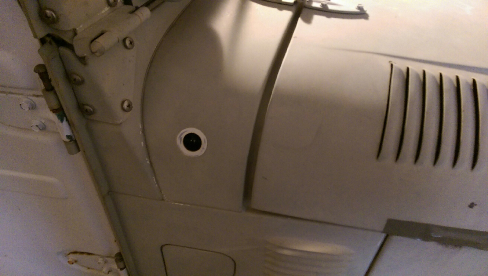

In getting things tidied up this hole has been bothering me more and more, does anyone have a good source for a plug or something to fill it in? Is it for a factory antenna? I almost remember the same hole bothering me on my 78...I think I just resorted to using a bolt and fender washer to plug it:

@orange45 was collecting cluster parts for rehabilitation of complete clusters.
Nice work on the 40, keep the updates coming.
Curious about the windshield - when you tweaked the frame to within 1/8", what did you do, and why was that necessary?
Cool I'll have to see if orange45 is still looking for clusters. The windshield frame issue was caused by me threading the needle between two trees on a climb at the badlands, then failing to make the climb and sliding back down and hooking one of the trees on the way. You can see in this pic the frame is too upright:
Oh and to fix the frame (I think this is what you were originally asking after rereading) I just pulled the glass, wrapped a ratchet strap around the most whack corner and tightened it beyond where it originally should have been. This allowed it to spring back to being basically flat/square. The passenger side was fine as it was, I actually pushed forward by hand on that corner (while the ratchet strap was hooked to the other corner) to help massage it all into place.
Mine's bowed 1/8" in the middle of the top of the frame, so I've got it clamped in the opposite direction to get it straightened. I don't know how much flex a new w/s gasket would give between the glass and frame as is, so I'm gonna keep tweaking until it's straight. Ratchet strap probably would be faster, but pipe clamps are what I've got, so clamps it is.
