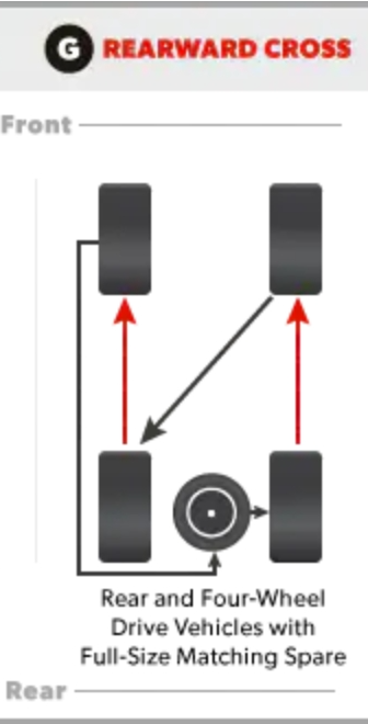

I also rotate all 5 tires every 5,000 miles using the Rearward Cross protocol recommended by Tire Rack:
This not only evens out Front/Rear and Left/Right wear patterns for all tires, but assures that my spare is the same diameter as the other 4 and ready for use if needed.
