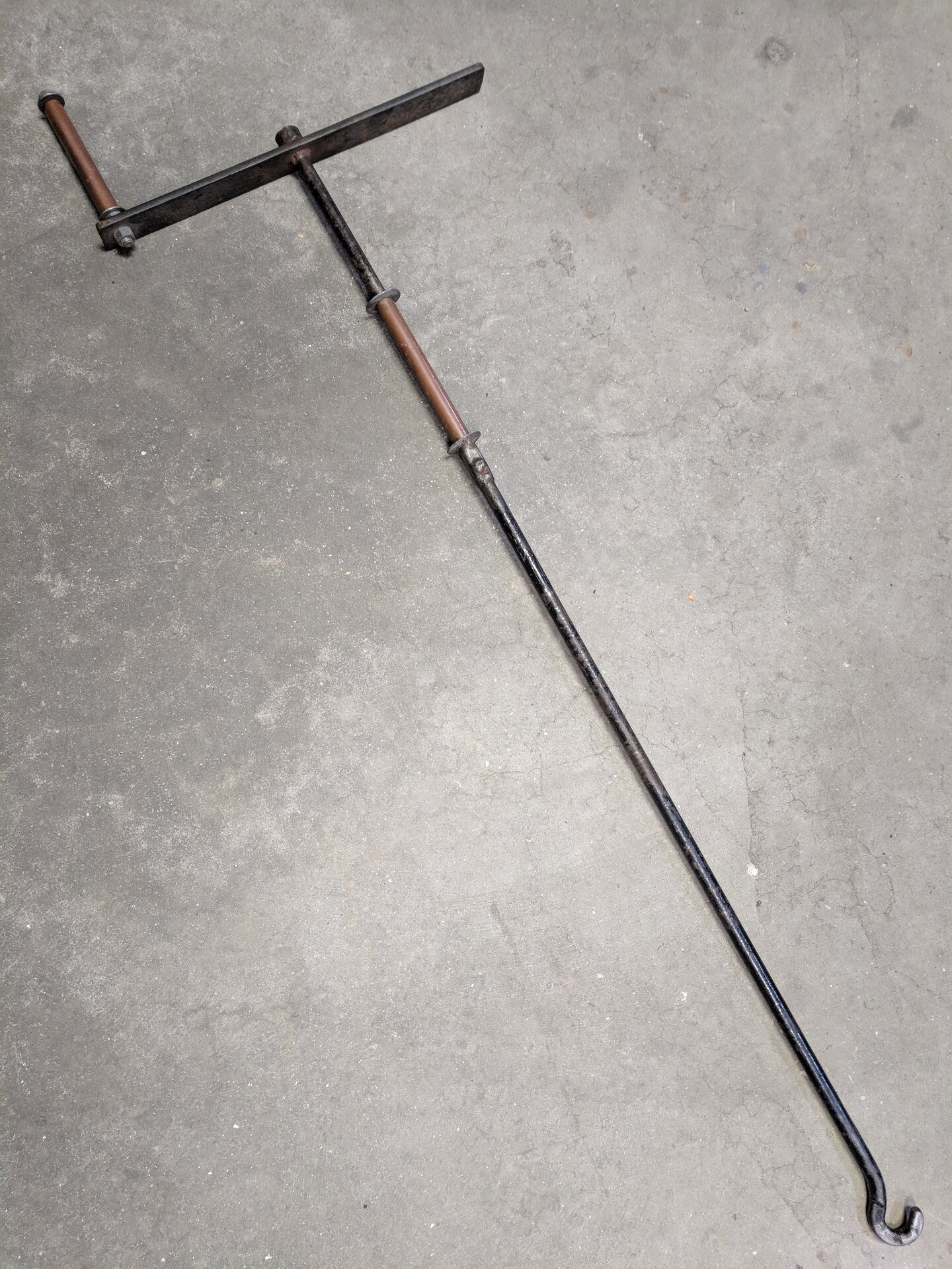

Lowering the spare with that janky crank provided in the kit kinda sucks. So I made my own crank, it hangs in the garage right at the spot where I need it for dropping the spare, during every oil change.
(That is on old photo of my crank, I've since modified it to remove the hook at the end and converted it to the little cross pin that the newer winches use)

What'd ya use to cobble this together? I'm debating going to the junkyard and pulling the pieces from a jack/setup from something to make one, per the same idea of not pulling the one from the kit out
I started with the rod and extension from a mini truck jack kit, out of a truck I parted out. I welded those together at the joint, then the rest is various washers and a bolt, a piece of flat bar stock, and a couple of pieces of copper pipe. The copper pipe pieces are free to spin between the washers that are tacked into place.
The older hook end doesn't work with the tire winch in the Cruisers, so I cut that off, drilled an undersized hole in the end, then pressed a long 1/4-20 Grade 8 bolt through the hole, which I then cut the head and threaded end off. Works great.
(factory tool on the left, mine on the right)
