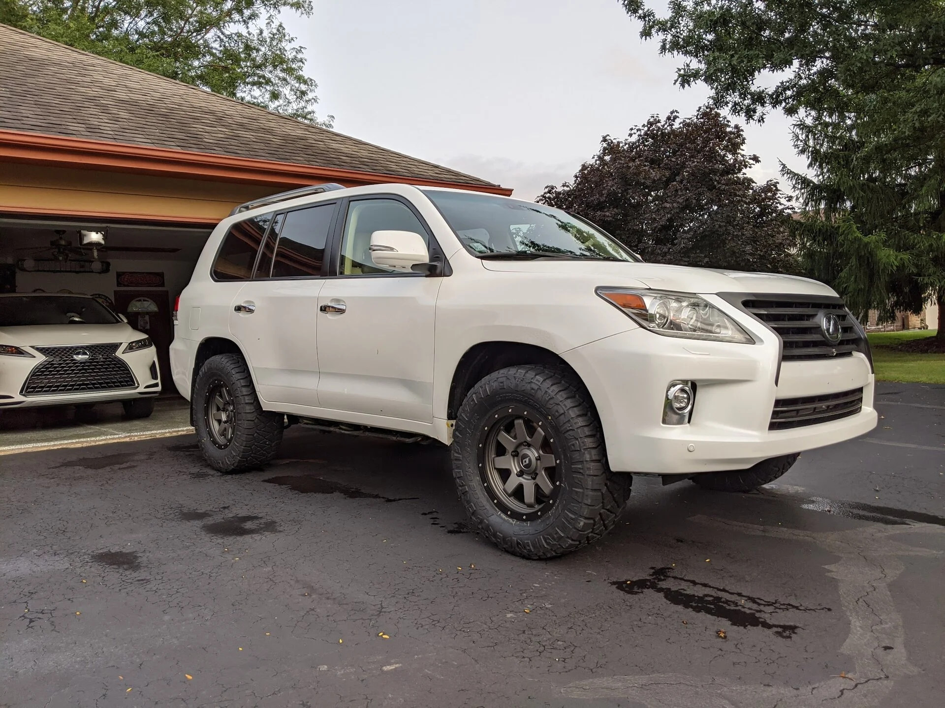

These are a Nitto Ridge Grappler in 325/60r18 with SCS 18 x 9 +25
Had to do minor clearancing, only plastic work so far.

You said you performed some typical plastic work and nothing else. Did you sensor lift or adjust AHC at all? And if yes, how much? And if yes, did it change any of the driving dynamics (sharper quicker turning or less/more stable at speeds?).
