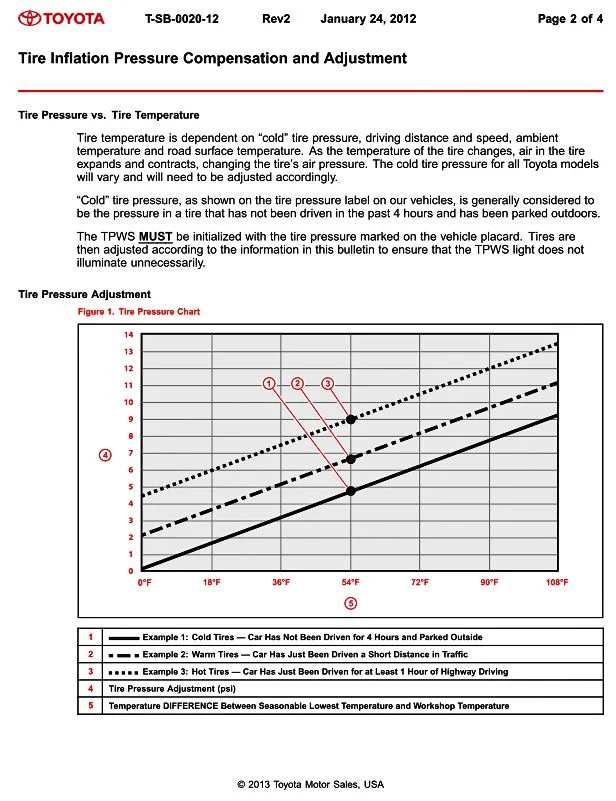

"Cold" tire pressure is generally considered to be the pressure in a tire that has not been driven in the past 4 hours and has been parked outdoors.

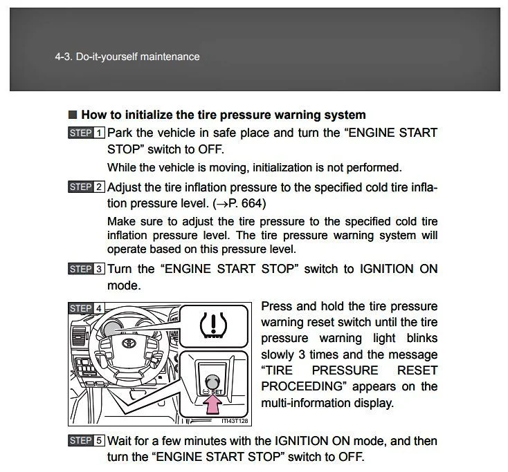

Also, don't forget to initialize your TPWS (Tire Pressure Warning System) to the new 42psi - otherwise, your TPWS will not warn you appropriately.
You might find the following docs from Toyota helpful:
NOTE: The TPWS initialization procedure posted here is for a 2013 LC - you should check your Owner's Manual to make sure it is the same for your 2021 LC.

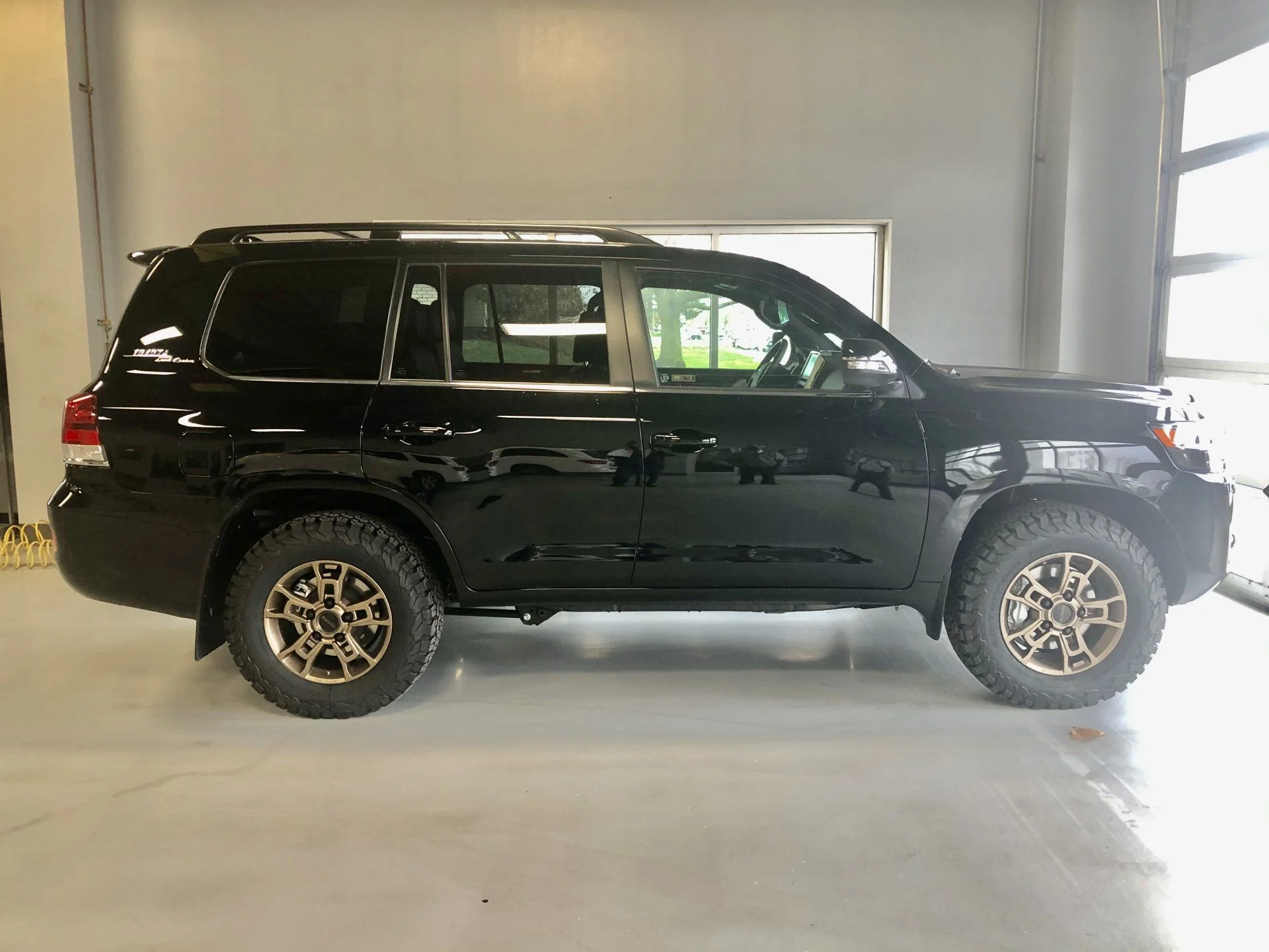

Spacers installed and 285/65/18 at 42 psi.
Yes, the RCTIP for an LC200 is different.
