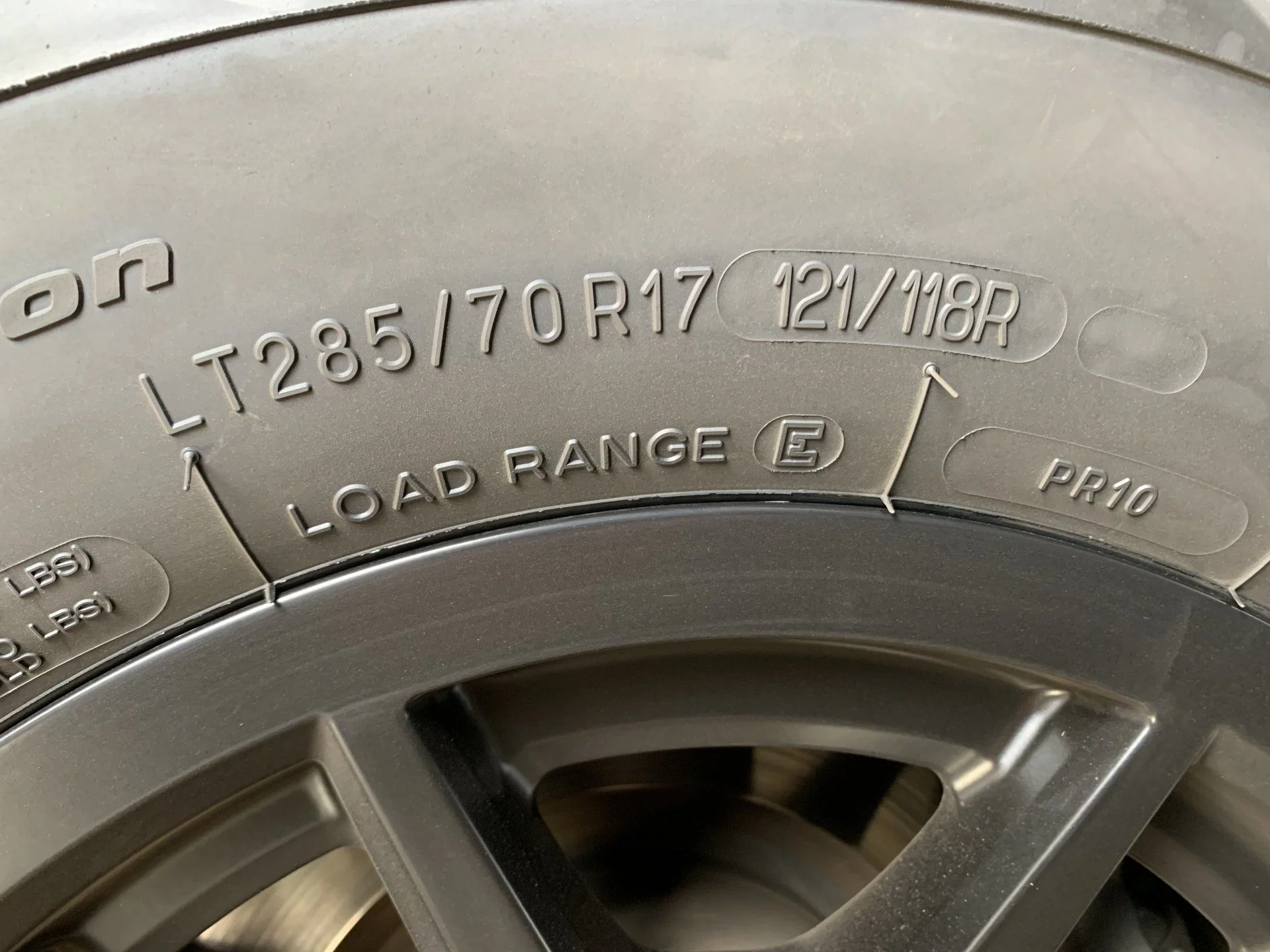

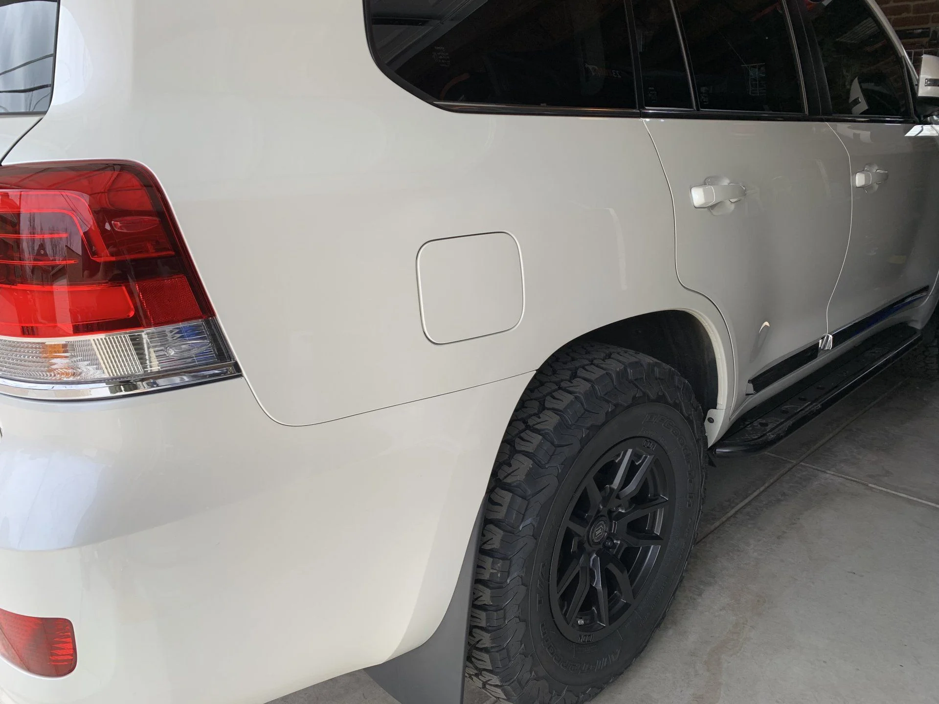

No worries. I appreciate you and your help. I do however think I was correct in the tire size. Please see picture attached. I just had these installed last week. I have a 2018 LC with Icon 17 Vector 5 rims. 285/70/17 10ply with load range E. Thanks for your help to this forum and hopefully some day I can buy you a beer or whatever your beverage of choice to say thanks. Take care.

In an effort to help since I had to figure this out too, I believe what @gaijin was getting at is that those tires are :
BFG KO2 LT285/70R17 121/118R Load Range E.
The LT part of that is particularly important. Since, for example, a hypothetical P285/70R17 or iso-metric 285/70R17, is a very different tire from an LT285/70R17 in terms of RCTIP and the load it can handle.

Makes sense and I apologize for being a newbie and not understanding the LT part. I get it now! Learn something new everyday! Figured the picture was worth 1000 words. Thanks again for clarifying!

👍 Glad to be of help, and your photos were a useful addition.

Thanks for the follow-up info. Just to be clear:
The RCTIP for those LT285/70R17 tires on your LC200 is 40psi F/R.

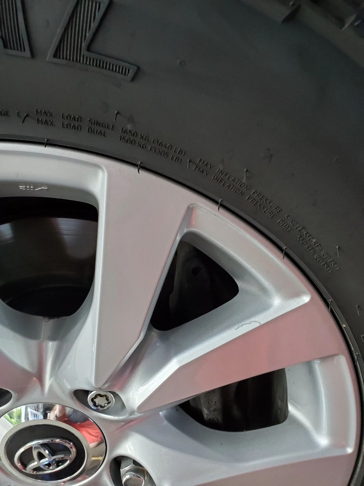

Hello. I got 2014 lx570 and put general grabber atx 285 65 18 LT on lc rims. I've contacted General and they told me to run ot on 36. Seems too low. Could you please let me know what is correct preasure? Thanks

Looks like you have the LT285/65R18 125S Load Range E tire. Ergo:
The RCTIP for those LT285/65R18 tires on your LX570 is 37psi F/R.
