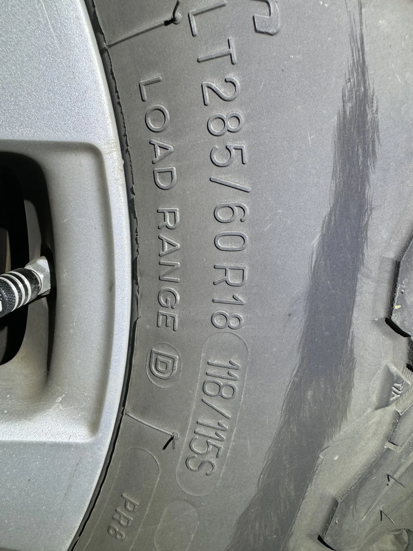

I’ve been running 35 PSI for this setup for almost 1 year now……(got them from discount tires)
13.5 MPG with a Frontrunner roof rack
Recommended cold PSI for 2016 LX 570, BFG KO2 LT275/70R18 Load E 125/122R?
My result from the Toyo Application of load..... is 42PSI
based on load rating of 2340lbs per tire.
