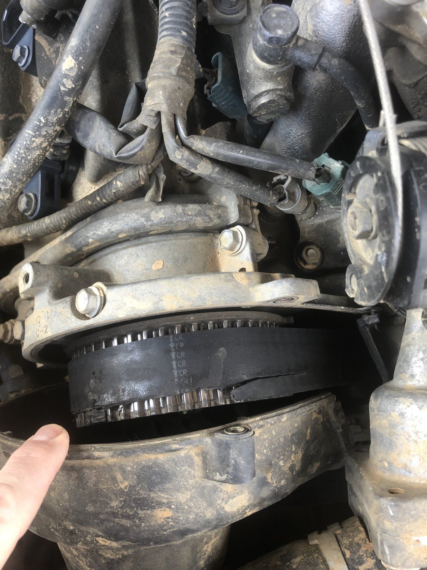

Belt was frayed on the front edge. When you remove the crank pulley, check the orientation of the sensor wheel ( that little sprocket). Wonder if it was installed backwards and the teeth wore into the belt over time.
