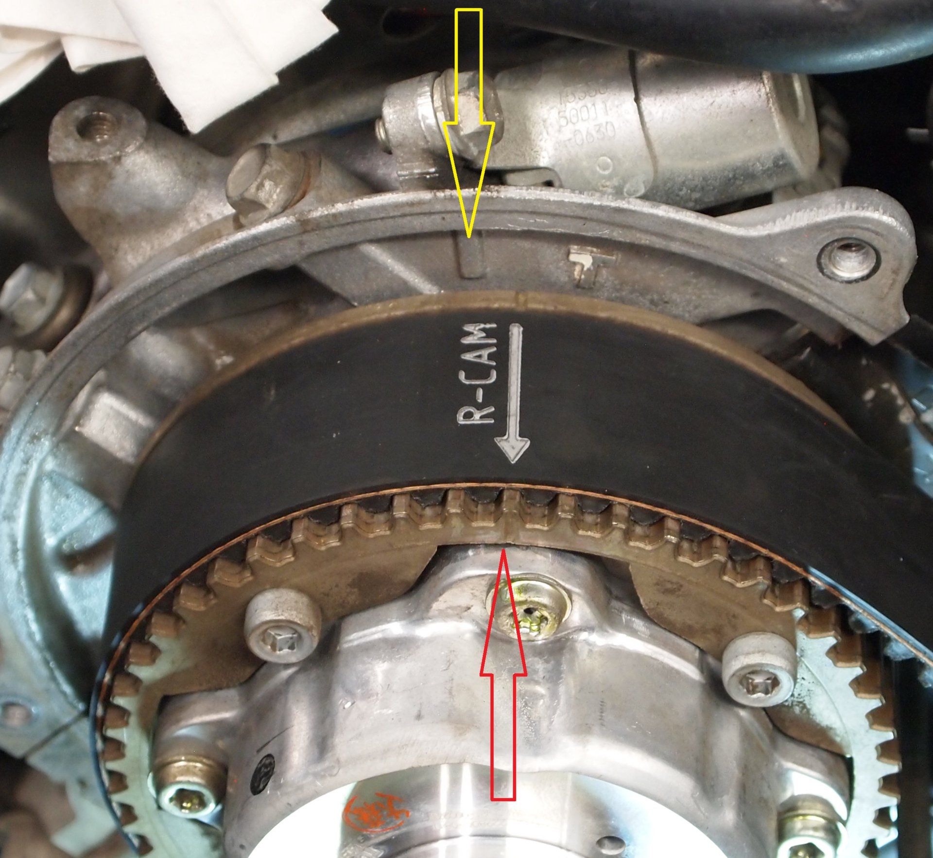

I checked my photos @ RightCamTiming.JPG by Pete Pressley and it looks like as long as the dots on the belt match the marks on the gears (All 3!) you are good. Mine is in a slightly different position than yours but I don't have a good shot of the crank gear.
The trick is to rotate the passenger side cam a tooth or two to the reverse with a wrench with your left hand, so you take the tension off the driver'side a bit. That is the side where you need to get the teeth set right. Then put the belt in place with your right hand.
If you do that, then let the tension off the passenger cam, and you can't be off a tooth.

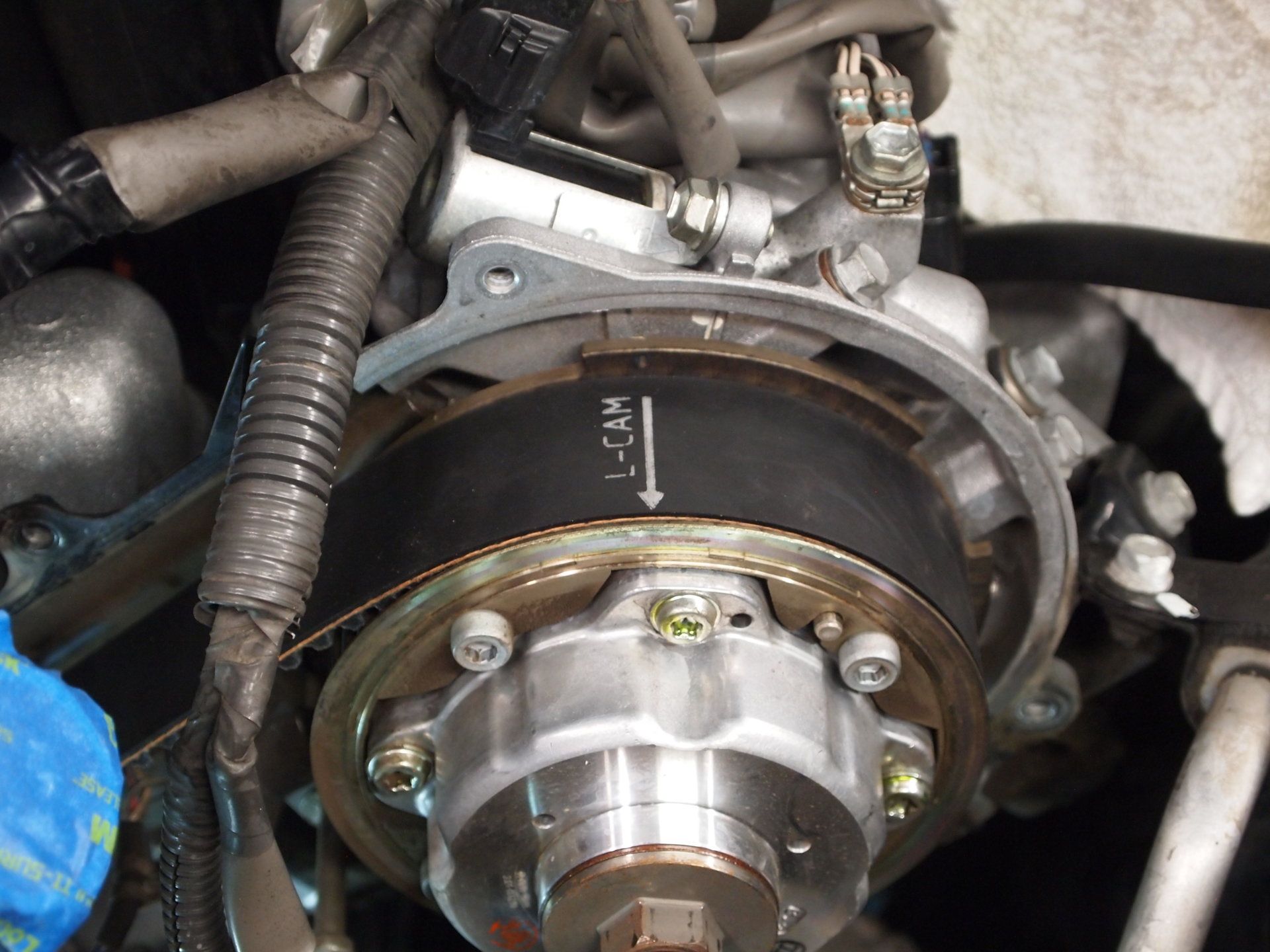

Someone correct me if I'm wrong, but you may have your belt on backwards. Typically, left refers to driver side and right refers to passenger side. I'm not sure if it makes a difference with the 2UZ as I'm still a relative newbie to these trucks.
That and the arrows on the belt are supposed to point toward the front of the engine.

Yes the belt was backwards in the photo above.

That belt is on wrong. Mark on belt "L CAM" means left cam. Left is driver side in left hand drive USA made vehicle. Think about side as seen when sitting in drive seat.

Assemble ensuring the belt to cam (the red arrow in the photo to to markings on the belt), and belt to crank markings as shown by @2001LC in post 16. Install tensioner and pull pin. Spin the engine over 720 deg at the crank (360 degrees at cams) and it should line up as your photos show between the cams/cam covers and crank pulley/ lower cover. Note the belt markings will no longer line up after this.
