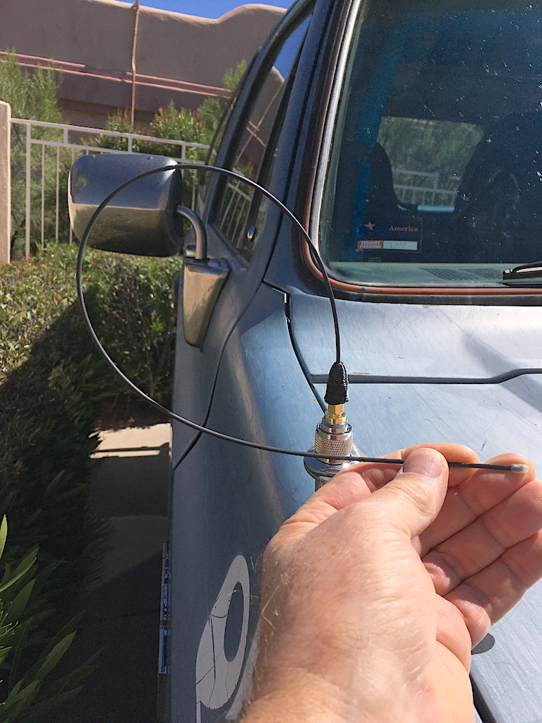

…Granted this may sound self-serving, but why use antennas that are not tuned explicitly for GMRS?
This has worked well for me on HAM frequencies and has survived well on AZ trails:
So I would like to have that kind of antenna flexibility for GMRS, as well, and work at the radio’s 50W setting. But for now the HT’s have proven sufficient, more tinkering to come later.

One thing I’m still interested in is to get a flexible/difficult-to-destroy antenna mounted on my truck. I’ve scraped magnet-mounted antennas off too many times than I can count. On 2m, I’ve had good luck with antennas made from Nitinol wire. So when I get around to it I’ll try and tune one of these for GMRS. For now, the Baofeng HTs do the trick for comms in small, and relatively close groups on desert trails.
If you want NMO, Signal Stuff makes one that could be trimmed. I have one in a box waiting for me to drill a hole in my roof.
