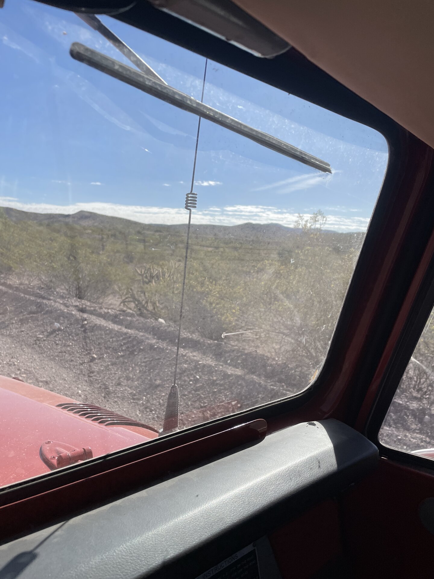

You can use an old microwave magnet on the underside of the top, allowing you to mount the antenna on the fiberglass. What Midland model did you go with?I bought one of the Midland GMSR radios for wheeling here in southern New Mexico.
It fit perfectly in my radio delete spot. Just wired into the old cigarette lighter for now.
I do not have my license yet, but i am merely listening to trail instructions.
Bought the kit with upgraded ant, and just magnet to the front cowl while on trail. Desert likes to pull stuff off the fenders
…or off the roof. Running trails in AZ, I can’t count the number of times I’ve scraped a mag mount off the roof of my K5. Granted, the 80 has thicker metal, so a magnet works better.… Desert likes to pull stuff off the fenders![]()
That’ll hold, but won’t ground the antenna. For best performance an antenna needs to be grounded to the vehicle, either electrically (metal to metal) or magnetically. So the mag mount ought to be attached to a conducting part of the body; fiberglass ain’t it. Will it work somehow - probably. Will it work well - probably not. Just saying.You can use an old microwave magnet on the underside of the top, allowing you to mount the antenna on the fiberglass. …
MXT275-WHIP Extended Range BundleYou can use an old microwave magnet on the underside of the top, allowing you to mount the antenna on the fiberglass. What Midland model did you go with?
It is common practice to ground mount with copper tape. A lot of magnetic antenna mounts have a plastic insulator on the bottom to prevent scratching the surface it is mounted on, and they work just fine in this configuration.That’ll hold, but won’t ground the antenna. For best performance an antenna needs to be grounded to the vehicle, either electrically (metal to metal) or magnetically. So the mag mount ought to be attached to a conducting part of the body; fiberglass ain’t it. Will it work somehow - probably. Will it work well - probably not. Just saying.

Because it is the magnet in the base that couples the antenna electromagnetically to ground. For that to work, it best sit on a metal piece of the vehicle body. The plastic scratch guard won’t interfere with the magnetism.It is common practice to ground mount with copper tape or small wire. A lot of magnetic antenna mounts have a plastic insulator on the bottom to prevent scratching the surface it is mounted on, and they work just fine in this configuration.
