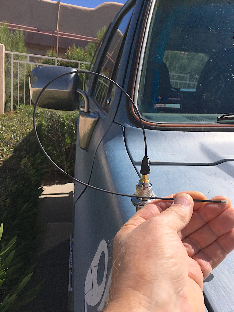

This is a 2m 1/4 wave antenna, from SignalStuff, made from Nitinol wire, on the fender of my K5:
Worked well on 2m@50W (probably not ideal for that SMA mount…IIRC, SWR was 1.6-ish), including contacts ~45 miles away. And, main point for me, it has held up well on brushy AZ trails. Probably also not ideal to transmit at highway speed due to antenna deflection from headwind, but that’s ok.
