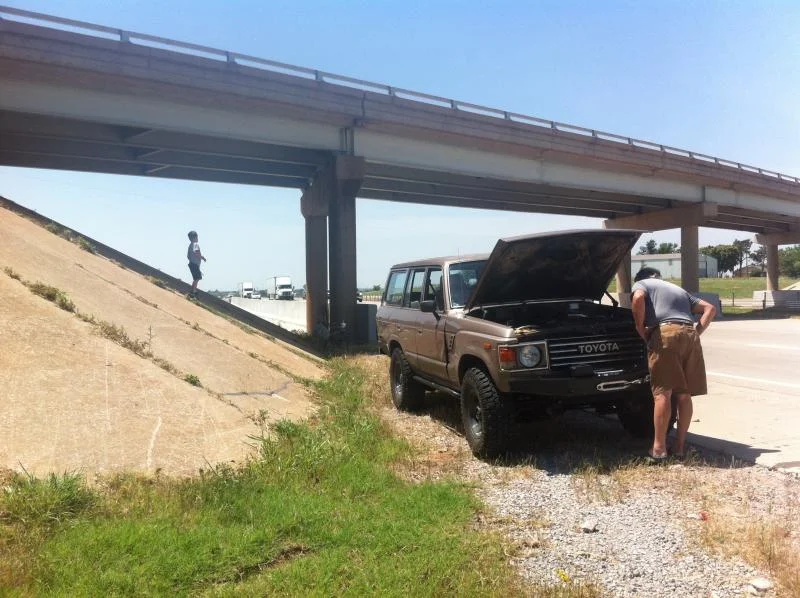

"CAMERON!!! LOOK AT THE TEMP GAUGE!!!" my dad shouts. I look down and it is PEGGED! I pull over immediately, turn off the AC, and turn on the front and rear heaters. But there is no heat coming out. At all. Just room temperature air. I have no idea how long we have been overheating, but I'm guessing long enough to run every drop of coolant out since it isn't blowing hot air.
I look around and decide we are in a bad spot to stay parked. There isn't much flat shoulder and there are a lot of trucks flying by. There's an overpass just in front of us, so I start the truck and move to the other side of the overpass so we'll have some shade and the huge concrete pillars for a little protection from runaway vehicles.
I pop the hood and the radiator sounds PISSED! I spit on it and the spit vaporizes immediately. It sounds like it is boiling inside and I can hear it letting pressure out of the overflow hose. I look around and don't see any loose or disconnected hoses, so I decide we will just pull out the camp chairs and sit in the shade and wait for it to cool down before we check it out.

I turn my attention to the truck, which has cooled off enough that I deem it safe enough to open the radiator cap. I don a leather glove and a towel and open it to the safety stop. There's no steam or boiling water coming out so I take if off. I pour all of the half-full jug of coolant I have into the radiator. It takes another 16oz bottle of water before it is full.
This confuses me because it isn't missing enough coolant to overheat, so I take a better look around the engine compartment. That's when I notice the belt missing from the water pump and dangling off the crank.
SWEET!!! I've got a spare belt! I can fix this sh!t!!
Then it hits me, the belt is still intact. The belt isn't the problem. So I look to see why it has come off.

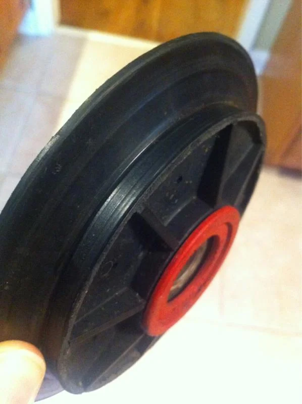

The bearing in the idler pulley (that replaces the smog pump) has seized, which caused the belt to shear the pulley in half. So now there is no way to tension the belt.
I remember seeing a thread somewhere on 'Mud about being able to bypass the smog pump and running the water pump off the other groove on the pulley. The only downside is that you lose power steering.

We pull up to NAPA, where I show the clerk my pulley and ask if he possibly has something like it. I don't care if I have to buy a power steering pump from a Ford Taurus, as long as the pulley will work.
He asks the application and I laugh because this is a homebrew part JimC made in his mom's basement with lawnmower parts. He takes some measurements, pulls out a catalog, and disappears into the shelving.
He comes back, but the look on his face tells me he doesn't have it. He breaks the news gently, but says there is an ACE Hardware a few blocks away and they sell lawnmower parts.
