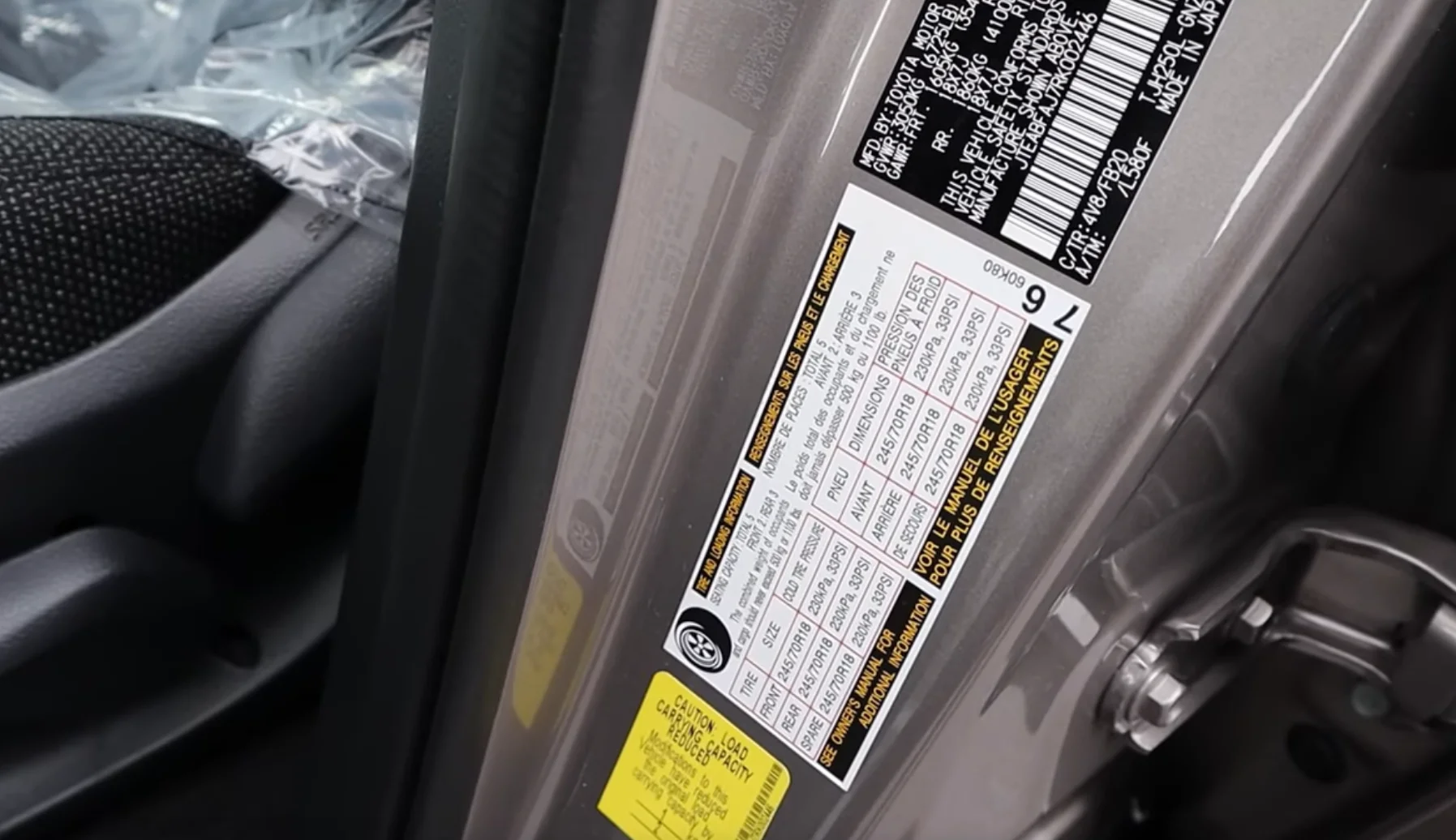

49 CFR 571.110(S4.3) has the payload label regulations:
That requirement introduces the term vehicle weight capacity for use on that label we like looking for for payload, but it defines that weight as follows: Vehicle capacity weight means the rated cargo and luggage load plus 68 kilograms times the vehicle's designated seating capacity.
So, those commenting that Toyota seemingly has been deducting passenger weight from payload, it appears that's true. 68 kg is 150 lb.
So, a full payload figure needs to have the number of seats times by 150 added back in.
For the black FE with the sticker we saw:
6,835 lbs (sticker) - 5,037 lbs (website) = 1,798 lbs
Then vehicle weight capacity is 1,100 lbs (sticker) + 5*150 lbs = 1,850 lbs
For the GX550 Overtrail:
7,165 lbs (sticker) - 5,466 lbs (website - bare overtrail) = 1,699 lbs
Vehicle weight capacity is 1,545 lbs (sticker) + 5*150 lbs = 2,295 lbs
So, note that the Overtrail/+ can get up to 5,666 lb curb weight per the GX Spec sheet, but I used the lowest weight to show that the GX has a big discrepancy between the GVWR - Curb and the Vehicle weigh capacity....it's interesting.
So @TWILLY , maybe payload is fine with this generation, assuming we are interpreting the regs right. Thoughts?

Big ups for doing the research. Interesting to see the actual calculation.

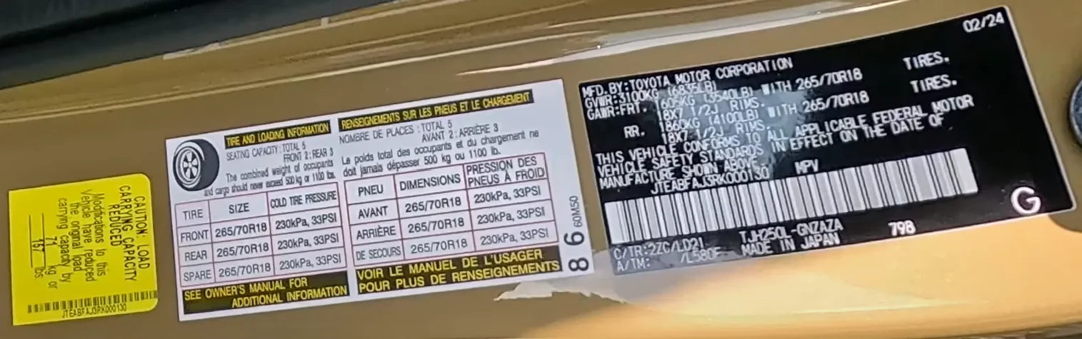

Another LC 250 FE placard from what appears to be a production model (2/24 build date).

It's weird then that it said "the weight of occupants and cargo should not exceed ____ lbs." But it does maybe explain the 4Runner vs LC difference since the 4Runner has the 3rd row.

Interesting hypothesis. Thanks @TheLCProject for digging around in the regs! (Now we’re in spec Zelda.)
As jetboy noted, the thing that doesn’t compute for me is that the placard states very clearly that the combined weight of passengers and cargo should never exceed 1100 lbs. Now, if there were 750 lbs somehow missing from that value, I might have to go Land Cruiser shopping… I’ll do some more digging too.
Here is the door placard for a production model 1958. As with the FE, it shows a 1100 lbs weight limit for passengers and cargo, with a modification (yellow) for reducing that limit by two pounds (rather than reducing it 157 lbs, as shown in the FE placard upstream in this thread).

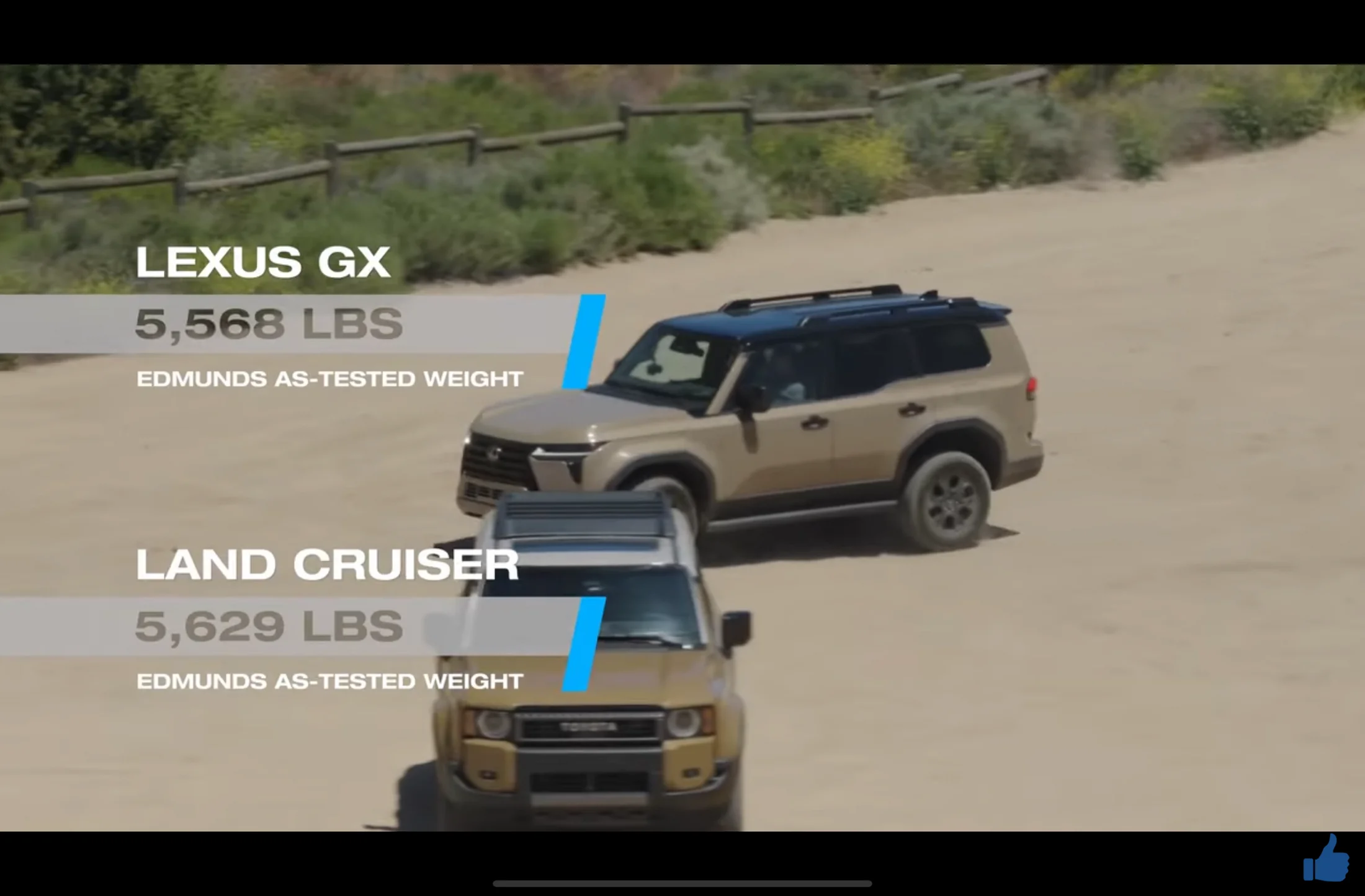

Edmunds posted a video testing an Overtrail Plus and a First edition, they weighed them and the FE came in about 60 pounds heavier overall.
They also did a brake test at the end of the video and the LC exhibited worse braking performance while having more street oriented tires which was interesting as well.

That's 600 or so pounds more than the curb weight that Toyota specifies for the 250 on its website. Be they inept or purposefully misleading, it's really disappointing to see Toyota's ongoing failure to correct misinformation about the 250's specifications.
