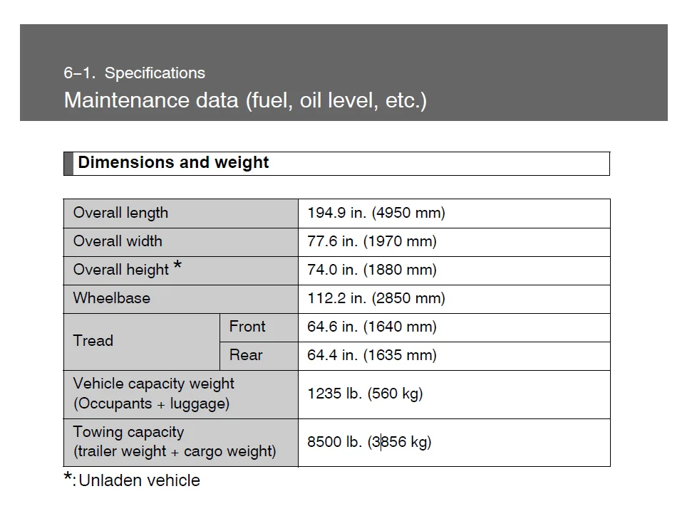

This is from a 2008 200 series owners manual. Maybe the payload changed between 2008-2021, but 1235lb is only marginally more than the 1100 listed for some 250s so far.

What they mean in the LC200 manual at 1235 lbs is a mystery to me. In the 2021 manual that number is 1320 lbs. That seems more like 1635 lbs - 2 passengers.

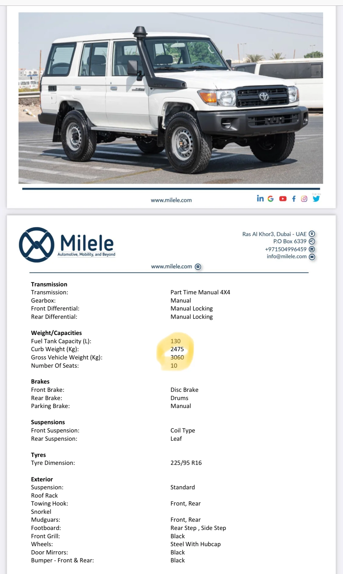

Gibralter Stockholdings' very thorough spec data shows the 300, 76, and 78 with payloads ranging from 1700 - 2000 lbs respectively.

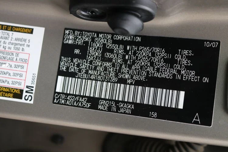

Is it possible Toyota is understating the numbers on the stickers and being conservative? It seems there's a universal discrepancy between sticker payloads and GVWR-Curb.

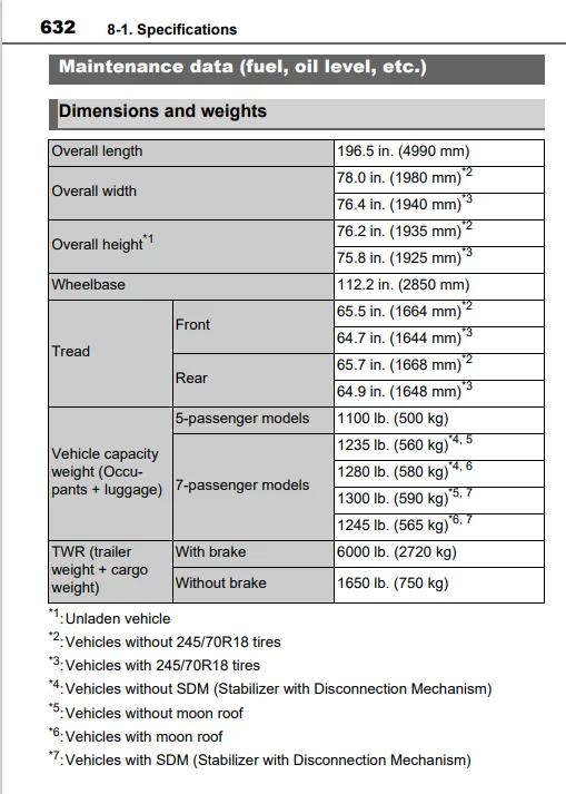

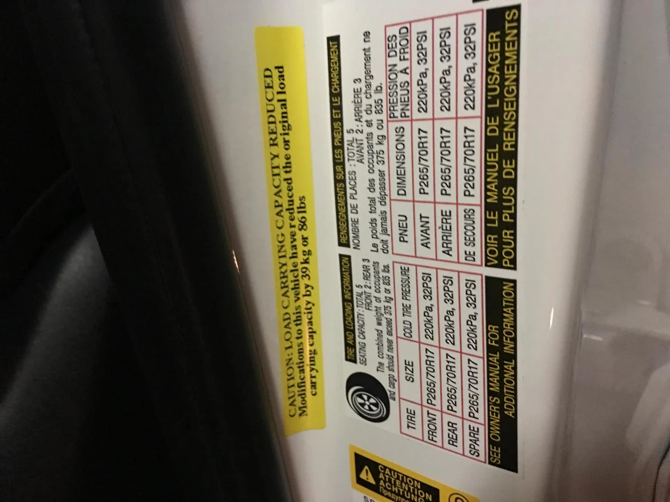

It's unclear how the door jamb weight limits are calculated.
I defer to GVWR - curb weight to calculate payload, but Toyota's website and tech specs still conflict on those values.

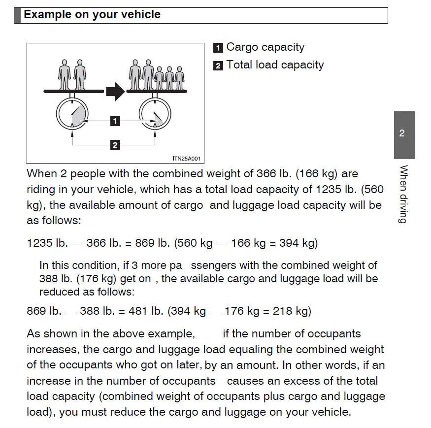

Here's the example given from the a 200 series owners manual. This implies that the given 1235lb payload does not include passengers or cargo.
I would agree that how Toyota does the math between stated total load capacity, GVWR and GAWR is unclear. I'd guess that each axle is rated independently for instances of uneven weight distributions (snowplow/heavy trailer tongue weights), and GVWR is used as a total upper limit due to some other limitation (regulatory, or downstream mechanical).
The payload determination is unclear.
GVWR and GAWR per axle is clear.
Amazing the complex explanation that load capacity = occupants + cargo...
And that they are starting off with the incorrect load capacity of 1235 lbs for a 200 series to start off with.
200 series GVWR - Curb Weight ~ 1600 lbs, either for the V8 gasoline or diesels overseas.

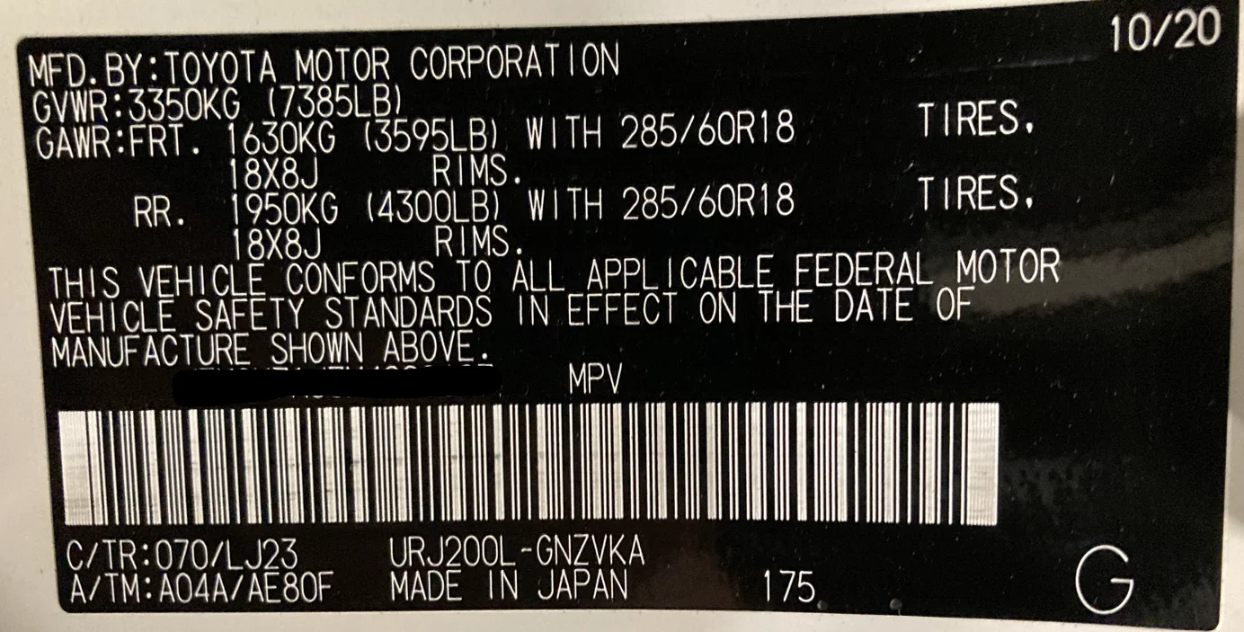

Front (3595lbs) and rear (4300lbs) GAWR's (total 7895lbs) is above overall GVWR (7385lbs), so that cannot be a determining factor either.
