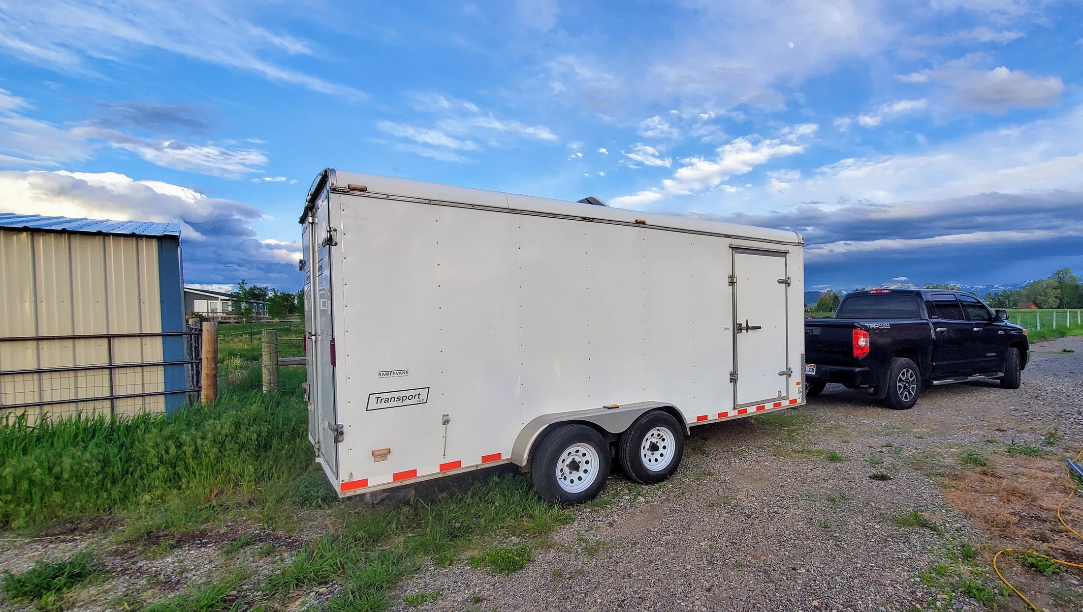

It's not a great photo, but this is my tundra at 8020lbs. It only has a 1175 lb load capacity according to Toyota. The load is 2330lbs. That's over 1k lbs over Toyota payload. Seems to handle it without breaking a sweat. Can you tell it's heavy? Sure. Do I worry about breaking anything? No.
Try the same with a yaris that has the same payload and I think the results will be a lot different. That's why I don't think Toyota payload means what I think it means.
