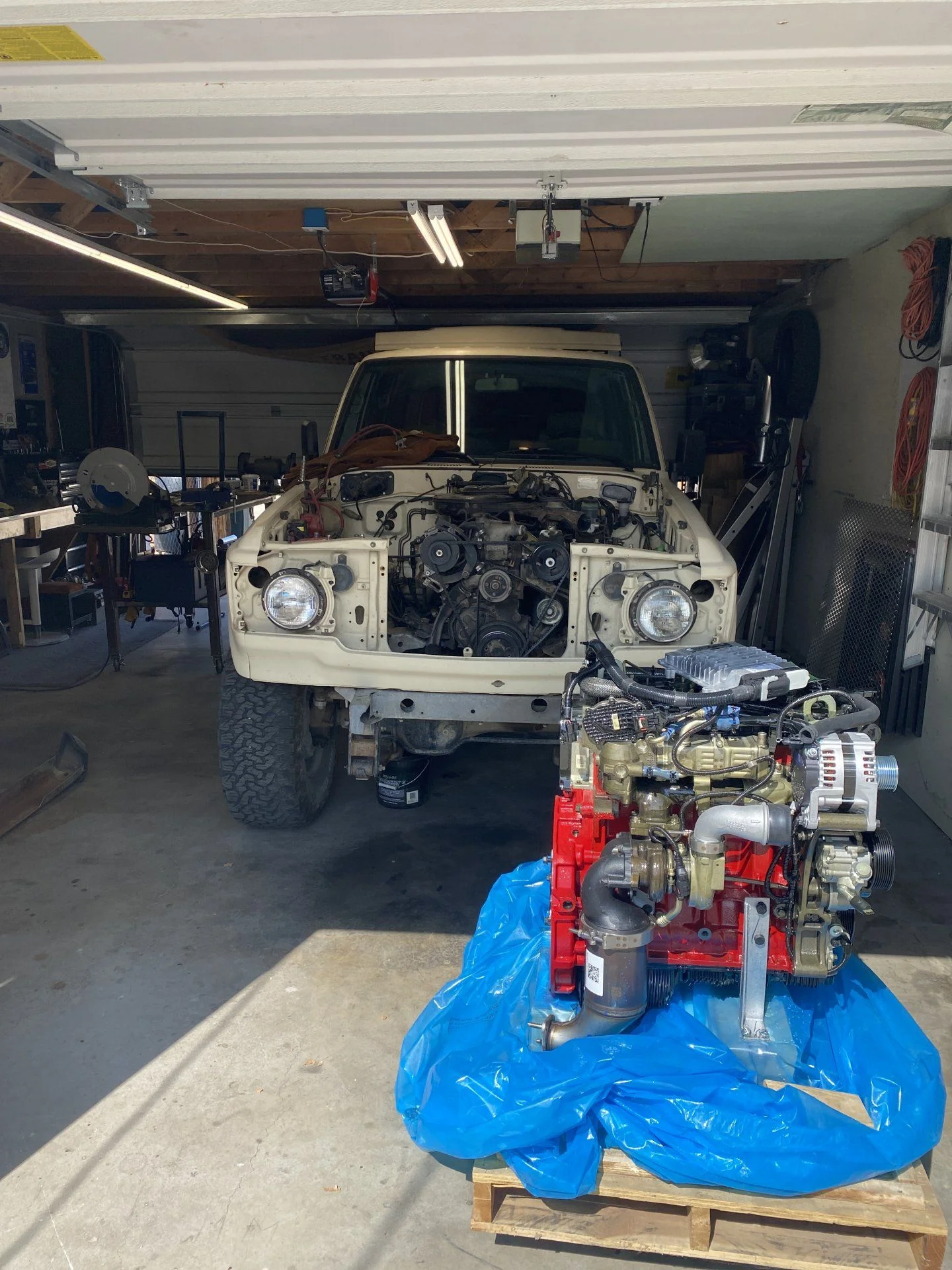

Okay. I have decided on the adapter for the conversation. Overland Cruisers out of Belgrade, MT has made an adapter kit that satisfies my vehicle configuration, the '85+ 60. After talking with Stephen at the shop I was pretty satisfied with the engineering that they have done. No moving or modification of driveline needed.
Parts are on order and I can't wait to pull the 2F and and start welding.

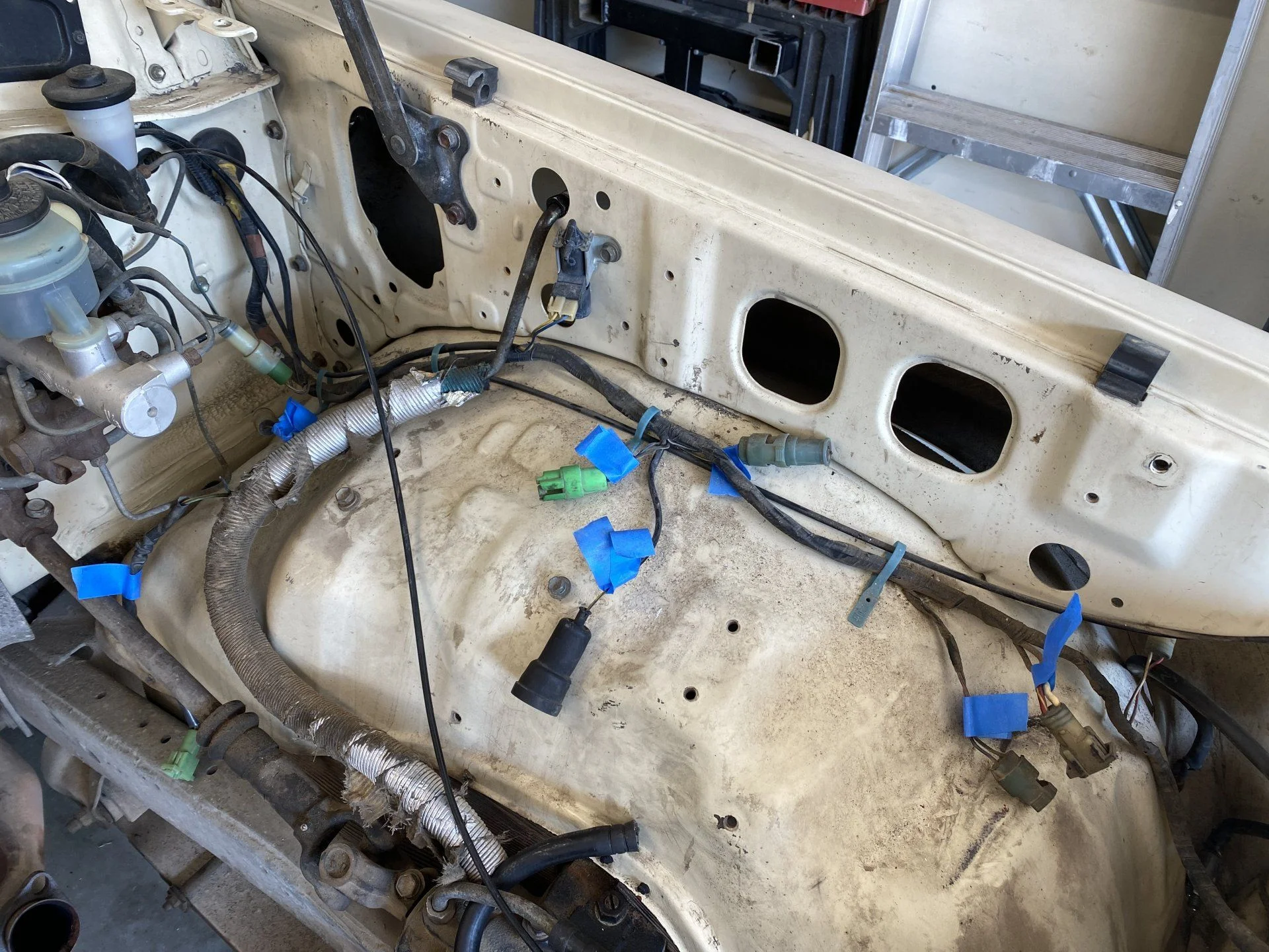

Spent the day taking off unneeded stuff for the gas engine: Firewall plumbing.
And labeling all the ele. connections I’m not going to need. I will be taking it all off.

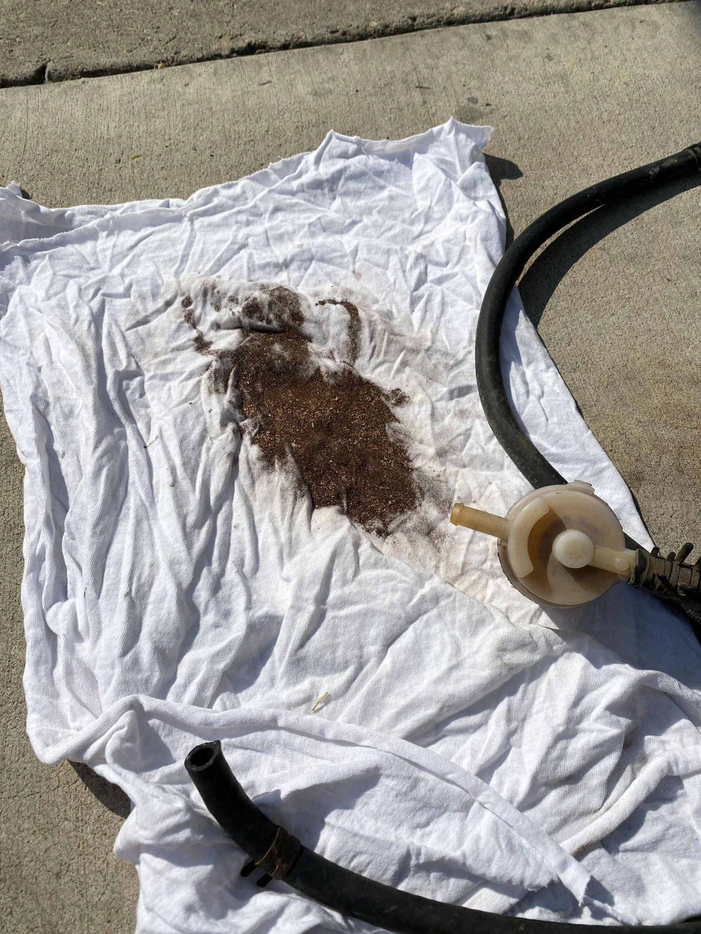

And, draining the fuel tank.
My gauge read empty however I usually have a 3 gallon reserve after that. I think I drank about 3 to 5 gallons total.

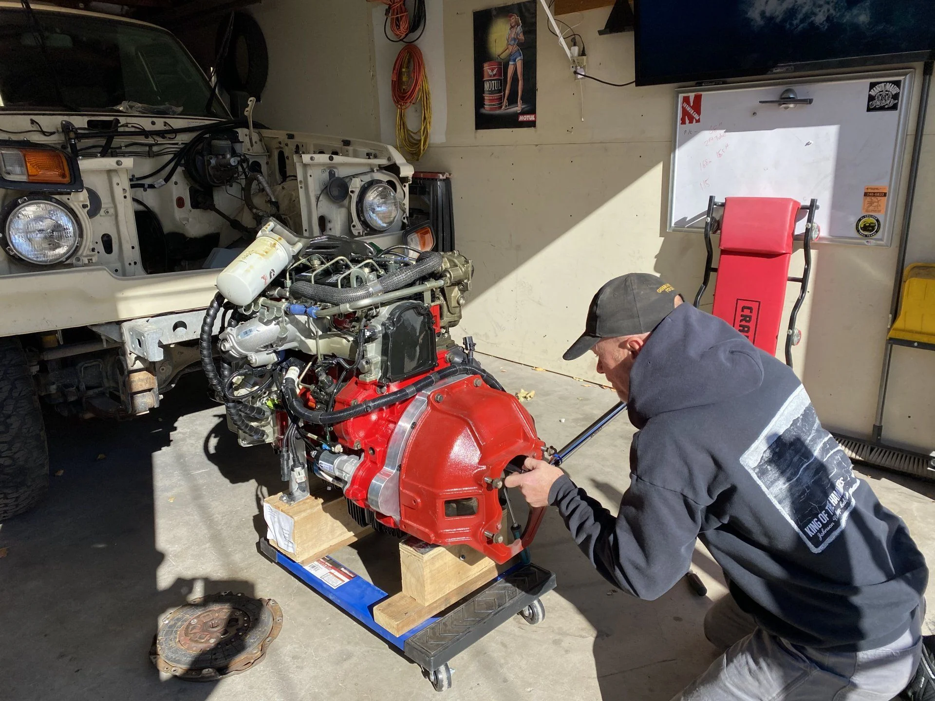

Did more of the install yesterday.

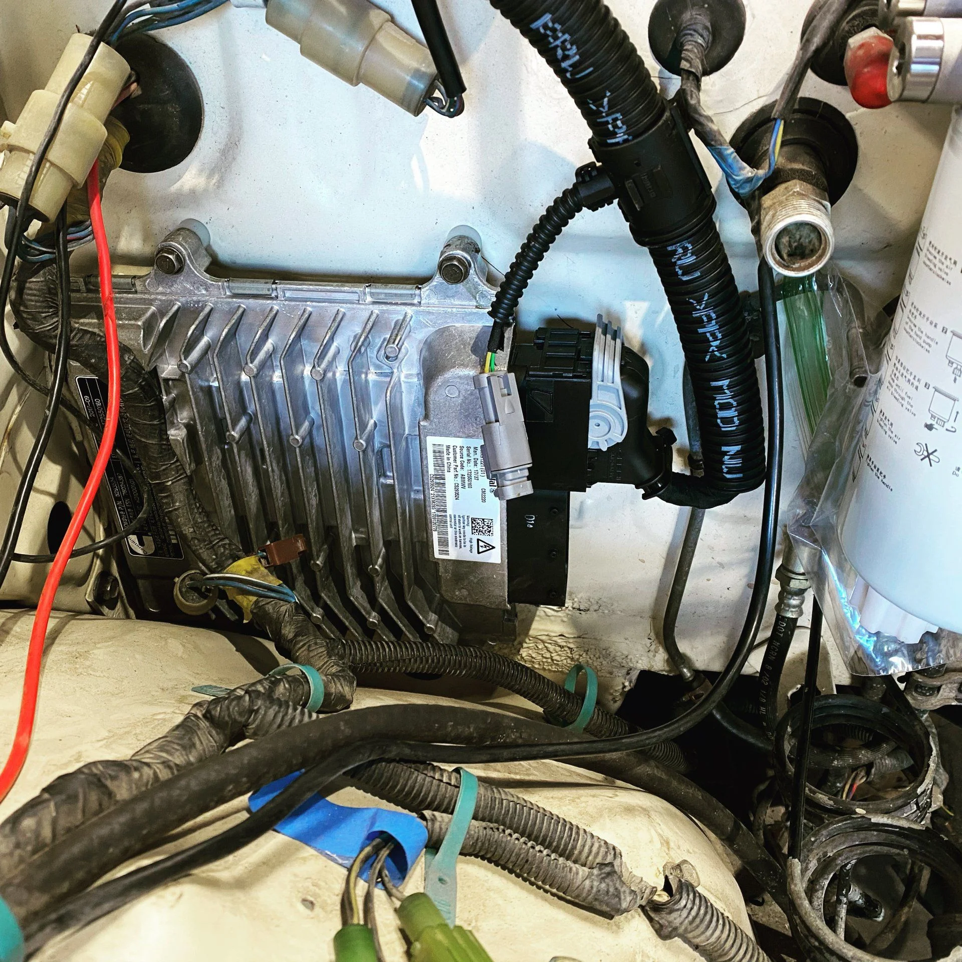

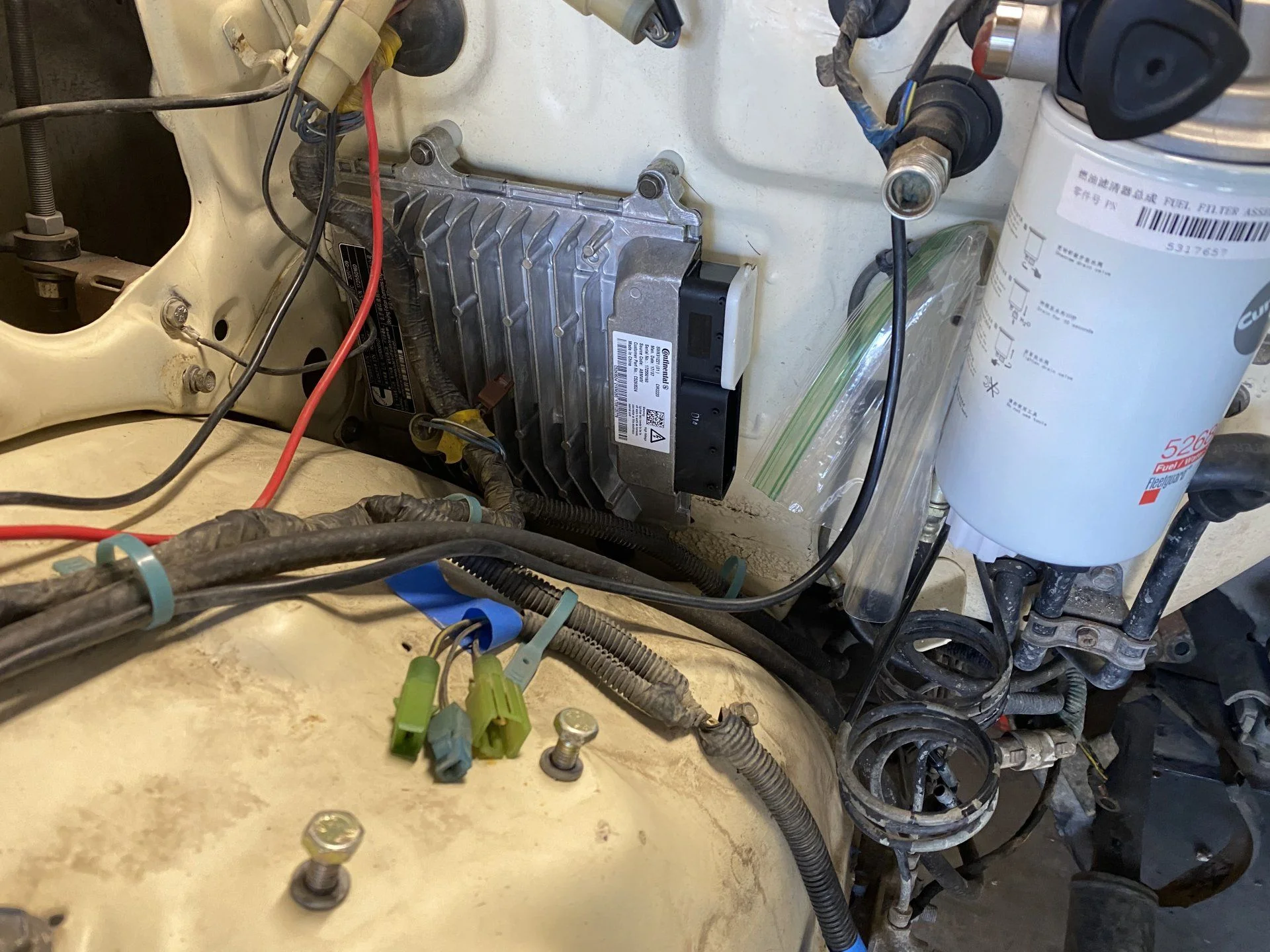

1) The ECU is mounted on the passenger side right below the windshield bottle. Because of the way the wiring loom is configured the best place to put it is passenger. Why, well the loom you see needs to be on right because it's the power wiring for the rest of the engine. The loom that's not plugged in (below one pictured) is the engine side of the loom that has a plug fo the fuel filter 8 inches away from the plug end. Thus the fuel filter is to the left of the ECU.
2) The installation manual calls for the ECU to be oriented so that if water comes in contact, it has a way to flow off. Also, the cooling fins need to be vertical for heat dissipation.
3) The 'T' for the two interior heat exchangers is not present right now. The fuel filter is in the way as it's pretty tall. Will come up with a solution later.

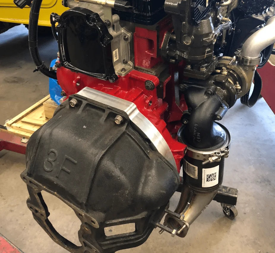

I chose Overland Cruisers kit. They are located in Belgrade MT just outside Bozemen MT. The reason for this kit was it had everything I needed for the conversion. The adapter itself is comprised of three pieces, all hardware, engine and frame brackets, a radiator bracket, an intercooler bracket, the intercooler and the fuel pedal bracket.
But the most important thing that this kit offered was the feature that I DID NOT have to change the driveline on the 60 or worry about the shifter needing a new placement.
Also, this adapter allows you to use the stock clutch, flywheel, pressure plate and 2F bell housing. It's as turn key as possible.

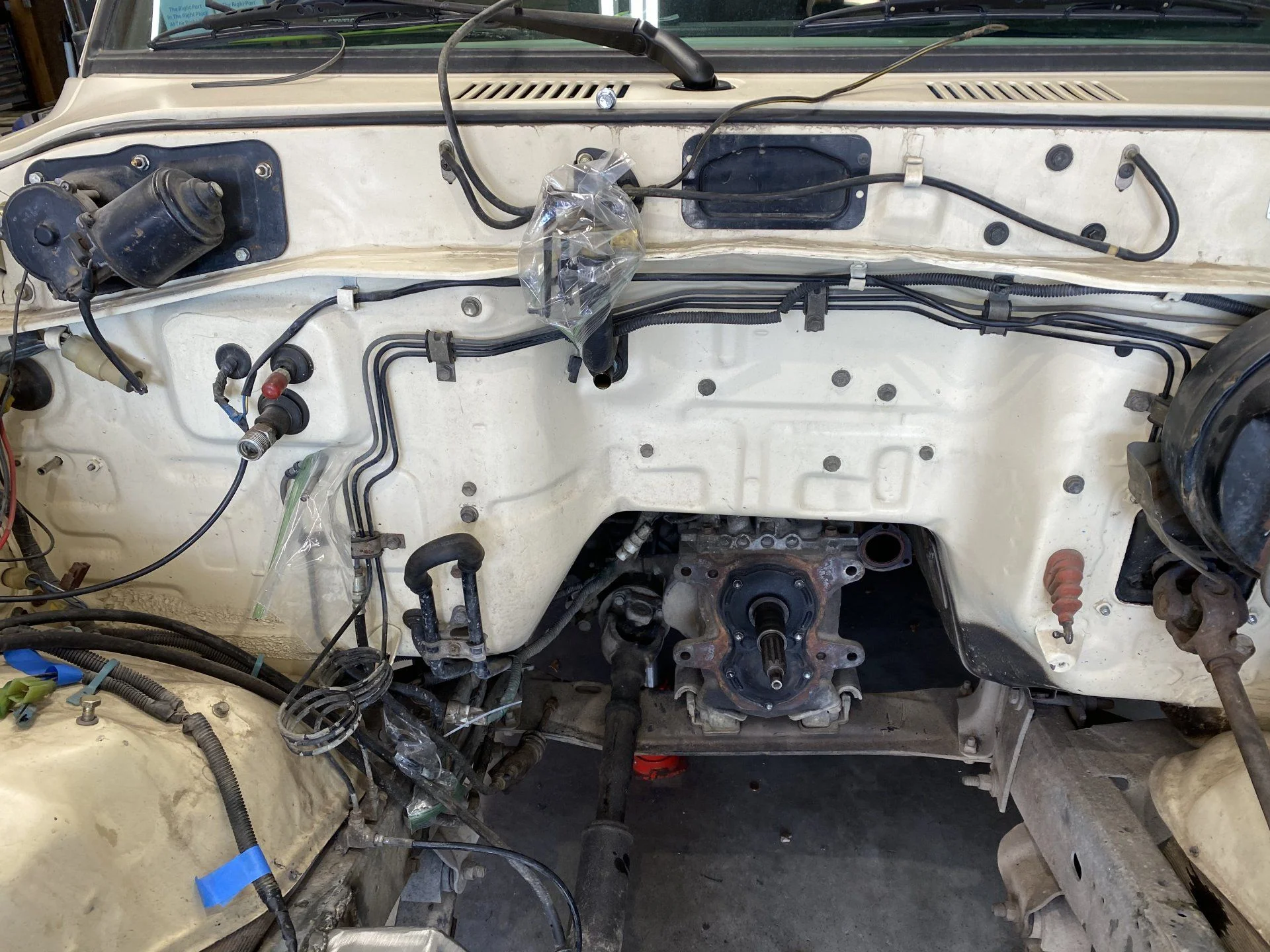

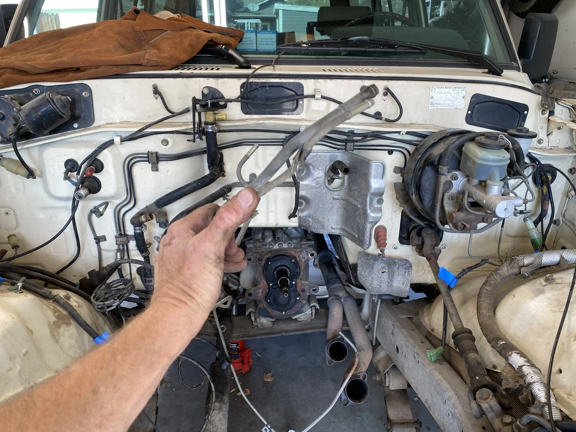

Below picture is the engine bay with all the unnecessary emissions piping and heat shield that you are not going to need.
Not needed:
throttle linkage (all of it)
Emission tubing and piping from the charcoal canister
all heat shields (I was going to keep them but the engine did not have clearance with a test fit)
heater cores: I still don't have the secondary core hooked up. I placed the fuel/water separator above that feed/return pipe.
