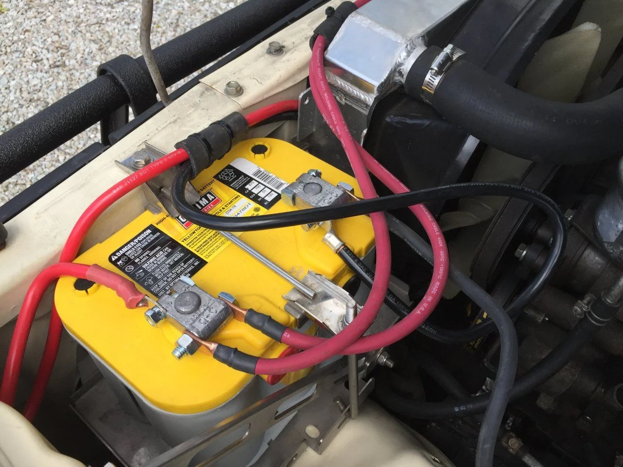

Well I got the dual battery set up for the winch and accessories. Blue sea systems switch and isolator are being used.
Just a couple finishing touches to secure the wires to prevent any rubbing on the chassis and reconfigure the starting battery terminals due to the fact I forgot to buy four terminals instead of two. Whoops!!
Possible upgrade to the alternator would be bringing it into a shop and have them increase the amperage from 55 A to 200. It depends on how much the case can hold in terms of more copper.

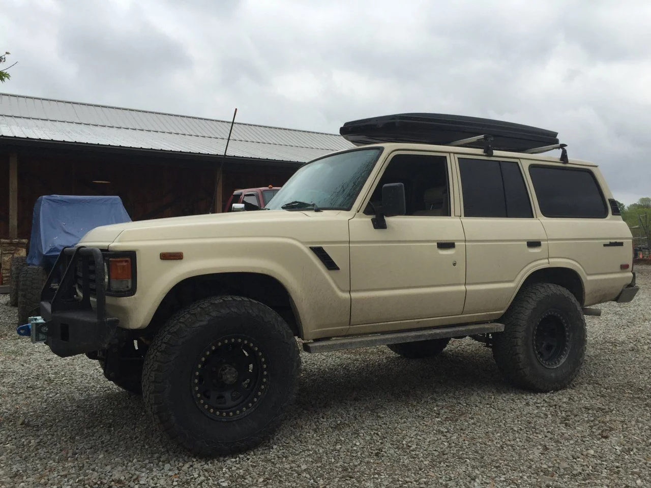

So I did one modification today which included 5 1/2 – front shackles. This levels of vehicle out and makes it to the stance I wanted. I've had a significant amount of weight in the back and so far the springs have not dropped any more than they are.
Took it for test drive and castor checked out, no death wobble. I wasn't anticipating it anyway.
Added the Thule Sonic alpine 633 in black for camping gear and skis when the season is in.

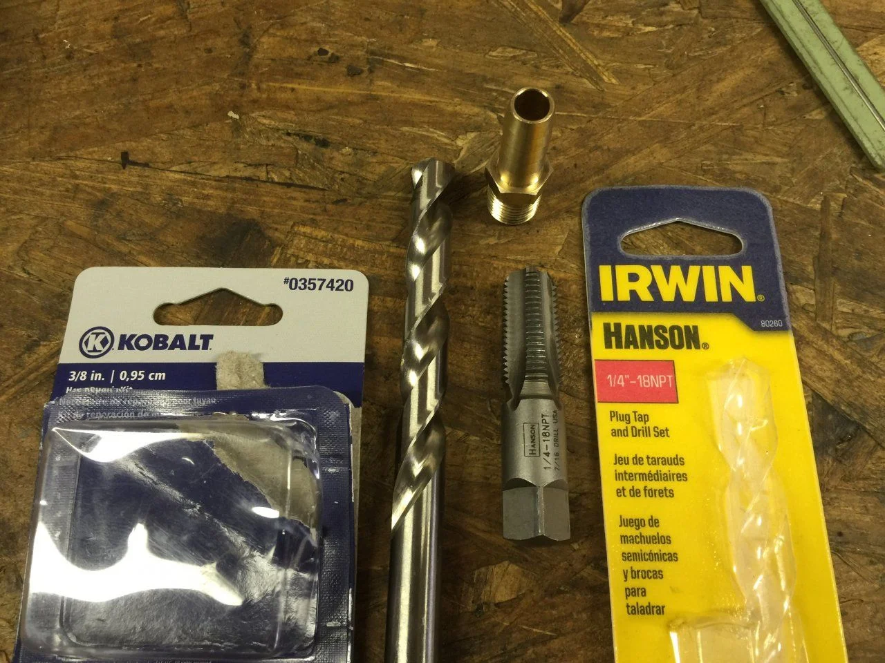

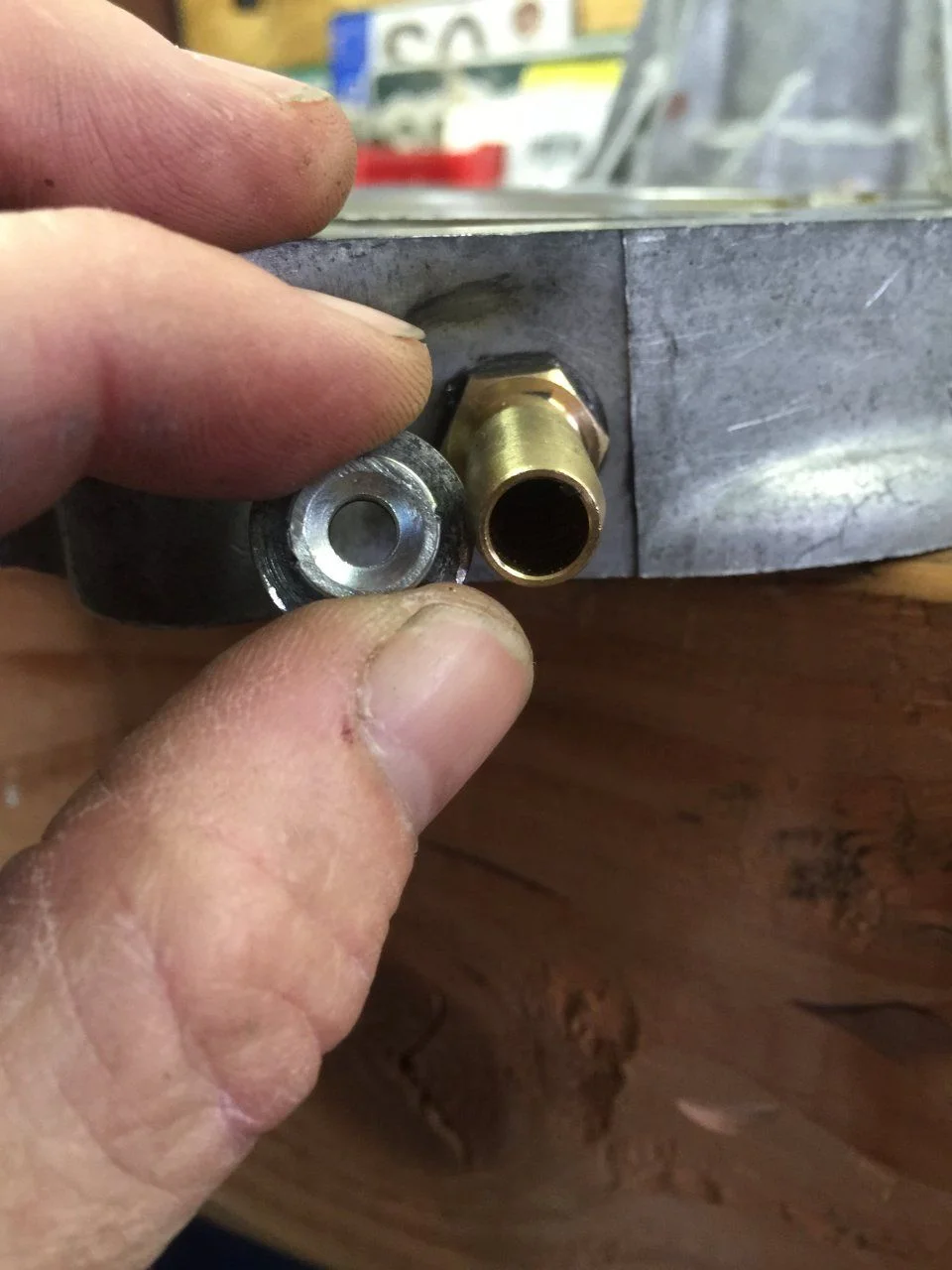

Since I have a tcase apart I decided to tap the breather hole with a 3/8 inch ID quarter inch NPT fitting. This will allow ample breathing to the tcase for years to come and I won't have to worry about oil pushing into the transmission.

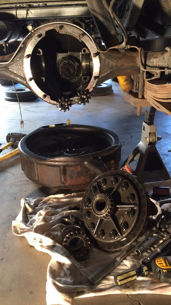

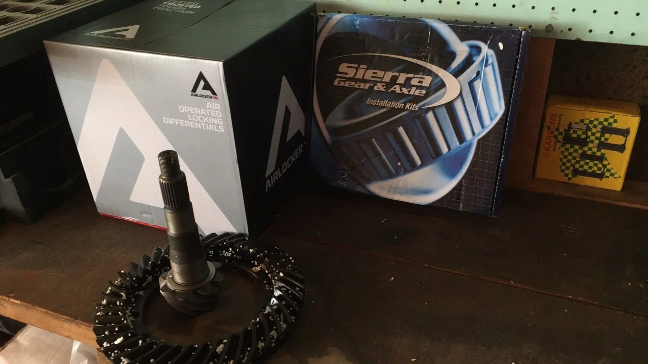

T-case is back together but that was not the problem. My rear end is gone. Just ordered the rear ARB locker and 4.88 gears. That will get me back to driving and then I'll do the front.
