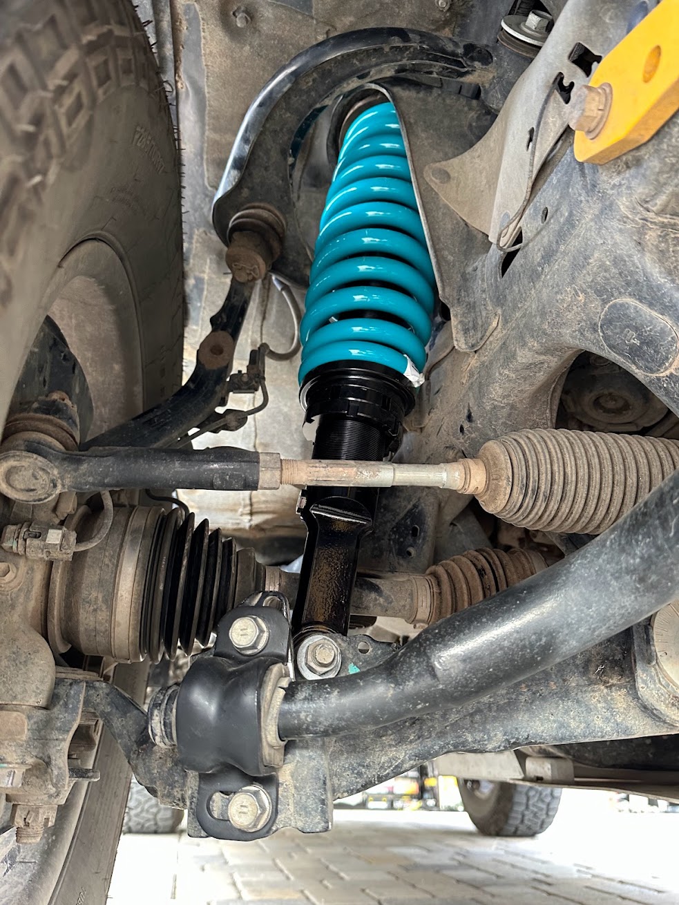

I replaced mine at 35k with a Dobinsons IMS medium springs to get about a 2" lift. It's been 30K miles and they've been great. The OEM springs are very soft and wallowy compared to the Dobinsons. I really like how it firmed up the ride and handling. Here's a few of my thoughts:
I had the KDSS spacers installed with the lift to help reduce any leaning that seemed to sometimes happen when people lift. One problem I discovered was that the front KDSS spacer that's installed on the passenger side lowered the KDSS sway bar such that the KDSS ram was hitting the backside of my CBI front skid. I ended up pulling out the front KDSS spacer. I left the rear KDSS spacers in since they helped to push the rear sway bar away from the spare tire (265/70/17). In my case, I didn't observe any difference with the KDSS spacer helping or hurting the lean. My lean comes and goes. It's never been more than 2cm though. The place that did the alignment after the lift specializes in offroad. I asked them about needing a new panhard bar. They didn't think it was absolutely necessary considering the minimal lift. If I look closely at the rear I can see that the rear wheels are a little offset. Eventually I want to get a new panhard bar or the Dr. KDSS correction kit to fix, but haven't yet.
The lift puts the front KDSS sway bar bushings at a bad angle. I think it'll definitely accelerate wear. I've looked at the Dr. KDSS front sway bar adapters. The description mentions that they push the sway bar forward so one concern I have is how close it'll push the sway bar towards the back of the skid again. Looking at the thickness of the adapters and current clearance, it looks like there's sufficient room to have the adapters. But another thing is that the sway bar bushings aren't that expensive to replace. I think $20 when I last looked. The adapters are 10x.

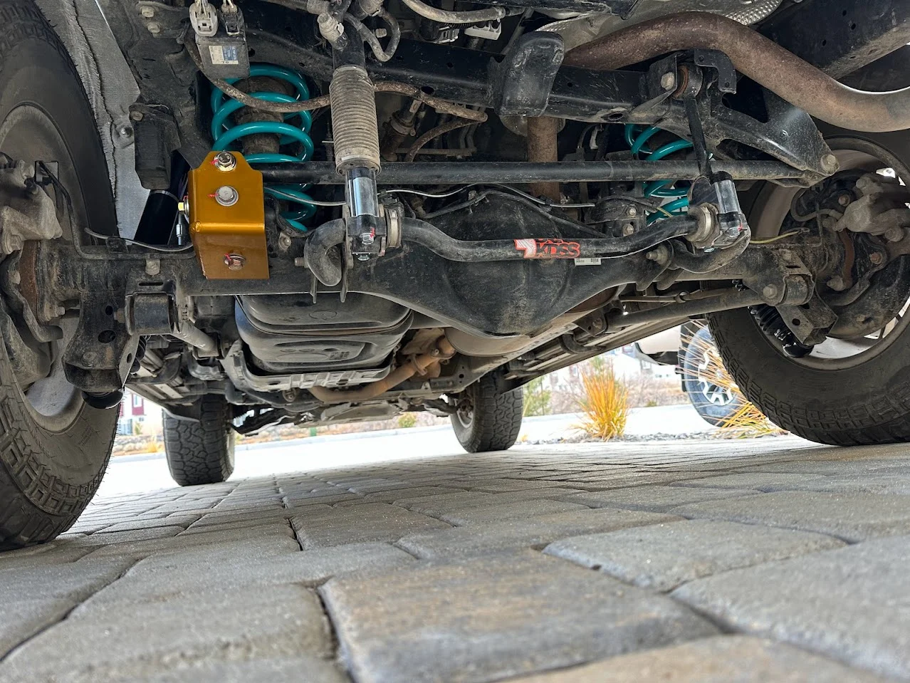

At 2 inches of lift, just get the slotted brackets. I didn't need the plates, the brackets are cheaper and they don't change where the sway bar sits. Made aligning the sway bar way better and easier to install. I may get the plates at some point as I can see some deflection still but it's not as bad as normal.
I also have the full suite of things installed out back, and have no lean at all. I have the retaining collars as well, but just haven't installed them.
@jdam thanks for posting the pics. Those KDSS bushings with the brackets look a lot more relaxed than mine.
Was it difficult to install the trackbar correction kit?

It's pretty straightforward with the right tools. It took me less than 2 hours and that included having to cut/grind a section on one of the brackets so it would fit. Watch the DrKDSS videos to see if its an install you can handle.
