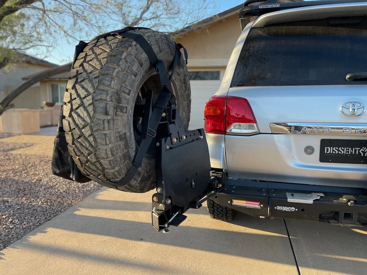

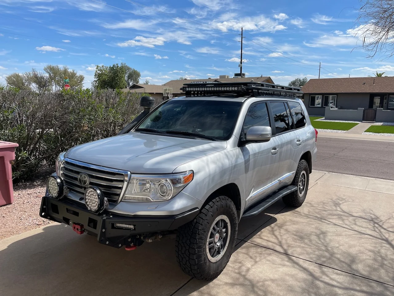

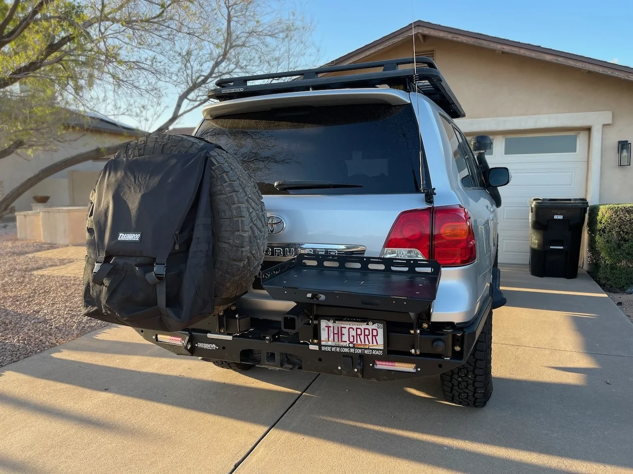

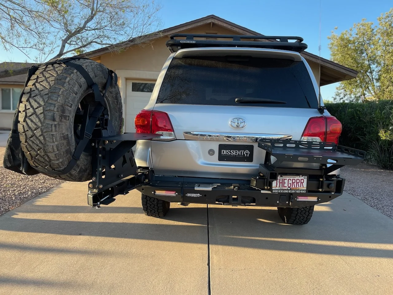

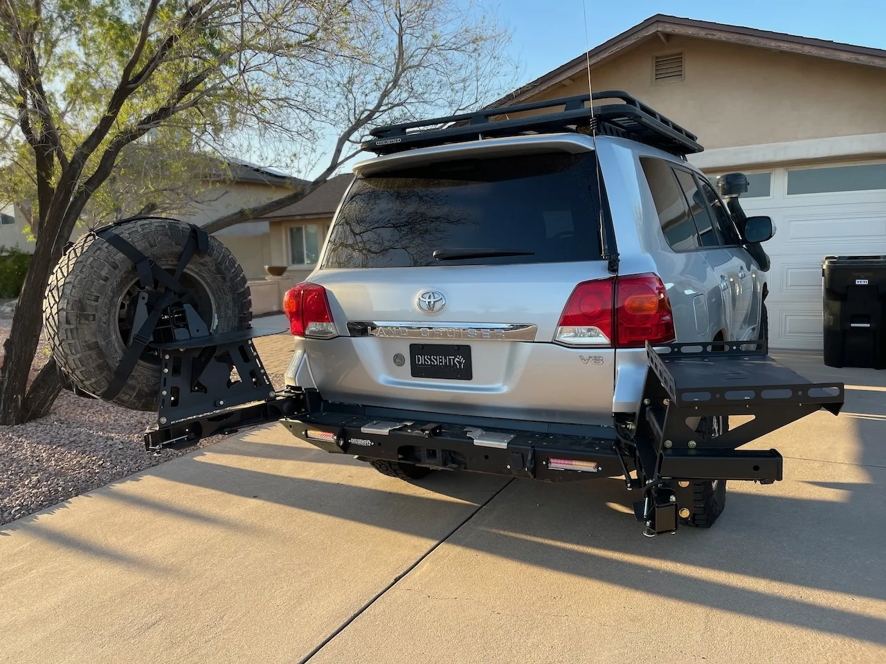

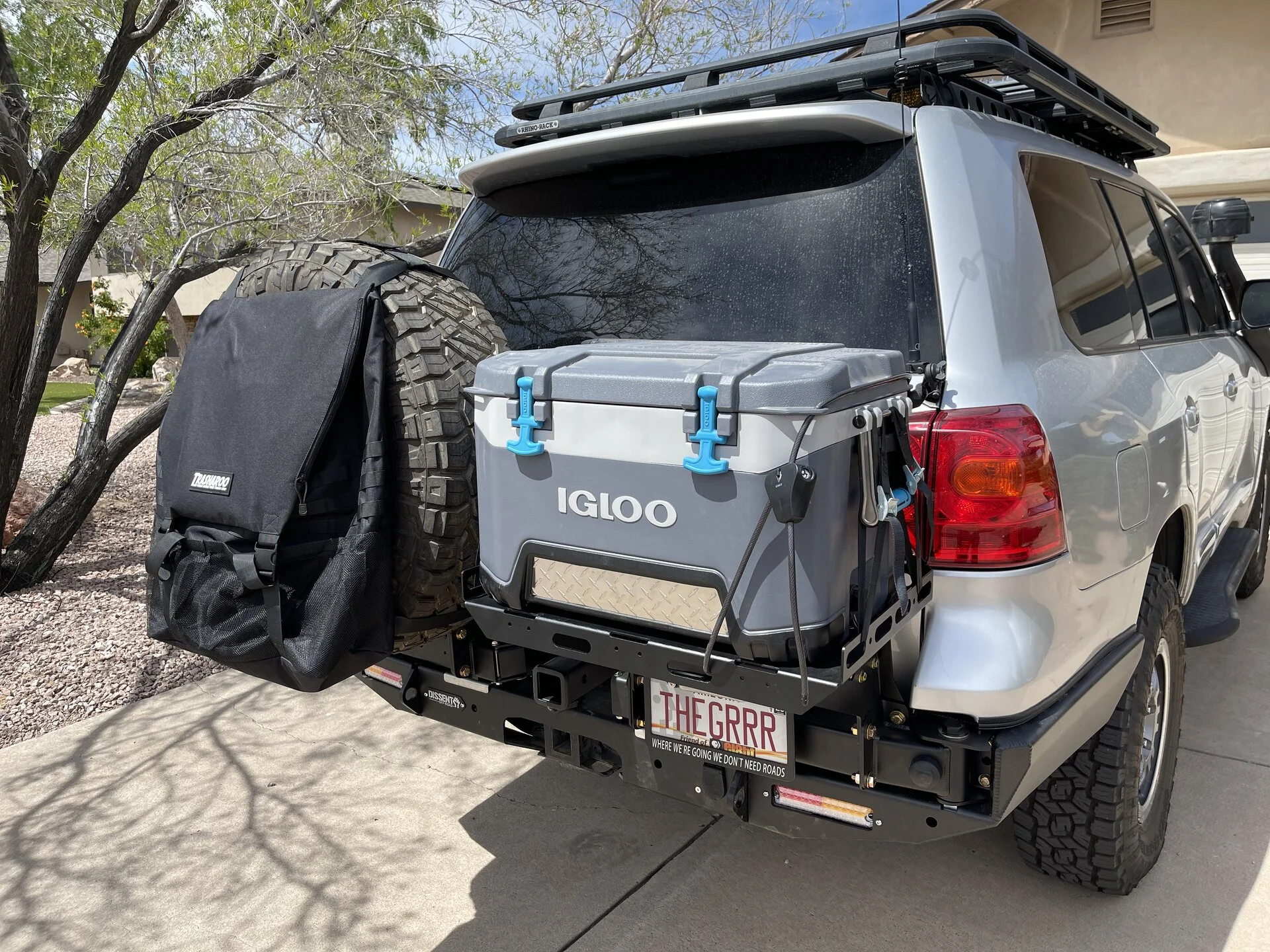

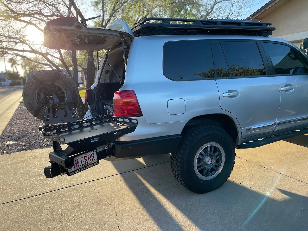

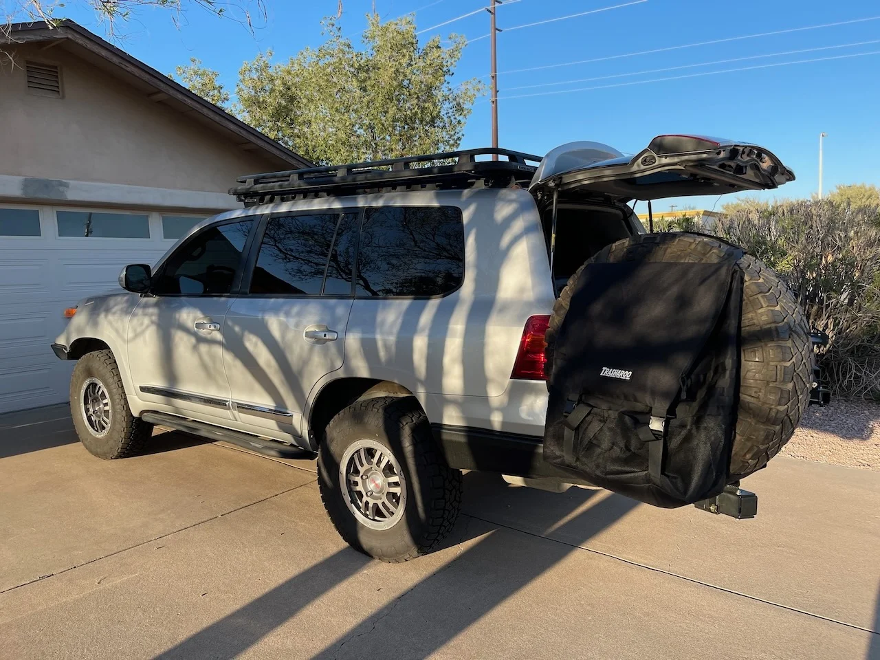

Finally have a way to carry my Trasharoo and my cooler. 😉

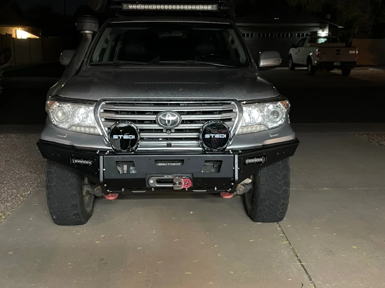

All the goodness...

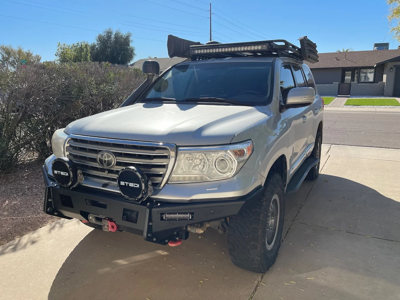

Oh hell why not show some more of the front too?
Nice looking back side. :p:p

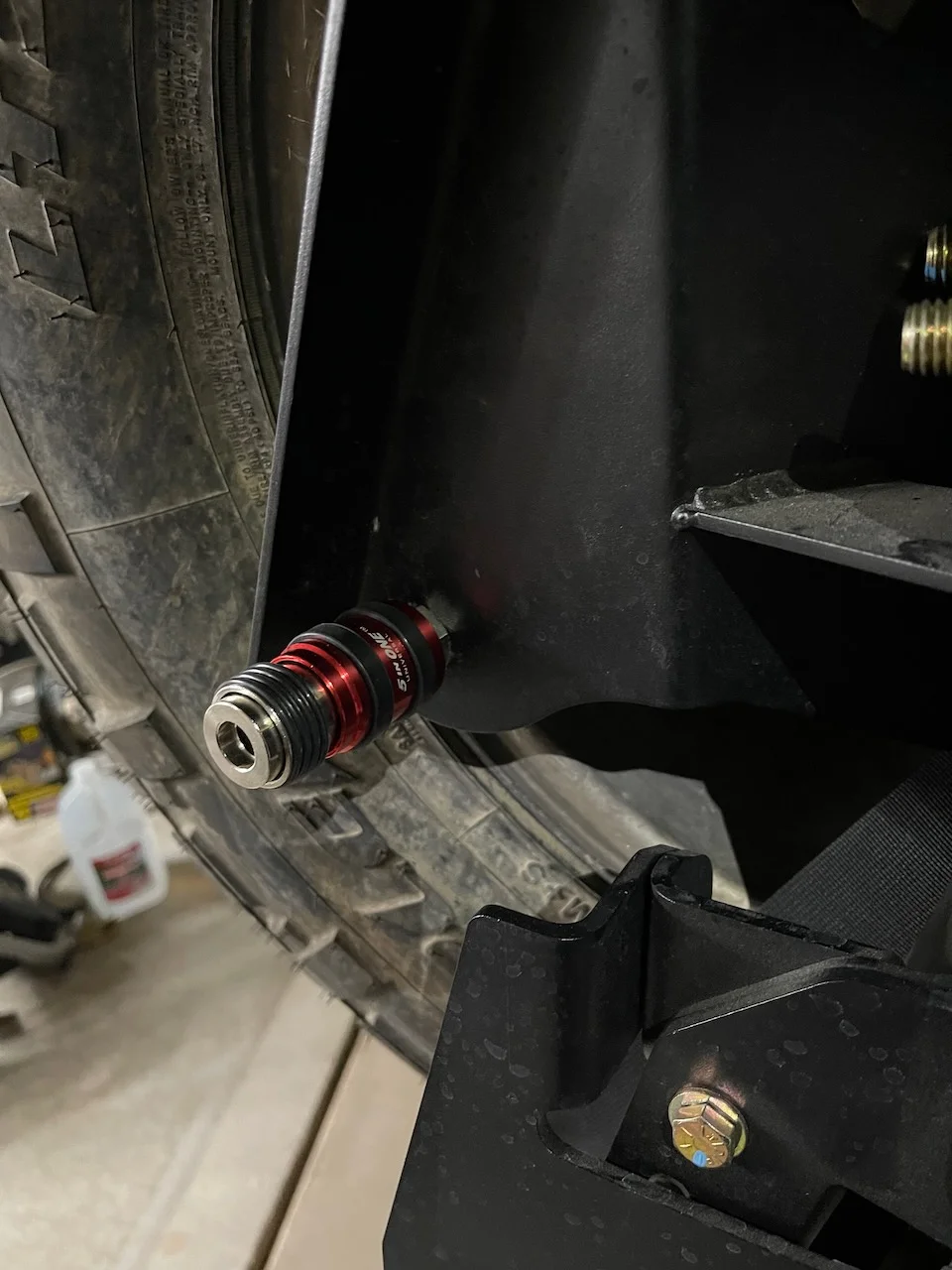

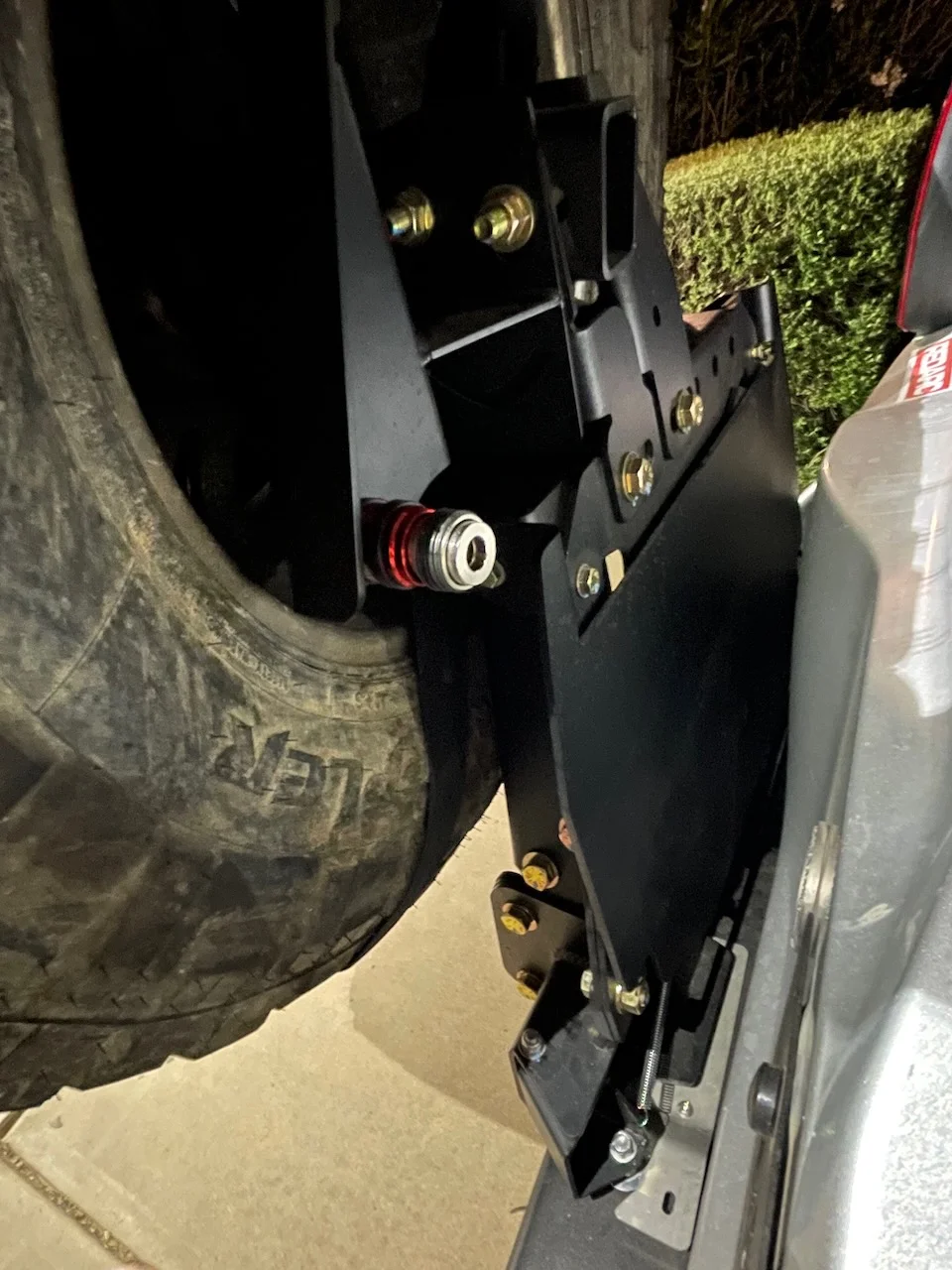

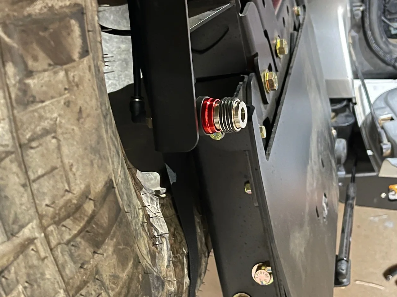

Added an air quick connect to the spare tire swingout. I have the hi-lift bracket but don't cary a hi-lift so there was a perfectly sized hole right there to mount into. No drilling, cutting or anything. Just a quick connect, a corresponsing NPT to push connect fitting and some air line to connect into the existing air lines. This was like a 10 minute job since I already had my original quick connect in the tailgate. Its still there and functional, I just installed a T fitting in the line and added a short run for this guy.

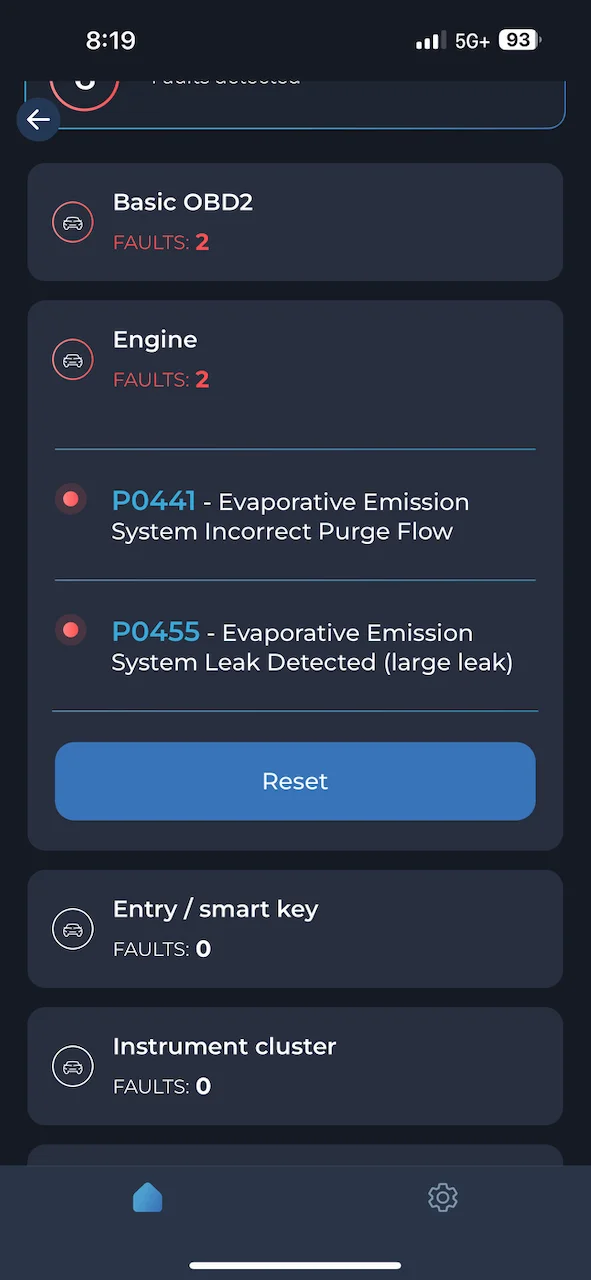

Joined the P0441 and P0455 club this week...
A new charcoal canister and a new gas cap for good measure later and I'm all good...
My aftermarket warranty runs through October 5th, 2023 or 125,000 miles. For the first time in recorded history, the CEL and trouble codes showed up a few days BEFORE the warranty expired, not after. They covered it.
I think that brings my total covered repairs to: ~$4,000 on a $2099 warranty all of which took place between 89,000 - 124,000 miles over the course of 4 years.
Those warranty repairs included: Valley Plate Leak, SAIC Pump and Charcoal Canister
During that period the radiator had begun visible cracking but did not fail, so I replaced it out of pocket.
The reason for the fuel line item on this most recent invoice was that I didn't realize two things:
  1. The charcoal canister is accessible without dropping the tank or even the skid. My spare tire is on a swingout so the canister was readily accessible.
  2. For the various evap tests to run (even when triggered manually in TechStream), the fuel level must be between 1/4 and 3/4 tank.
I wanted the leave it close to empty in case they had to drop the tank.
You do not have an LRA right? But have had recent gas boiling. Correct?
I’m about to drop my aux tank and move it over to my new one. I have thought about replacing the charcoal canister as PM but I don’t think that will really do much as the new rig has been only in grocery service and I doubt has seen much of any boiling.
No LRA on my rig. Gas boiling has been an issue for me at every Cruise Moab, LCDC and any other event where I'm spending considerable time moving slowly in 4L, at elevation, where ambient temps are over 75f. I think the conditions/heat build-up cause the gas to boil but then the vapors overcome the system and cause damage to the canister, in turn making the canister is less effective and then the boiling gets worse. Vicious cycle. With the new canister in place, I'm also making efforts to reduce the opportunity for heat to build up in the first place.
I'm curious to see how much a new one helps. I'd be tempted to pickup once from salvage with less miles if it does. Also, it looks like their are two part numbers 77740-60471 and 77740-60520. I wonder if there is a difference?
