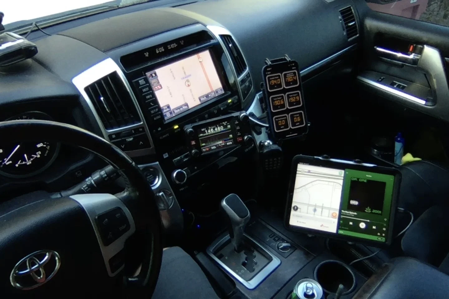

LCDC 8 Preparations:
Mounted up the iPad Air (wifi only) and added 4G LTE Hotspot and Bluetooth GPS in support. Running navigation (Waze, Google Maps (with download maps for offline, OnX Offroad (with downloaded maps for trails), entertainment (Spotify mostly) and Garmin PowerSwitch (Lights and Lockers) on iPad. Streaming audio from iPad is delivered over vehicle bluetooth.
This frees up my phone for displaying additional gauges via OBD Fusion and generally making the phone more available for taking photos and other tasks without disrupting navigation, entertainment etc. This is particularly useful on the trail when exiting the vehicle and wanting to have phone handy without having to get everything set back up upon getting back in the vehicle.
Escort Max 360 is also connected via bluetooth to the iPad so alerts are audible over the vehicle audio system and not drowned out by music.
HAM radio is the same setup for the past year-ish having moved from the Icom 5100a to the Yaesu FTM-400XDR for better APRS functions.
Sorry if I missed but can you post the info and pics of how you have the iPad mounted?

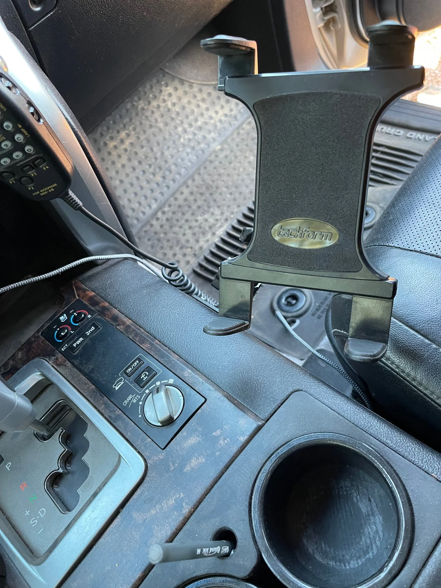

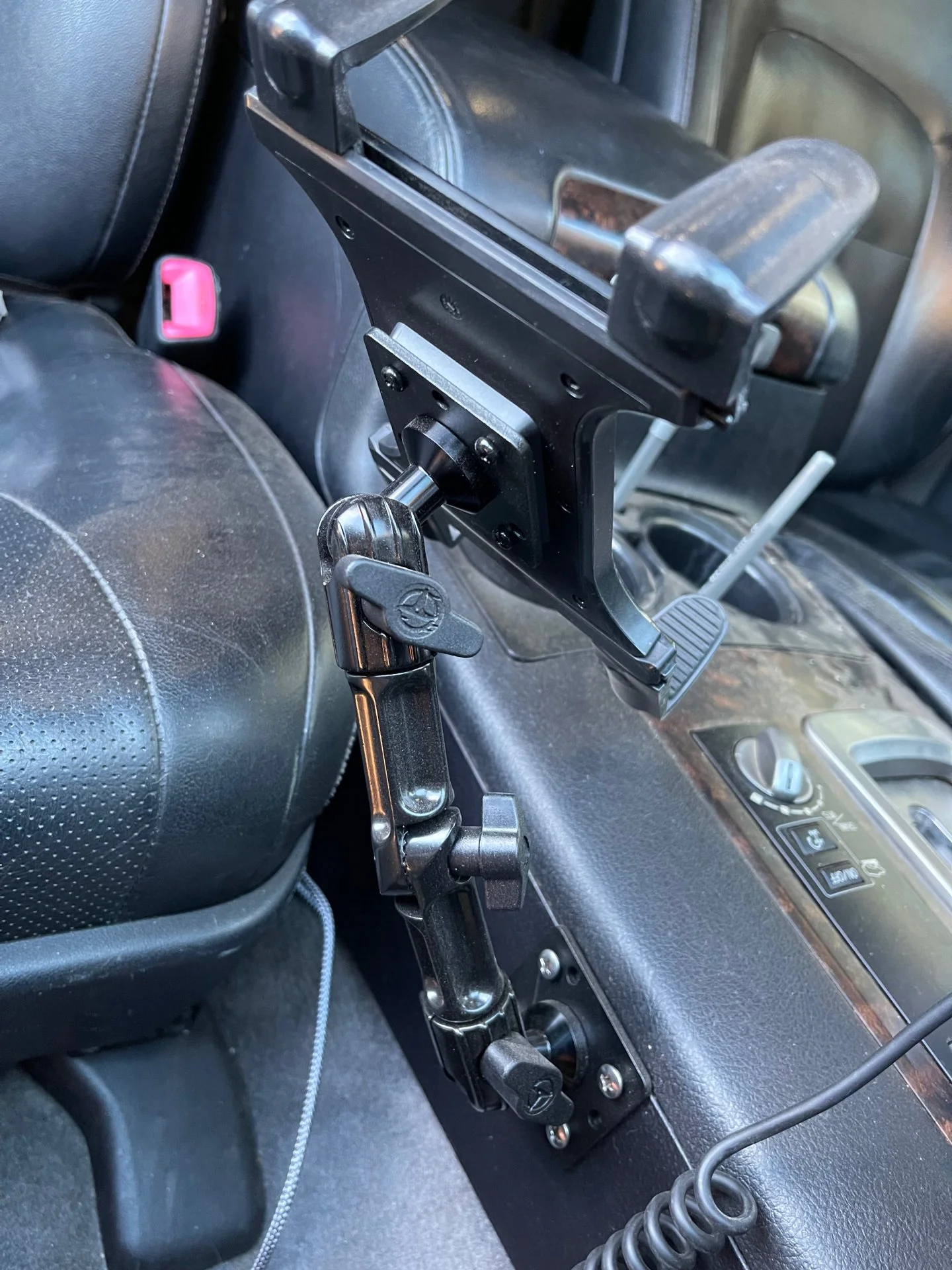

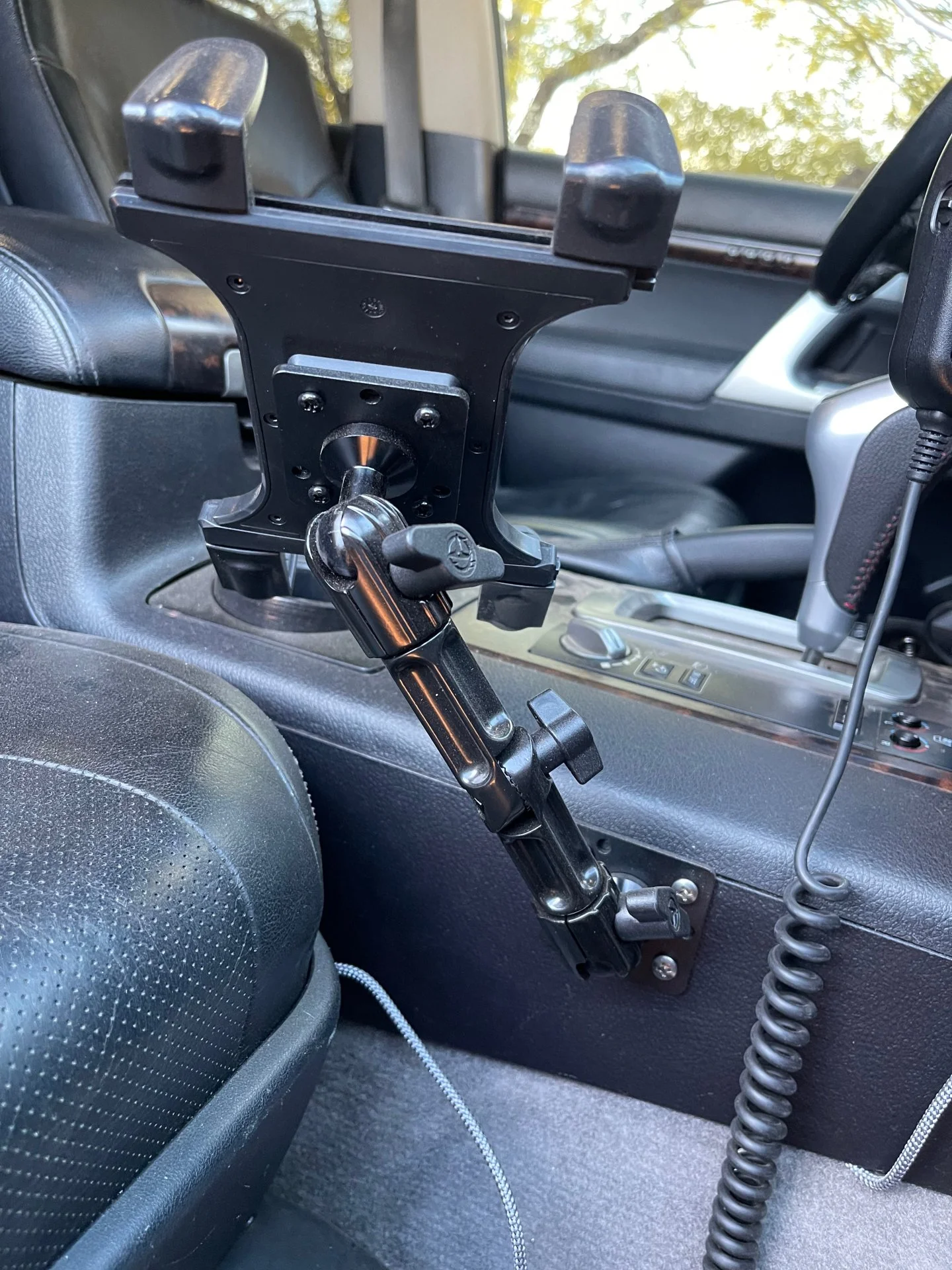

Sorry for the delayed response. The mount is just one I picked up off Amazon. This is it: https://www.amazon.com/dp/B079TGWRNR?tag=ihco-20
Here are some photos. I've been very happy with it.
Did you mount it to the plastic panel with bolts or self taping screws? I have added molle panels there not with only self tapping screws. Not sure how well that would work with something like an iPad (weight) mounted to it.
I just used self-tappers and it doesn't move. So far very solid even off-road. I think the positioning of the weight is a factor. I wouldn't want the arm positioned to where the weight of the ipad was putting a bunch of leverage on the mount. As it's used in my vehicle the weight is pretty close to being directly above the mount, which applies a minimal amount of leverage.

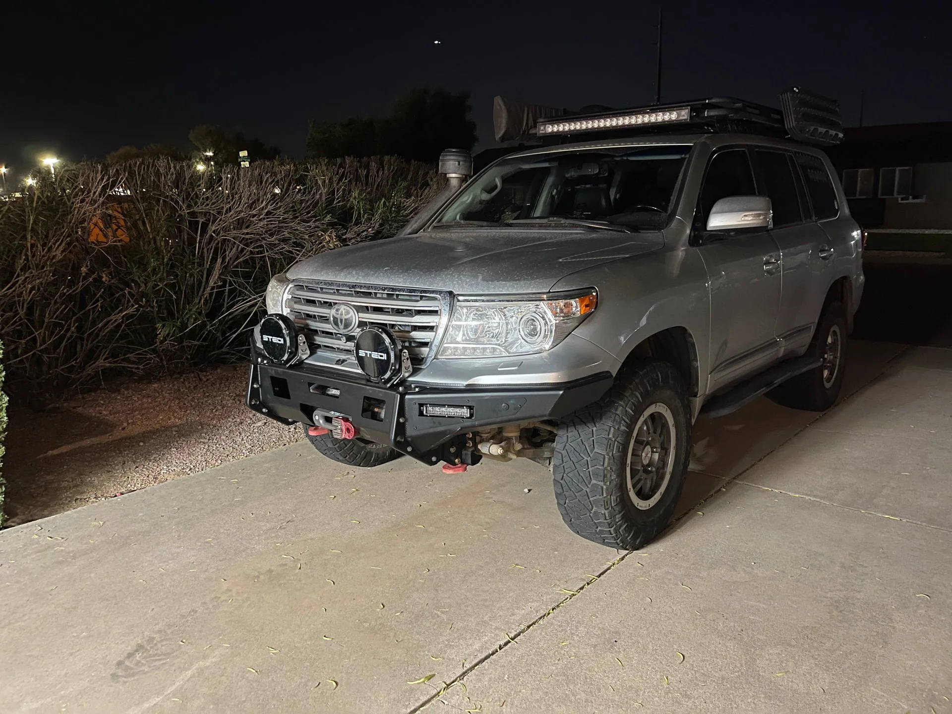

Dissent bumper installed yesterday. I need to make some adjustments to allow for flex, but I'm very happy with it. More pics after adjustment and better light. And yes, I will remove the tow hooks. My install guy threw them back on because he wasn't sure what I wanted.
Looks really good. How do you like those Stedi lights?
I haven't had a chance to use them much in the wild but I have high expectations for them. The Aussies seem to love them and I am extremely impressed with the build quality, brightness and light pattern. The packaging even rises to whole new level. Lots of customization options with colored lenses, different lens covers and colored accent rings. STEDI is doing a lot of things right.
My father runs the Stedi lights on his Gladiator and he's been very impressed. Dissent front looks great!
