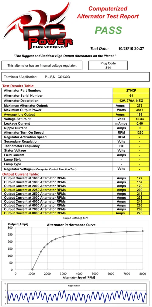

I’ve got some preventative maintenance upcoming now that I’m at 128k. The list for next week includes:
  • DC Engineering XP High Output Alternator (270 Amp) - Should drive the 50a DC-DC charger well enough to keep the 2x 100Ah Lithiums charged nicely while also giving the X2 Power AGM in the starting position the voltage it likes.
