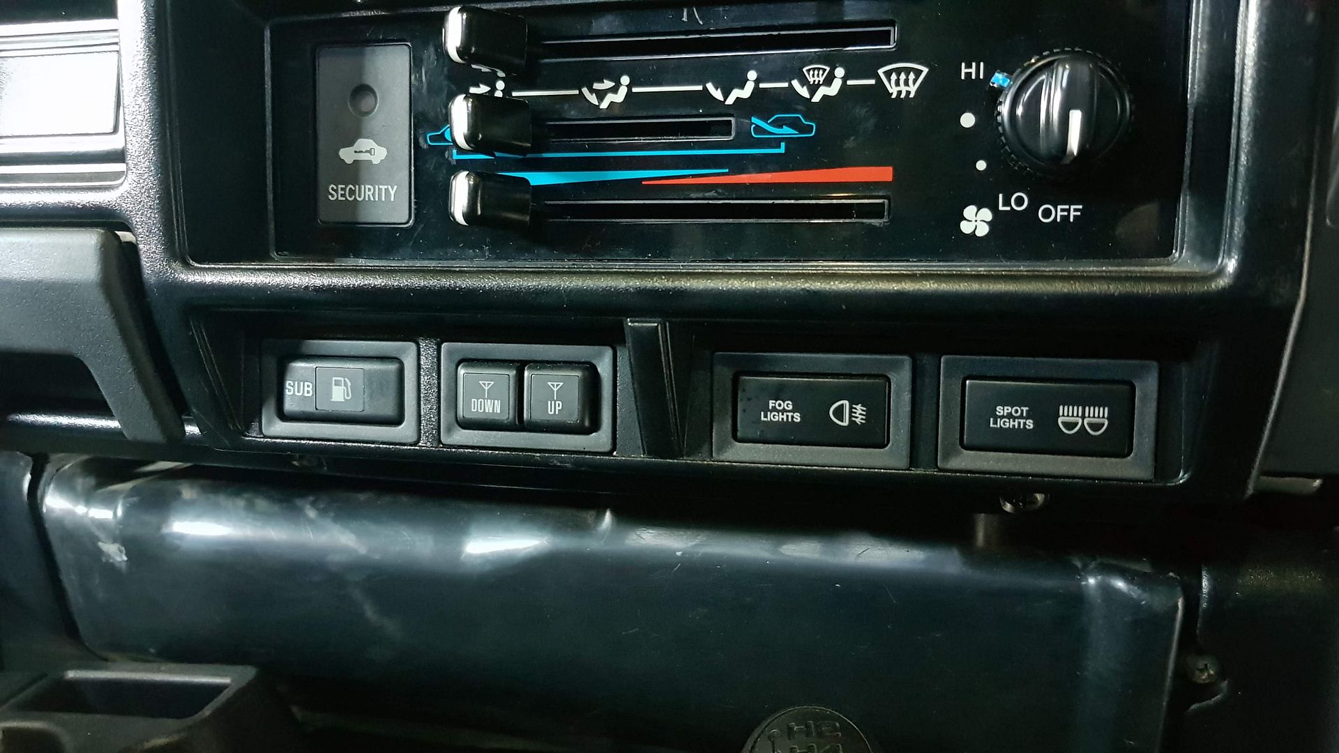

Just got our 80 last month. We're adding lights and need switches. Surprised there's so few choices for 80 switches. I've searched and read numerous threads here.
Prefer push button. CH4x4 rockers won't work because we have wood trim so too thick.
Read thread where FloridaFJ80 was selling the CH4x4 rocker and push buttons.
He said push works for 80,(see post #12), but when I looked at CH4x4 website it says no.
Toyota Dash Rocker and Push Switches
Anybody know for sure?

Wondering if anyone knows the stock switch size... is it 42mm X 24mm? If so, a lot of other, lower cost switches are available... such as the attached.
That is correct. See attached file for dimensions. What is the source for the switch you posted?
Fleabay! I bought it last night as it was such a good deal and included the pigtail.
Thanks for the info! I have some JDM lc switches I'll eventually post up too.
Although they aren't sexy new switches, I found a number of people selling 3 packs of RAV4 switches on eBay. (Hazard, ECT, rear defrost) I wanted a hazard switch to use as a center diff switch when I do the "pin 7" mod. I figured I'd use the other two as light switches. I found the wiring for the defrost switch in this thread. Help wire factory defrost switch to fog lights... I didn't find a similar diagram for the ECT switch. While hunting for the ECT pin-out, I did find a post mentioning a Toyota fog light switch. Toyota OEM Fog Light Switch

Picked up a few at the scrap yard this weekend:
  • Oak, leather textured switch blanks from a 3rd gen 4runner (texture runs vertical, good match for center console, can also be found in grey)
  • Oak, leather textured switch blanks from a 1st gen tundra (texture runs horizontal, looks out of place on center console)
  • Vertical Oriented OEM Security indicator from a 95 Camry (LC security switch is horizonal)
  • Up/Down Rear Window switch from 3rd Gen 4runner
  • On/Off Rear Window Heater switch with orange indicator light from a 3rd gen 4runner
  • On/Off switch labeled "ECT" from a 3rd gen 4runner (no indicator light)
  • Hi/Low rear heater switch from a 3rd gen 4runner (no indicator light)
The great thing about these 4runners is that they are EVERYWHERE in scrap yards. Also, you can easily access some oem green bulbs that are behind the climate controls if you need one for the D light on your gauge cluster.
