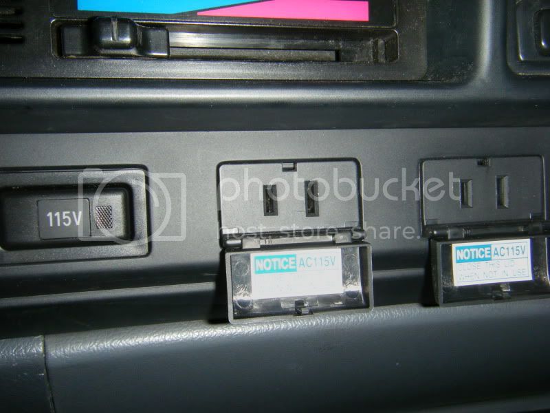

Not sure of the year or part number but some Toyota Matrix cars came with an outlet and 115 volt switch that likely powered a hidden inverter. It appears that these would fit 80 series dash openings but not confirmed.
Yes, they do indeed fit...and work!
