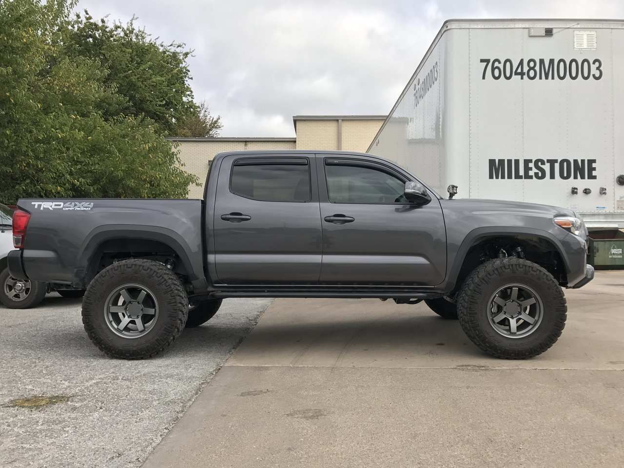

yep, zero offset 17 inch Methods with 35 inch Treps and bigger bumpstops, if ya wanna do trails like the Rubicon this is the recipe in my opinion!
+25 methods with 1.25 inch spacers. Put spacers on for wheel change to steelies same day. Driving near zero offset to the tireshop was rubbing like crazy even with pinch weld mod. I run 34.2's 295/70/18
