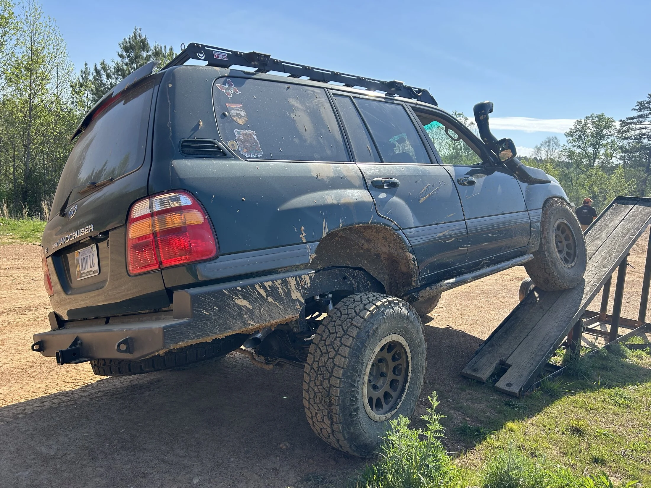

Here are some measurements for the rears.. Just went wheeling and there is definitely a lot more articulation with an inch and a half more extension in the rear. Also this was me trying to get more articulation in the rear. Just because more articulation does not mean they will ride nicer but I think the OME ride like crap compared to the icons and on paper all other options listed are nicer than the icons.
