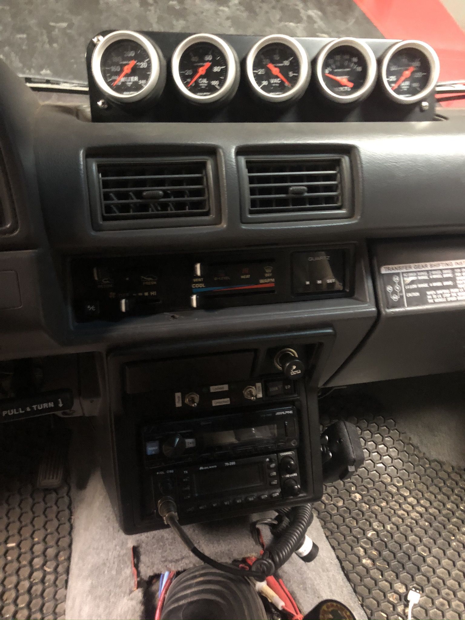

Hmmm.... sounds like the cable may have snapped? Regardless, I don't think it's too bad to get the HVAC control panel out. The toughest part is getting the bezel off without breaking it, it is VERY fragile!! Pull the 4 knobs off first, then you pry on one side (can't remember, I think the passenger side), get it unhooked, then carefully pull it out. Then I seem to remember there are 3-4 screws holding it in. Pull it straight out, then take a look, you will probably see what is broken. Yeah, there was a spare one in the box of parts that went to Brett, maybe you still have it? They are easy to find on eBay.
Love those photos! Especially the dog, that's awesome!
Thanks Ken!
I'll look in the box of parts, I think I remember seeing one in there when I originally cataloged everything! If not I have the one that came with my A/C stuff so I should be good.
Might be a dumb question but I should probably disconnect all the other cables before pulling the old one out right?
I think it will be obvious what needs to be disconnected once you start pulling it out. There is the electrical for the A/C switch, the fan switch, and the dash light, but the connectors are right there, to the right. You might need to remove the clock as well.

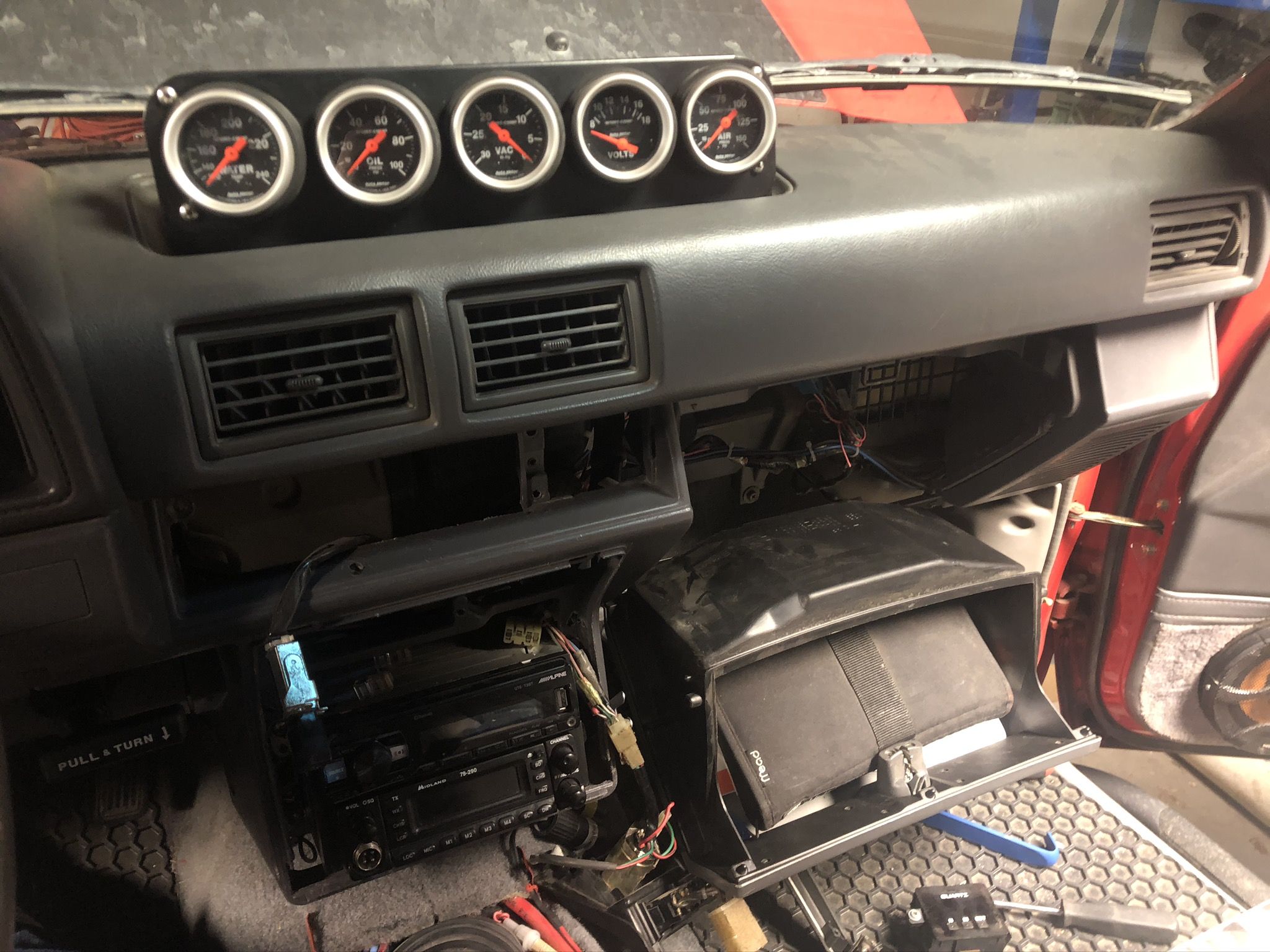

Last night was fun.

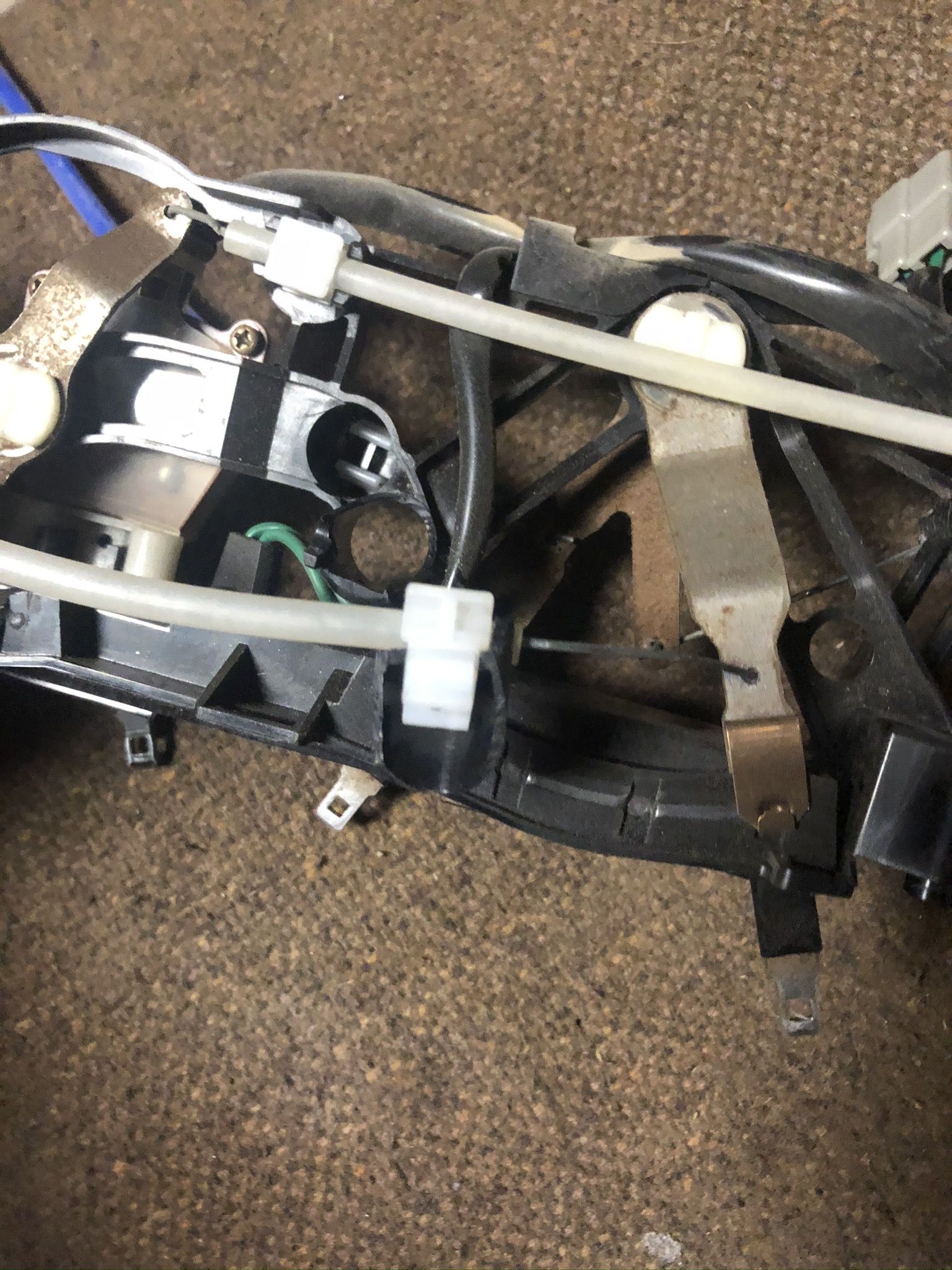

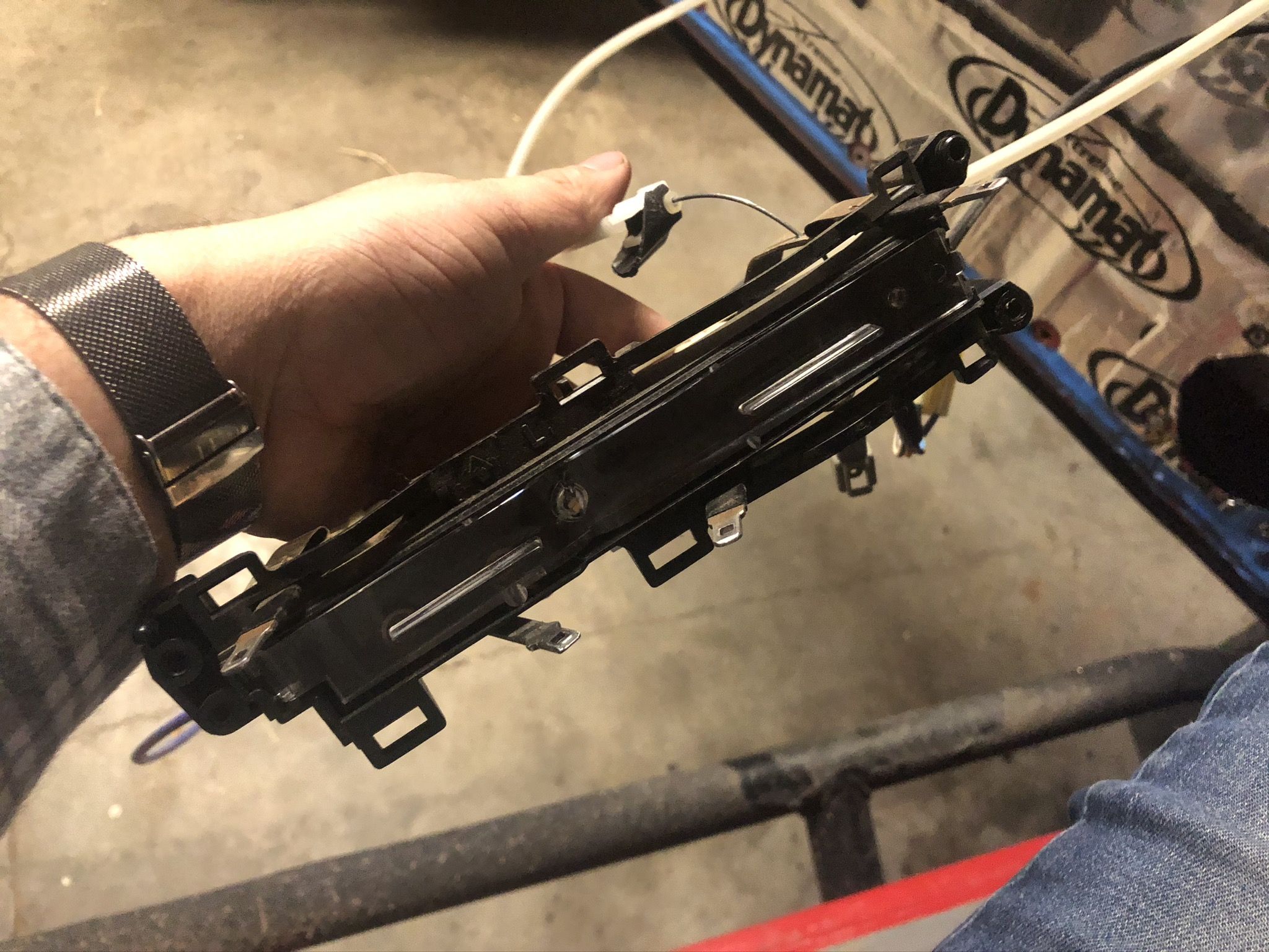

When I was up in the White Mountains before Thanksgiving I was trying to turn on the defroster and the zone changer for the climate control broke somehow. I wasn't sure if it was the cable or not but I ended up having to manually turn it onto defrost to get me by.
After a little disassembly, I found the culprit.
The cable is held on by a clip on the climate control which holds it and allows the inner cable to move when the lever does. That completely broke off.
Getting the old one out was a total PITA. Most people recommend removing the dash pad since I have the gauges up there that was a no go. You can actually get it out by just pushing it as far to the right as you can, then getting the left side past the tab and pulling it out. It's not fun at at all but once you have it out it's out.
Luckily I had a spare one from when I bought the A/C stuff so I just slapped it in and threw it all back together.
The slider is still a little stiff and to be honest I'm a little scared it's going to break again. Anyone have any tips to make it a little smoother? It looks like Ken had put some grease on the plastic sliders on the box and I greased the cable too.

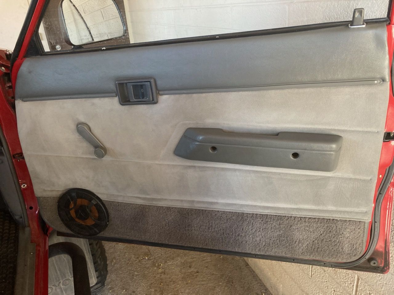

I just realized that I never documented my power to crank windows conversion! It was as easy as swapping over the regulators. I did have to put in some new bushings for the screws in the arm rest to go into, but all in all super easy swap and I am very happy with my crank windows.
I think the hardest part is tracking down some nice door panels - but I was lucky enough to find some that match the SR5 seats in the truck.

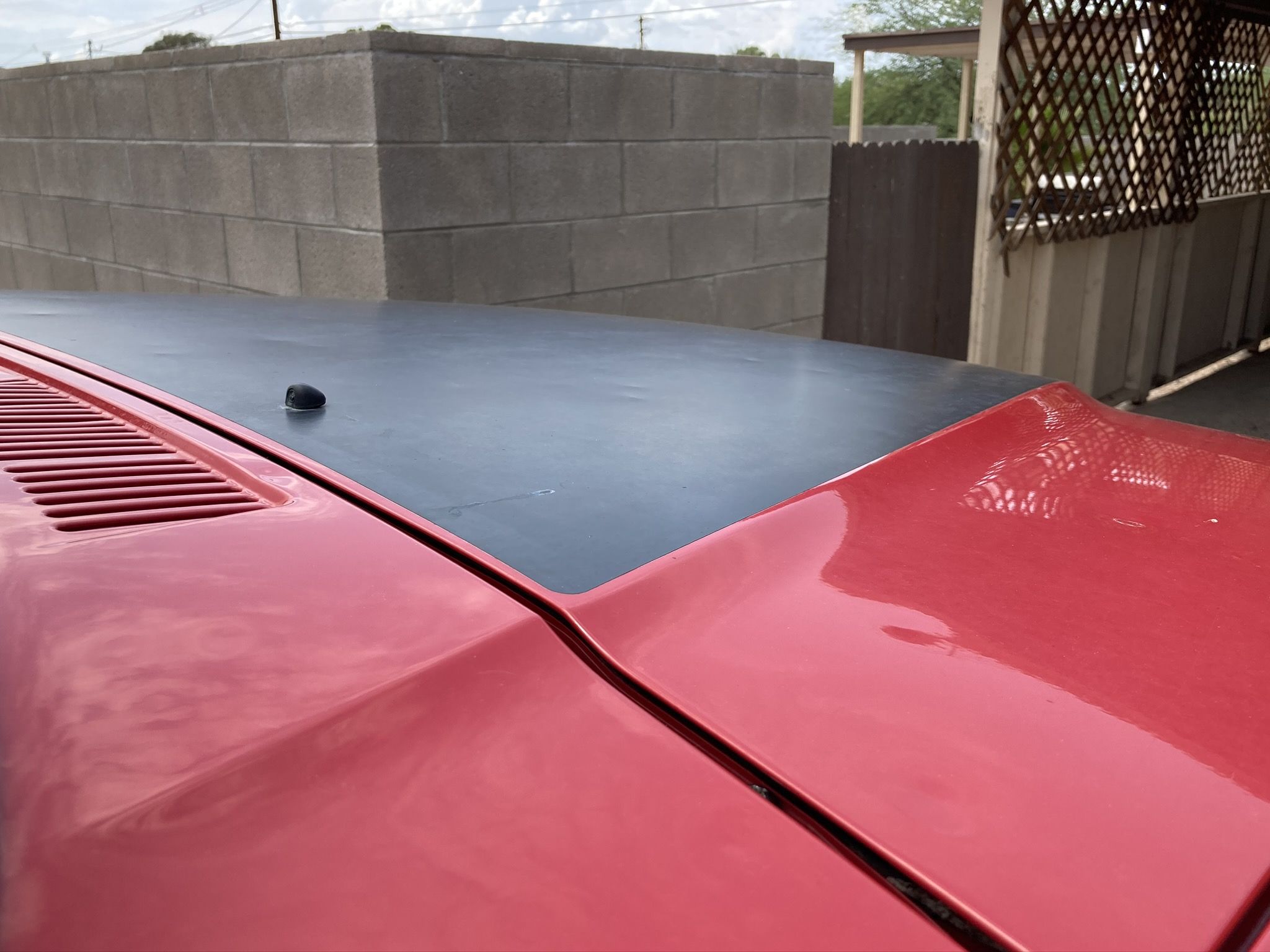

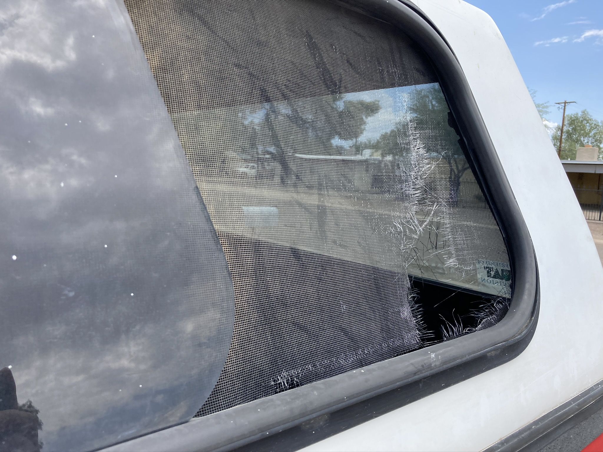

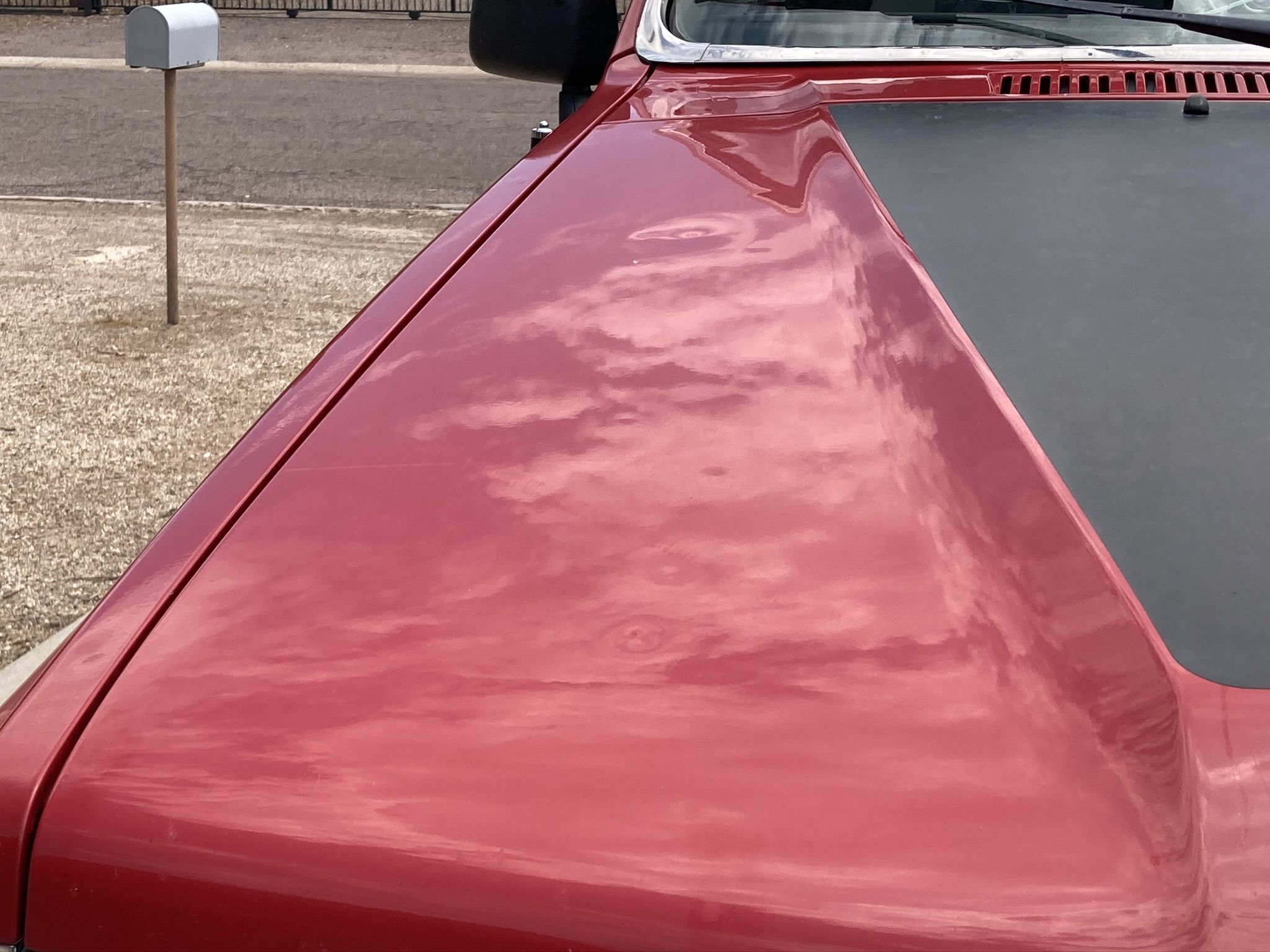

On my way back to Tucson we got caught in a massive hailstorm in New Mexico. The hailstones were literally the size of golf balls and it sounded like someone hitting the truck with a baseball bat. There was nowhere to pull off and I had to keep on driving until we got out of the hail storm. Needless to say, there was some carnage. Here are the pics I took for the insurance company. (there's a good amount of dents that didn't even make it into the pictures)
To make things worse on the way out of Safford the charge light came on and the voltmeter started dropping and the temp gauge started increasing. I pulled off on the side of the highway and saw that my alternator belt had shredded. In the 30 seconds it took me to pull off the road the temp gauge went to 240. My alternator belt had completely shredded and it also runs the water pump. I was luckily able to get a tow truck to come get the truck but due to COVID-19 I couldn't ride in the tow truck with the driver or in the truck on the back. Things were looking bleak as our closest ride was about 2 hours away.

The truck is going in to get the hail damage looked at on Wednesday and will hopefully be fixed. Will update everyone with what happens next.

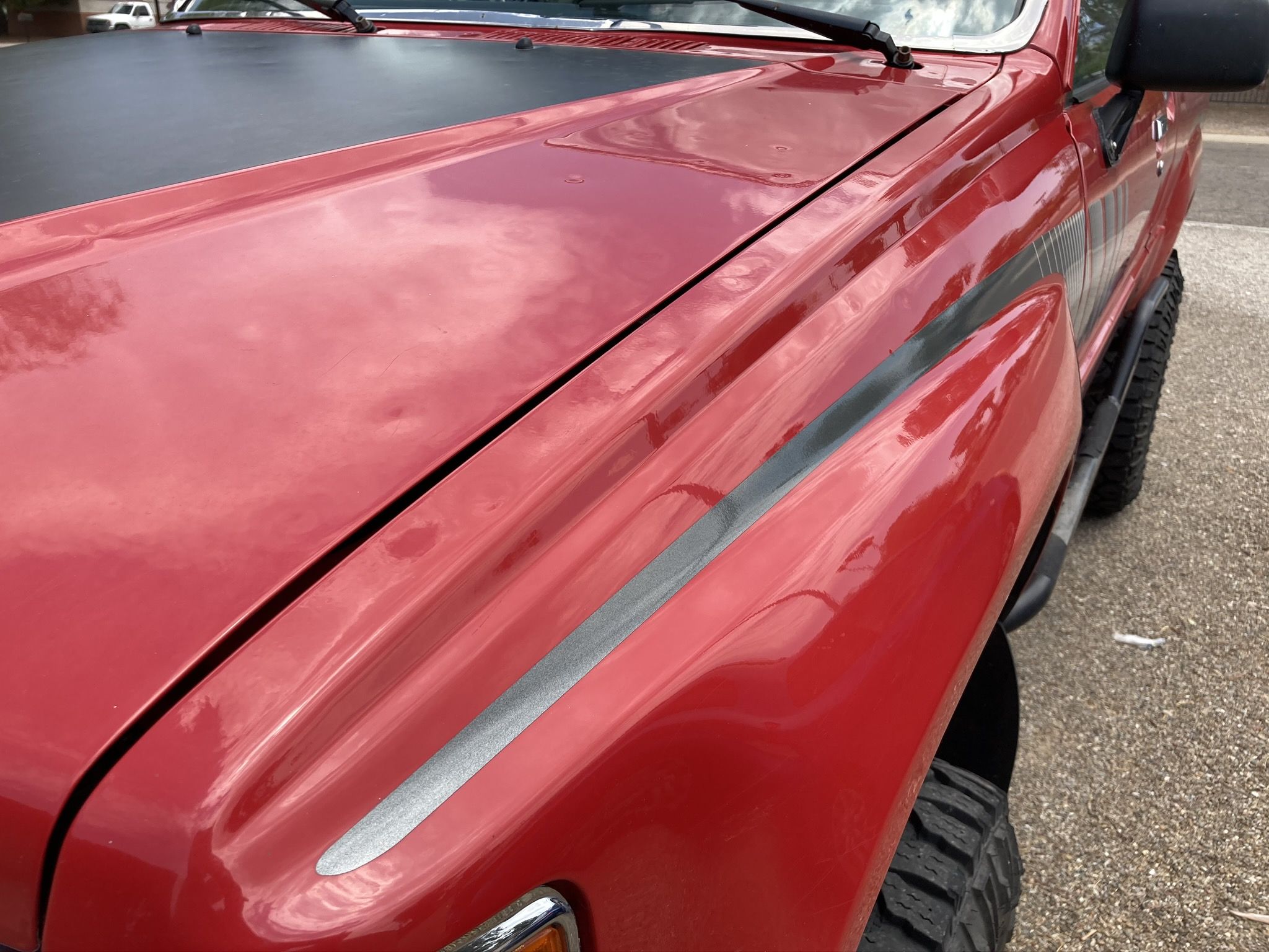

On the bright side a new paint job and more!! Hang in there
Bummer! I'm curious to know if they try and total the rig. That's a ton of damage which will most likely require either a TON of PDR or a complete paint job. Keep us posted, I've always loved KLF's rig. As far as overheating goes, what radiator do you have? 2 core? 3 core? CSF makes a nice 3 core brass/copper radiator that would solve your issues if you only had a 2 core. Also, do you have an OEM thermostat with Toyota red coolant? Just some thoughts...
