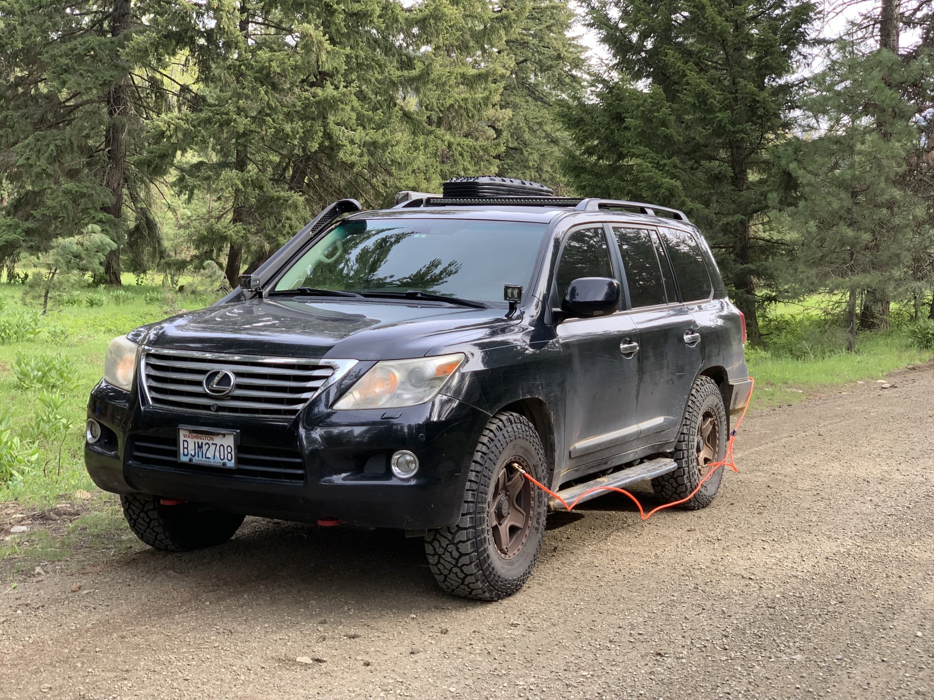

Quick one night backpack on Teanaway north fork.
Easy approach, about 20 min of mostly smooth gravel and dirt.
Aired down anyway, Apex valves are money- drop my skinny 35s from 35 to 17 in 14 1000s per wheel. About 90 seconds including walking wheel to wheel, checking the psi, and putting the caps back on.
