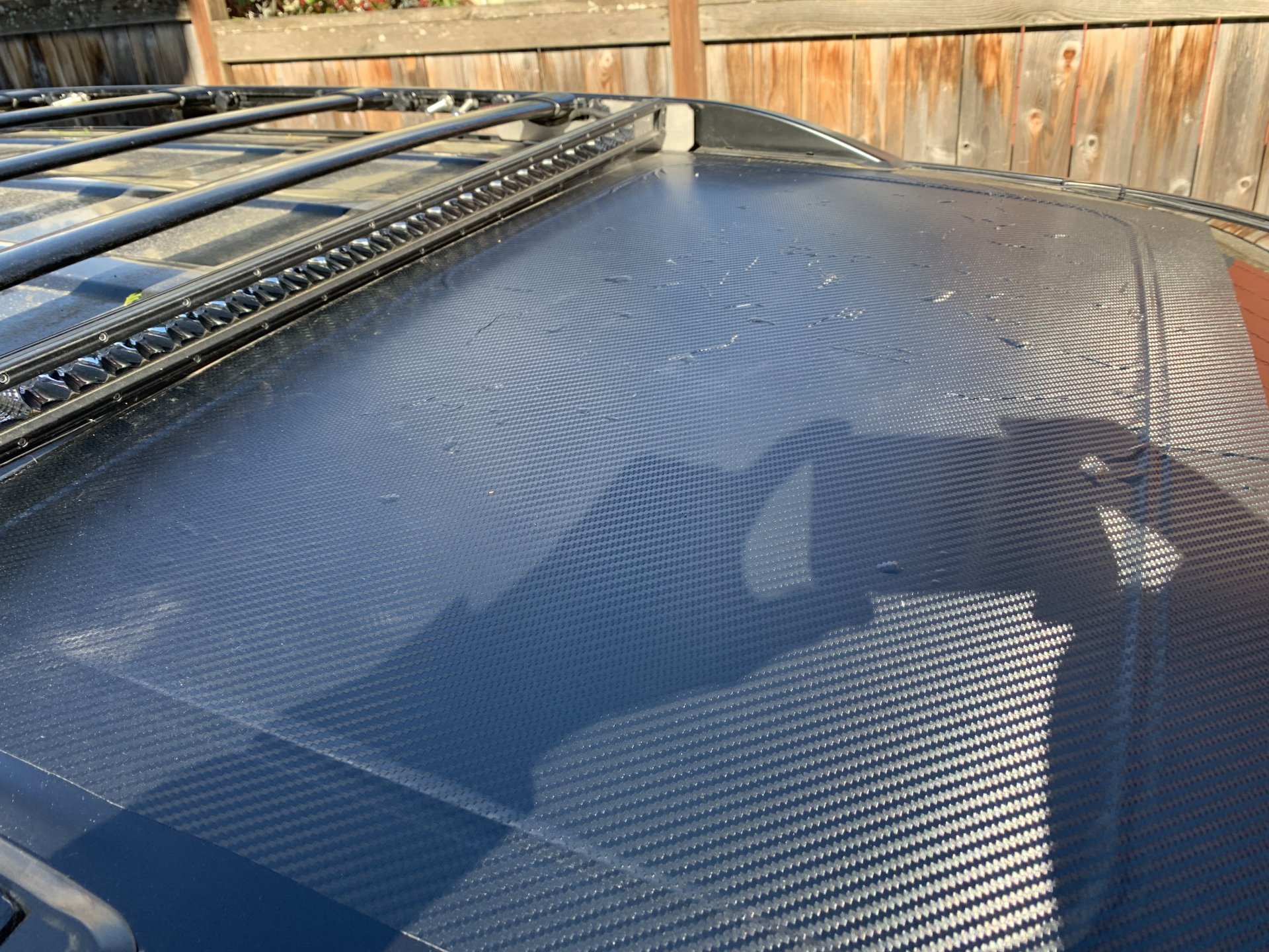

Plugging the right side moonroof drain just led to the moonroof overflowing to the right by the mechanism. It does seem to bridge and drain out the left, but not fast enough to prevent it pooling over on the right.
Sigh.
I'm going to throw a piece of vinyl over it and begin to put together a plan to fix the right side moonroof drain.

Moonroof ‘fixed’

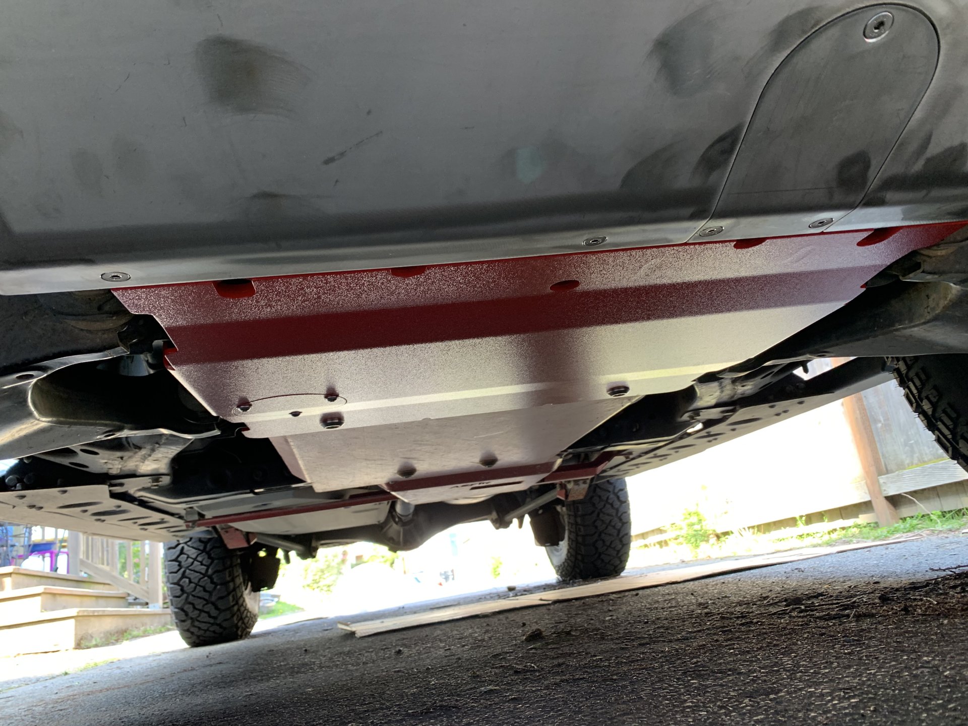

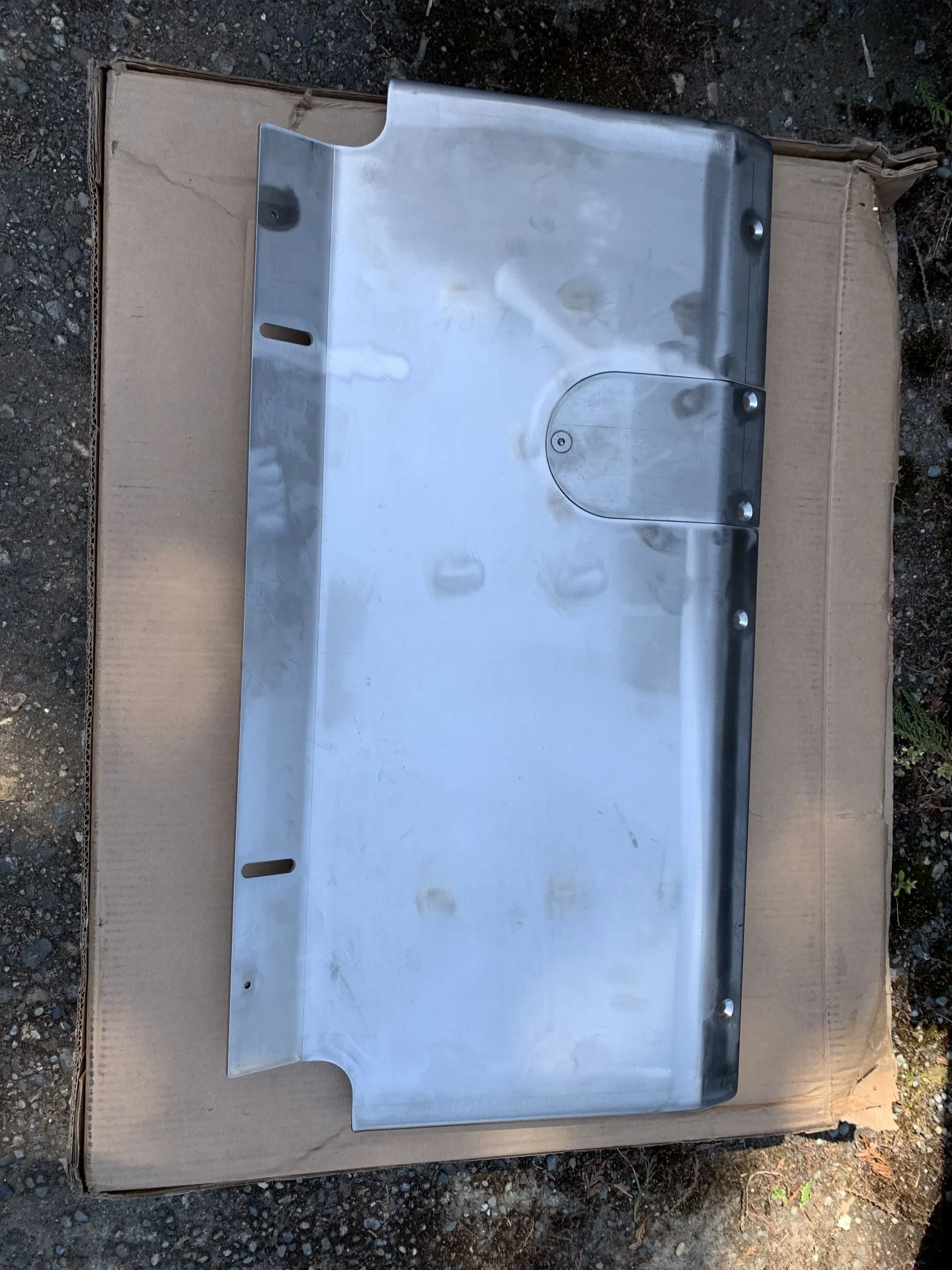

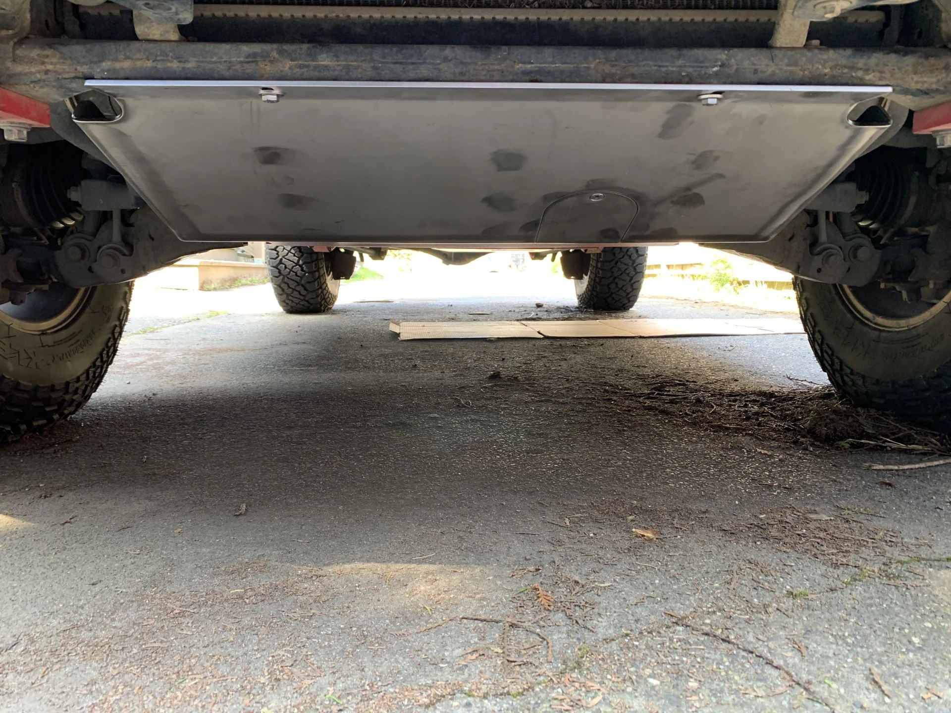

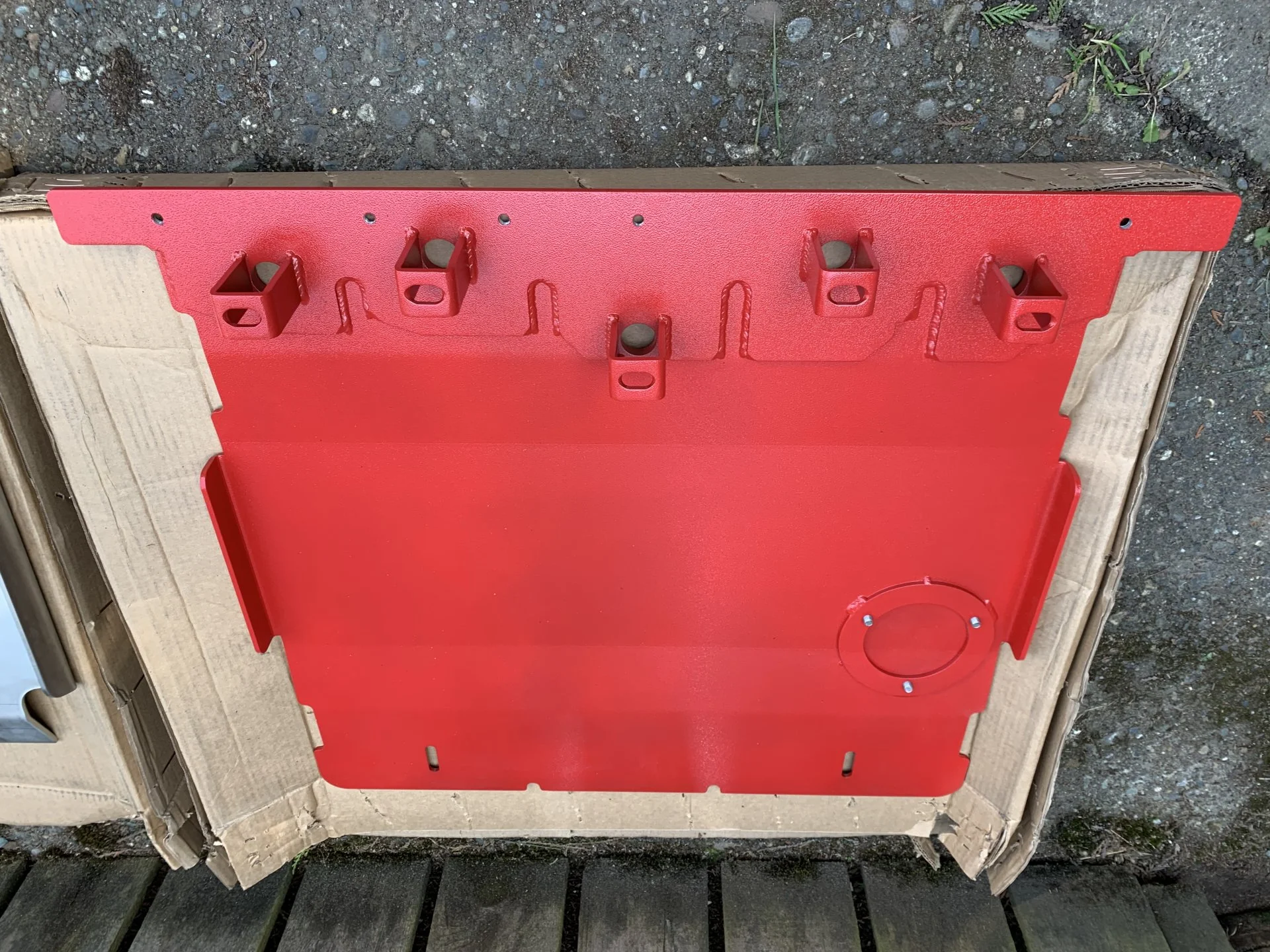

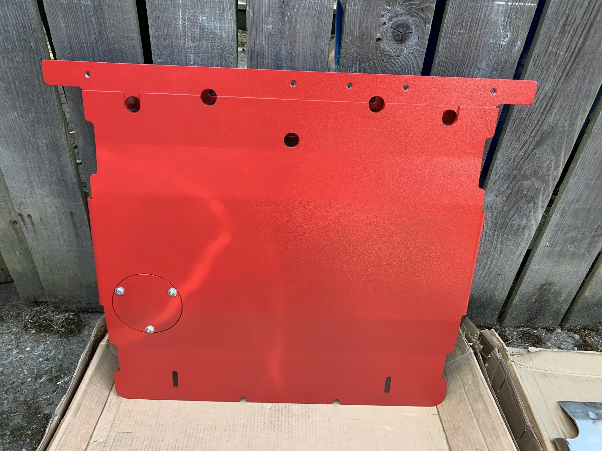

Put on the budbuilt skids today.
Front is 29 lb
Engine is 41 lb
Came with all necessary hardware and goes on easy.
Thoughtful use of the reinforcement fins on the front to hook over the engine to support while you get the first couple bolts in.
No problem at all using with the total chaos aluminum transmission skid.

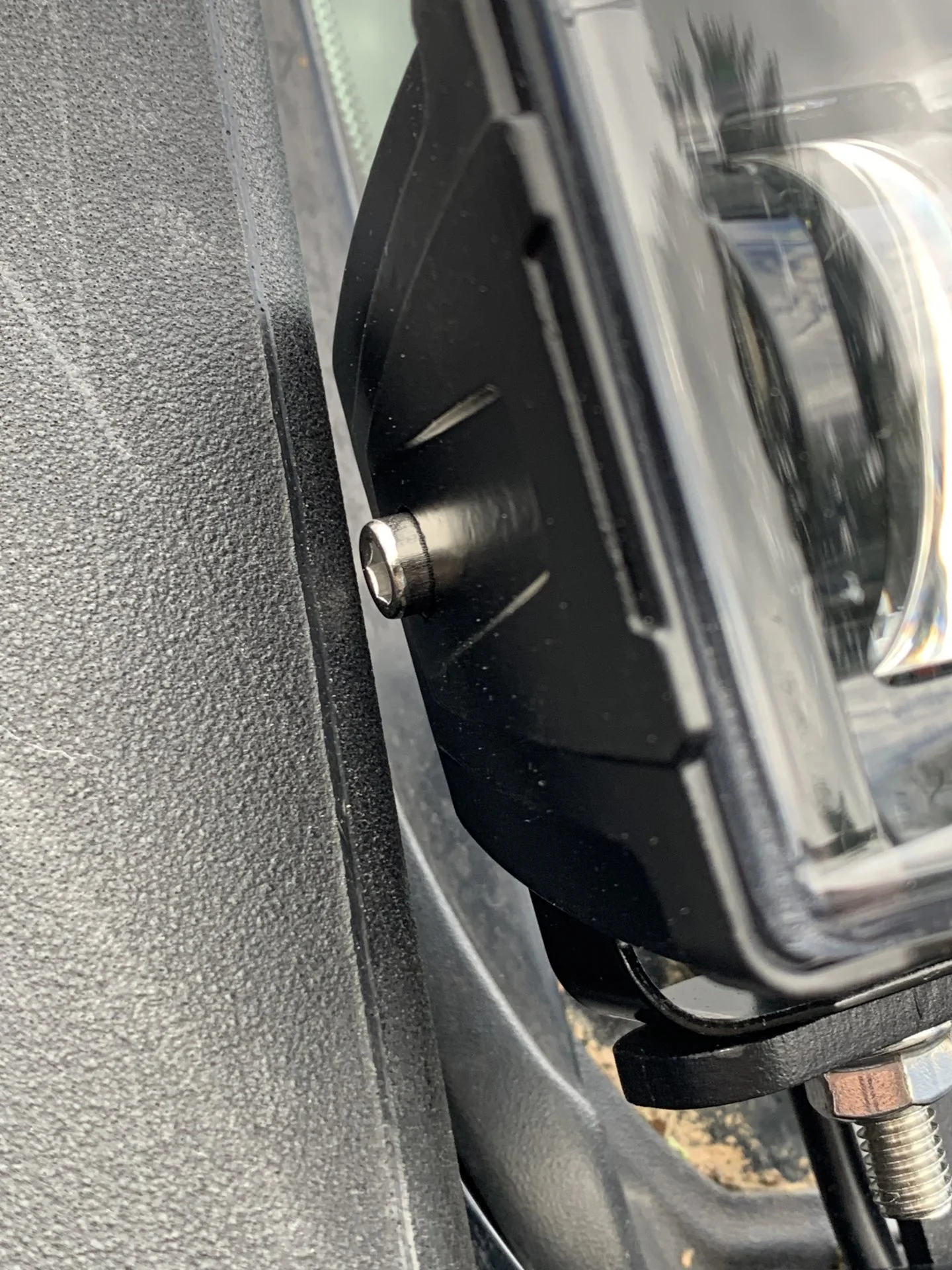

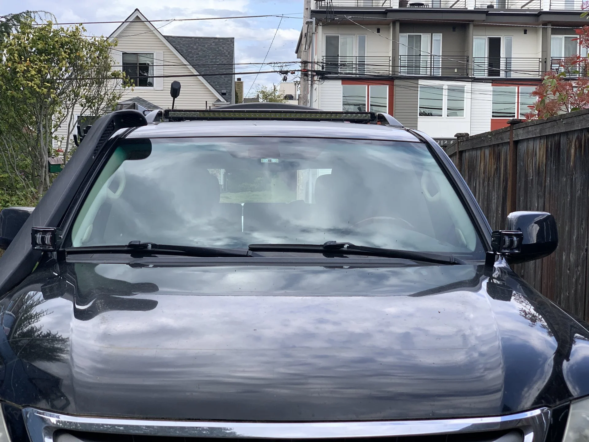

Half installed the CBI ditch light brackets and lights.
Used the plastic melt method of fitting on the cowl. Pretty easy.
Just need to run the electric, which will be on hold for the electric infra update.
They clear the snorkel and everything.

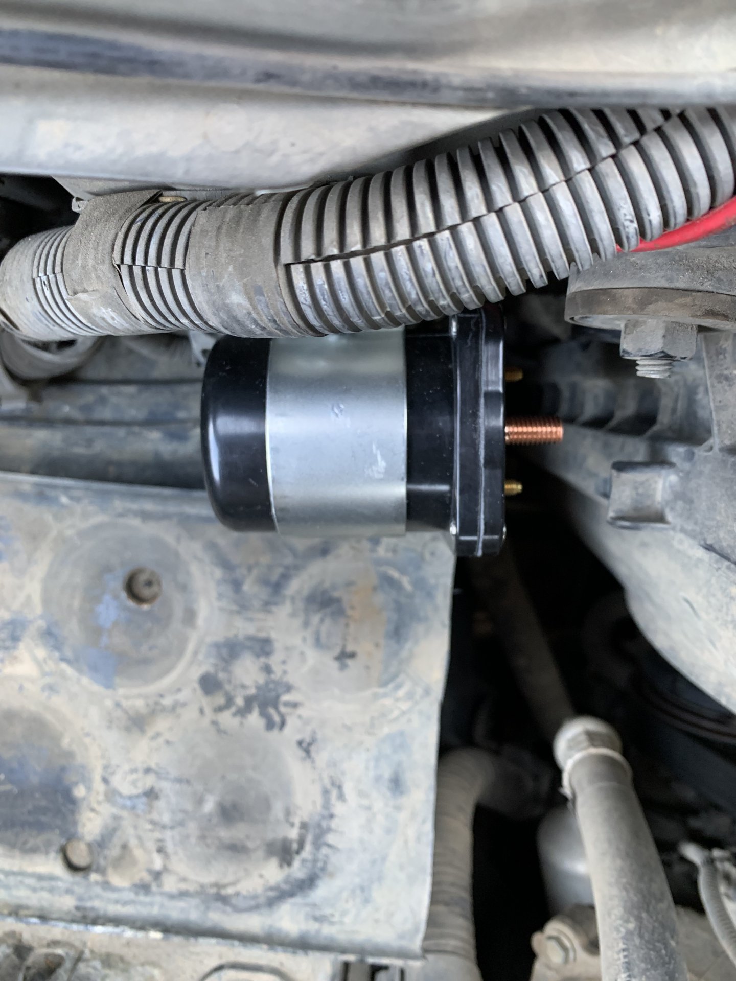

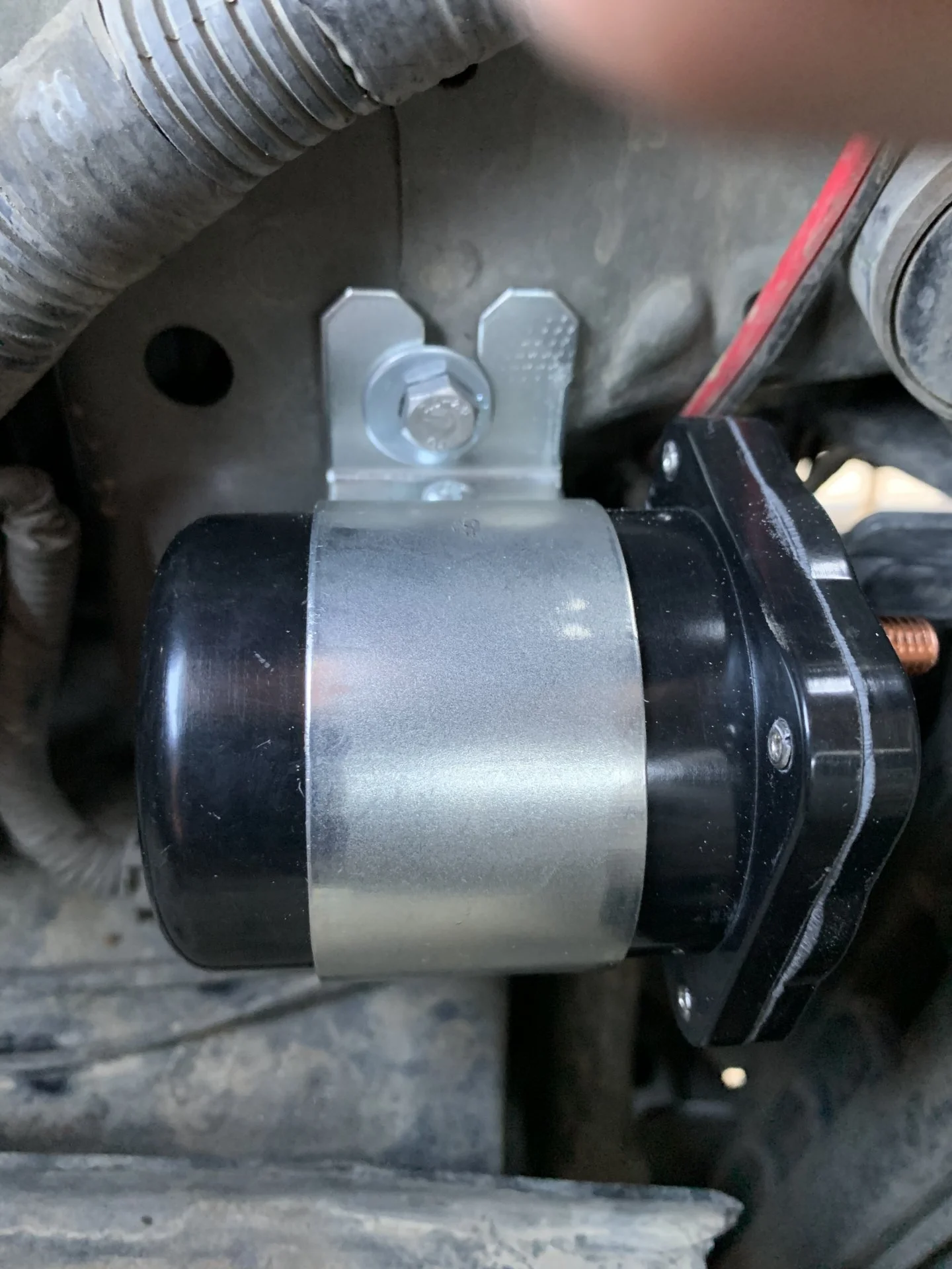

Step one was to find a place for the 500a solenoid which will be the host for the winch and other ign controlled items (air compressor primarily).
A couple existing holes in front of the battery on the vertical frame by the radiator we’re happy to host a couple rivnuts.
Some light Modification of the solenoid bracket and mounted it was.

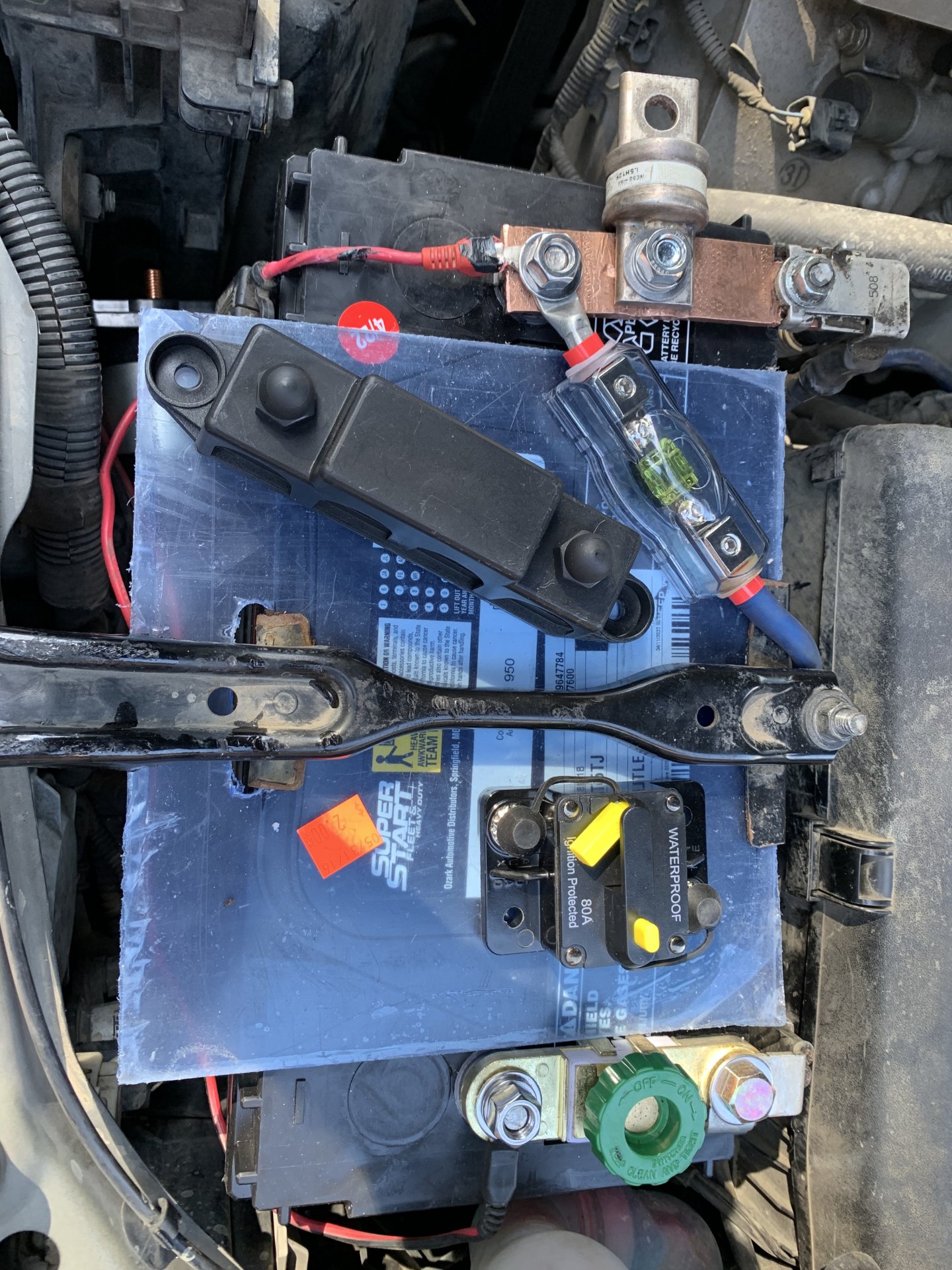

Moving right along. Fuse for solenoid mounted and a plan for the positive distribution (neg block was easier to grab).
I’ve got a piece of plastic to mount the battery top items identified, but will have to run down some countersink bolts to use it.
Trying to avoid using the top of the fuse box, I suspect I’ll need that area for something else.

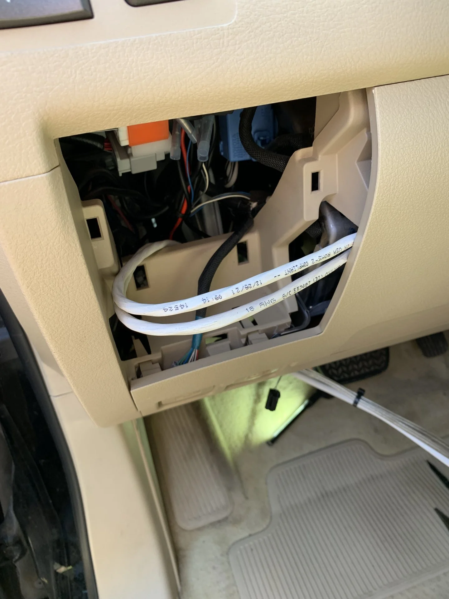

Good progress today deciding where I want the light switch panel, and then getting that wire (6 items) and the wires for the other switches I put in the cubby/console (5 switches need 8 wires) as well as four spares for future proofing thru the left / driver firewall grommet.
Was dreading it but actually only took a couple hours. Didn’t even have to move the compressor.

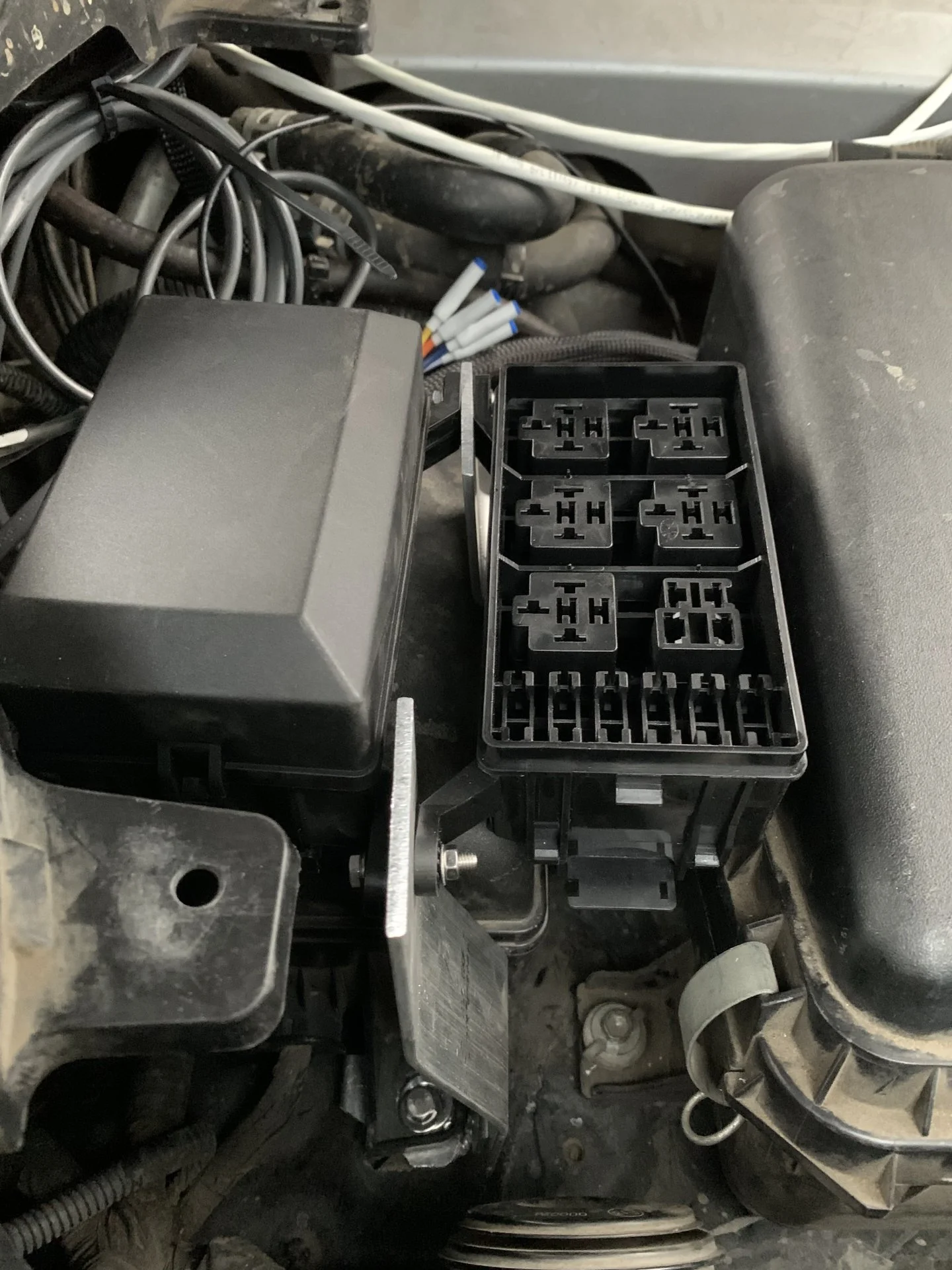

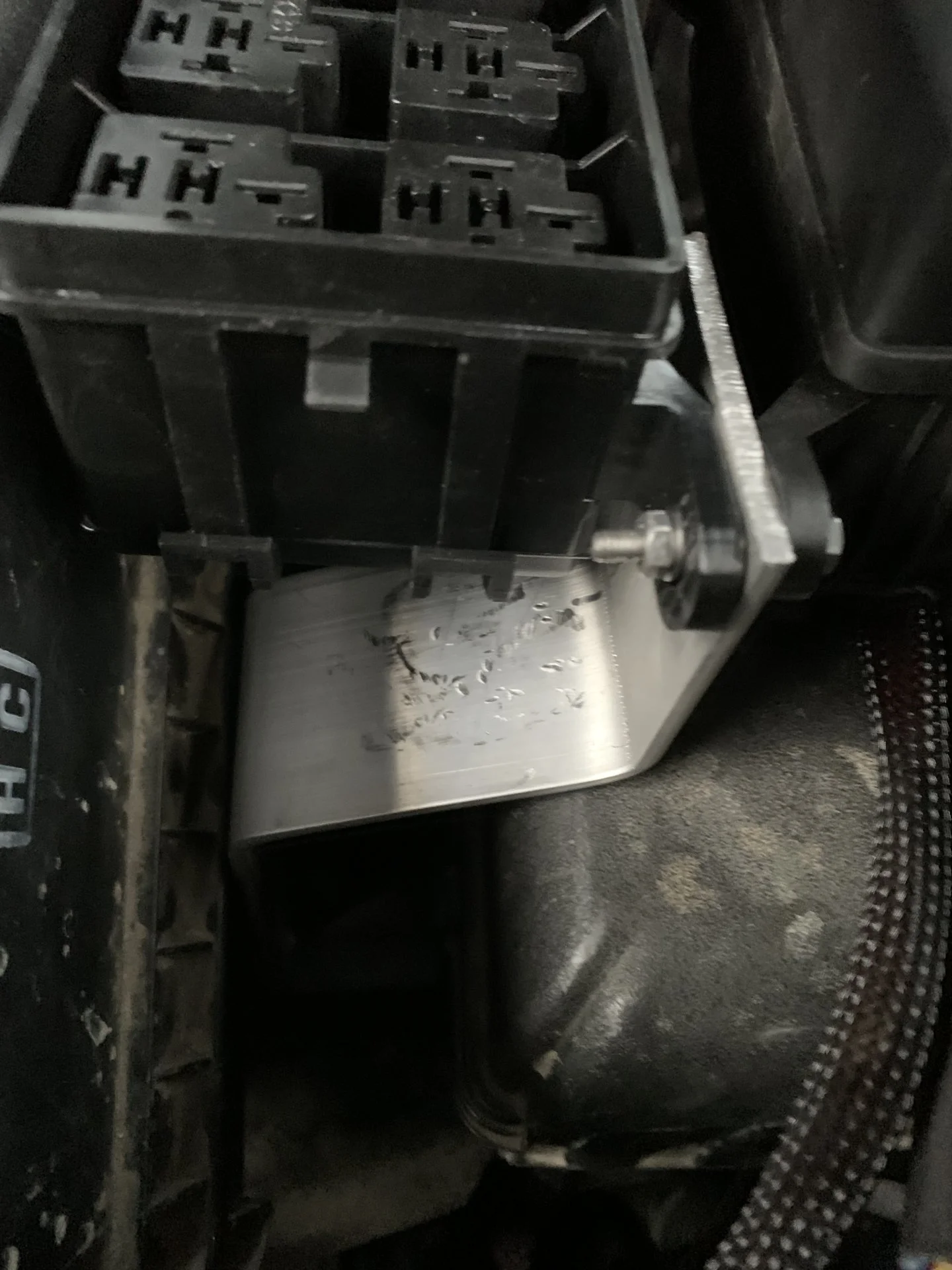

Now just a bracket to fab for the two fuse box/ relay boxes over by the cpu and air box, and this install will be ready to get going.
Needed tiny hands to get the bolts back in to the cpu case once the bracket occluded them, didn’t have them. . .three or four bolts are now sitting on my engine skid, but success!
Also had to use a magnet to get the bolts back in the holes, and a universal joint socket to get access.
Bracket construction was uncharacteristicly fiddly.
Box 1 is the light prebuilt, box 2 is generic and for the locker, winch control, and whatever else I need down the line.

Got the ignition switched solenoid wired.
Will put this in as soon as I find the roll of loom protector I misplaced.
Finished the solenoid wiring (except for split tube over wires).

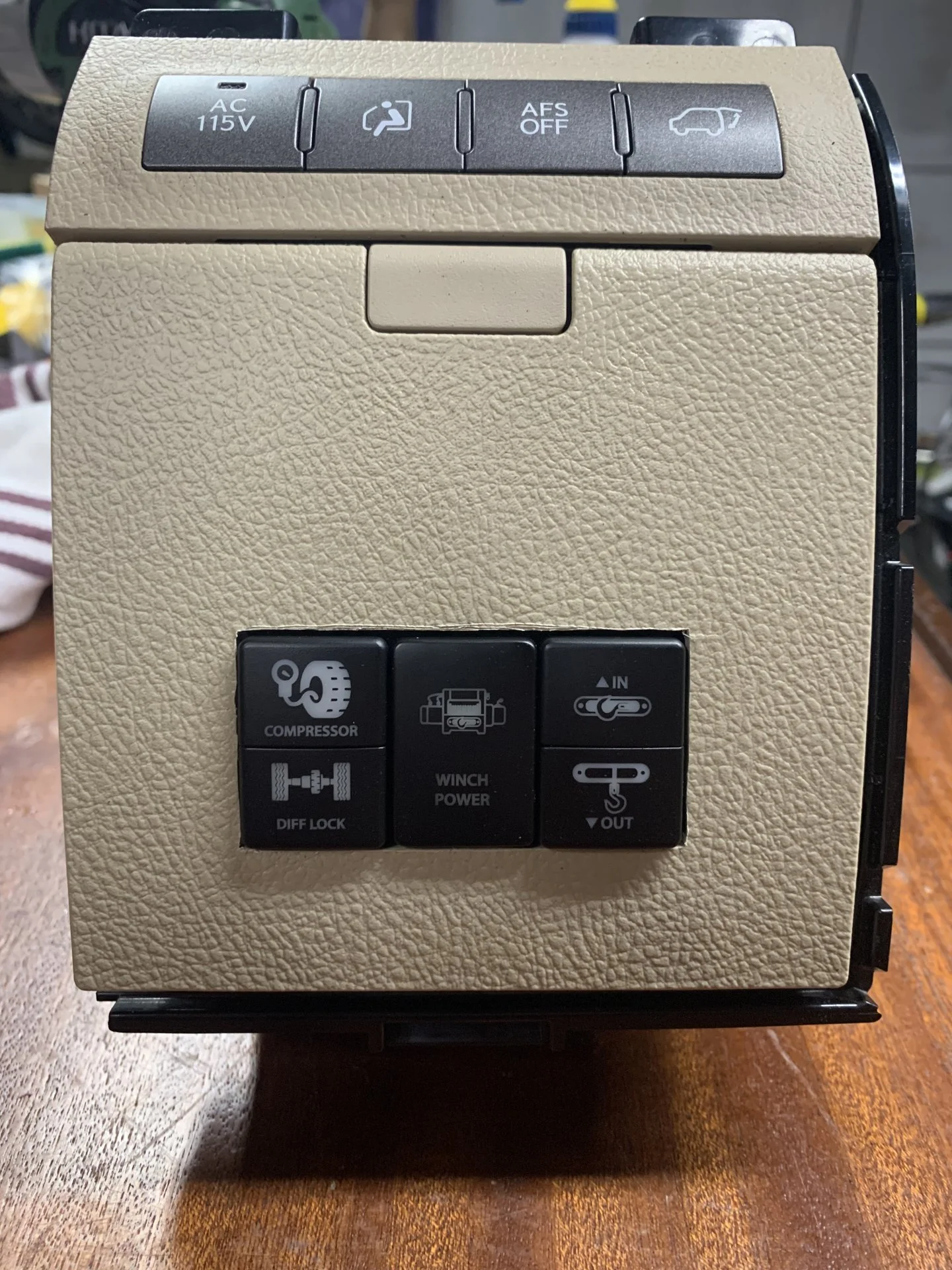

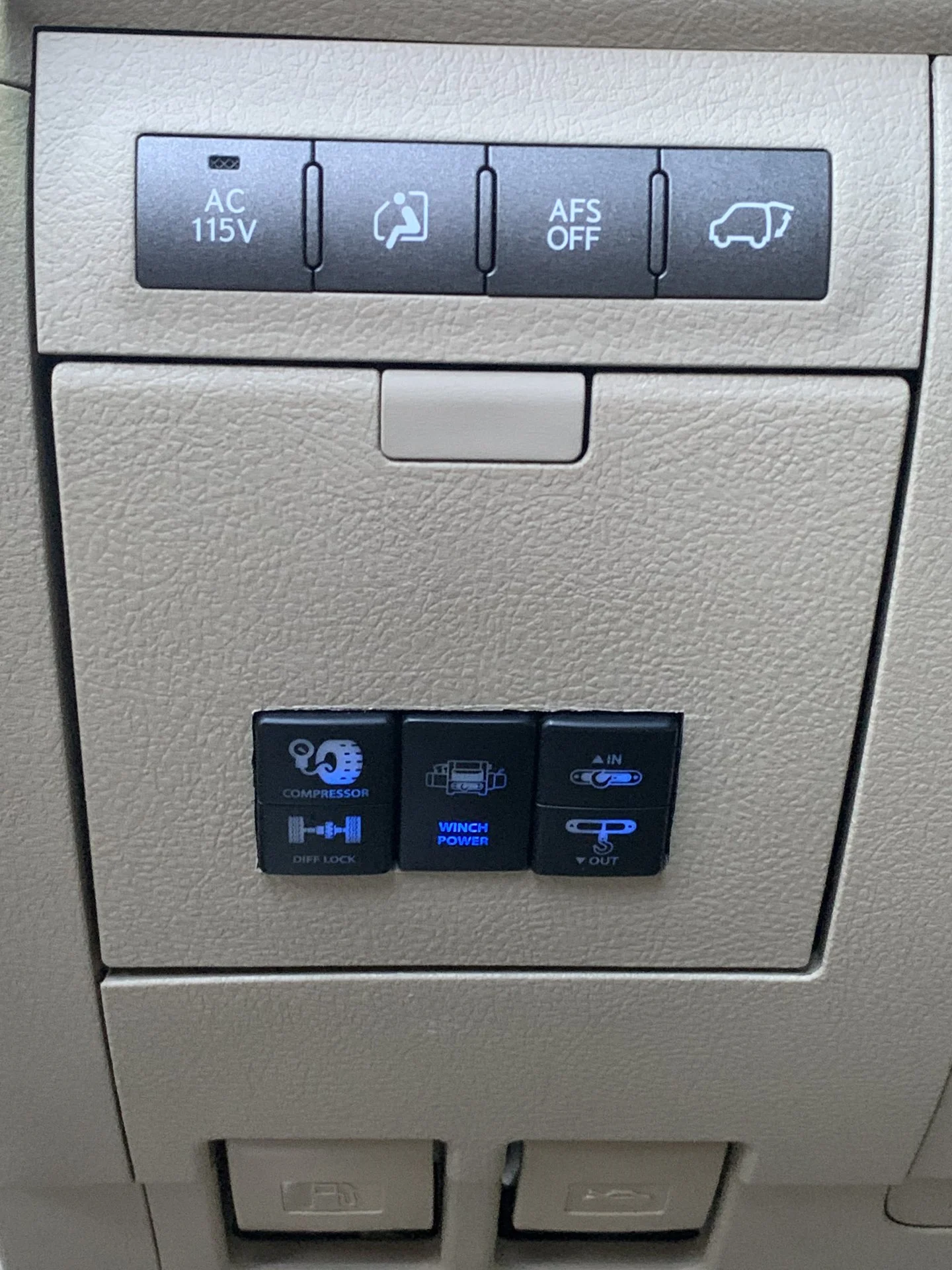

Finished cubby box wiring.
Added a dimmer pot in the cubby box so I can match the dash lights exactly.
Brilliant solution!

I can say it is fast and easy. Not noticeable from the ground for a 6ft tall person.
I wish I had done an 'O' (hollow center). Then at least I could slide the moonroof cover open and get some light in. Right now it's a total blackout.
I have the little cut tape stuff from a different project, just didn't think it all the way through.
I do intend to drop the (front) of the headliner and fix the drain (hole in tube or dislodged tube) properly, but was in the middle of some other stuff and it just rains too much in spring here to let it ride.

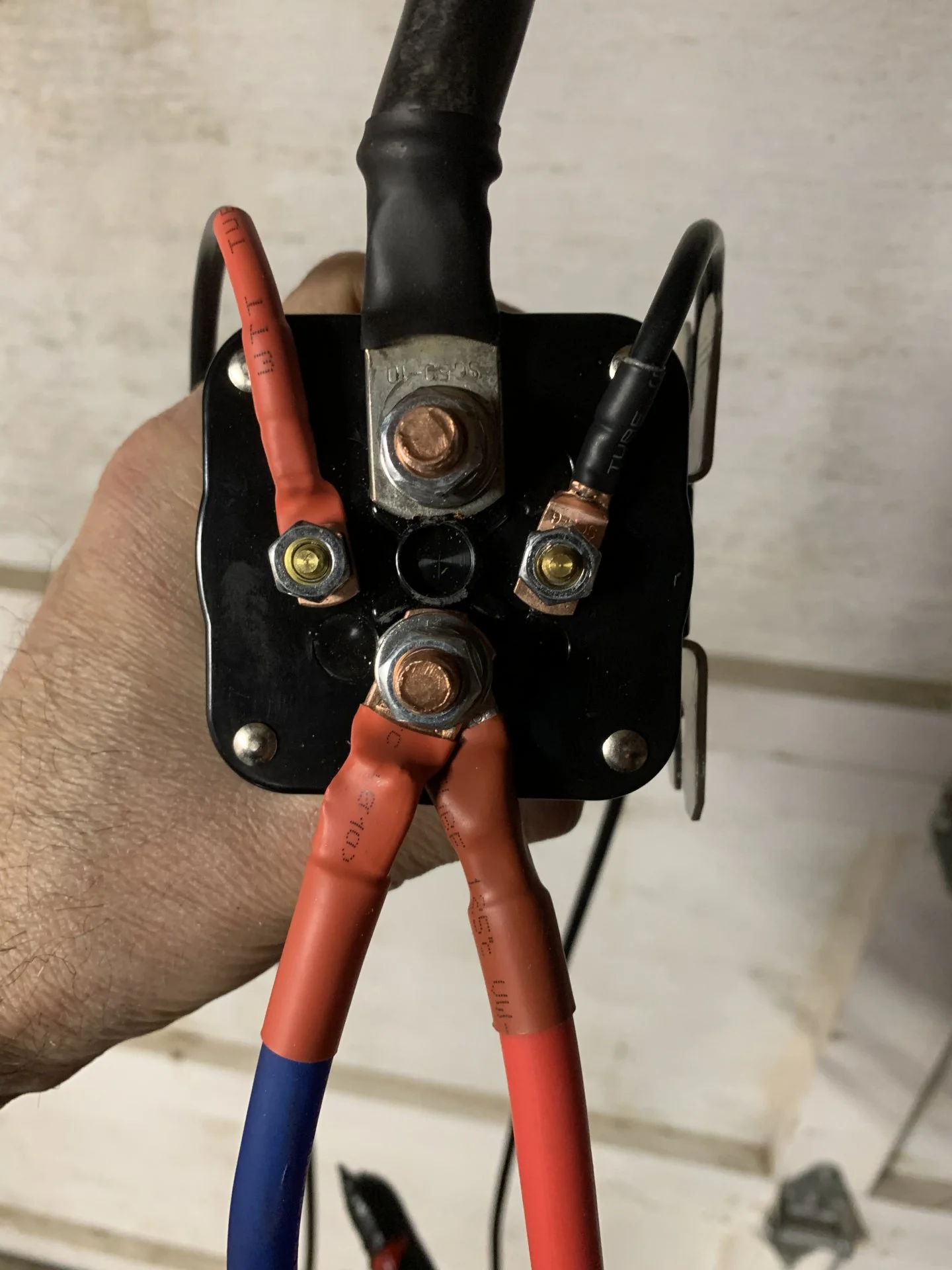

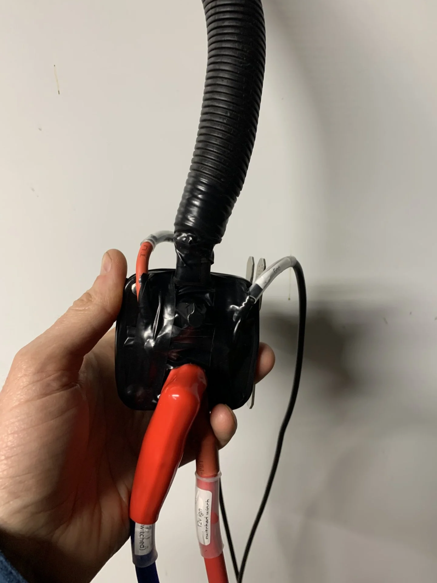

Redid the winch solenoid today with loom.
Final install done, with the power in on the 300a fuse and power out loomed and waiting zip tied in the grill for the winch. Ran the control side ground, just need to tiein the control side 12v to the soon to get exist ignition breakout.
Installed the inside portion of the wiring.
Moved the trailer controller ground up to a different ground, along with the ground for the momentary winch controls.
Tapped the illumination circuit off the cubby switches and connected that in to my switches.

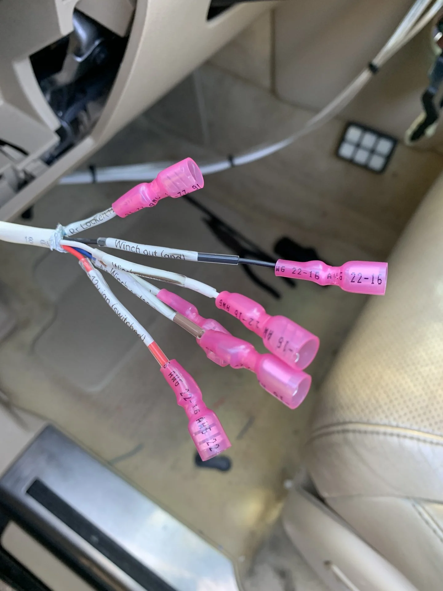

Labeled, terminated and installed all the custom switches to the new wire thru the firewall. In the end only needed six conductors, so have an entire spare wire with six conductors for future use.
Hooked it up, illumination circuit wasn’t working. No volts at stock wiring. Looks like one of the tap spade connectors didn’t slot in correctly. Fixed that and all good. Potentiometer a good idea, it was necessary to tame down the brightness. Very easy to do and probably a set once item.

I admire ingenuity and perseverance in rolling your own on the switching solution. Seems like a crap ton of work? If you were to do it again, would you go this same direction?

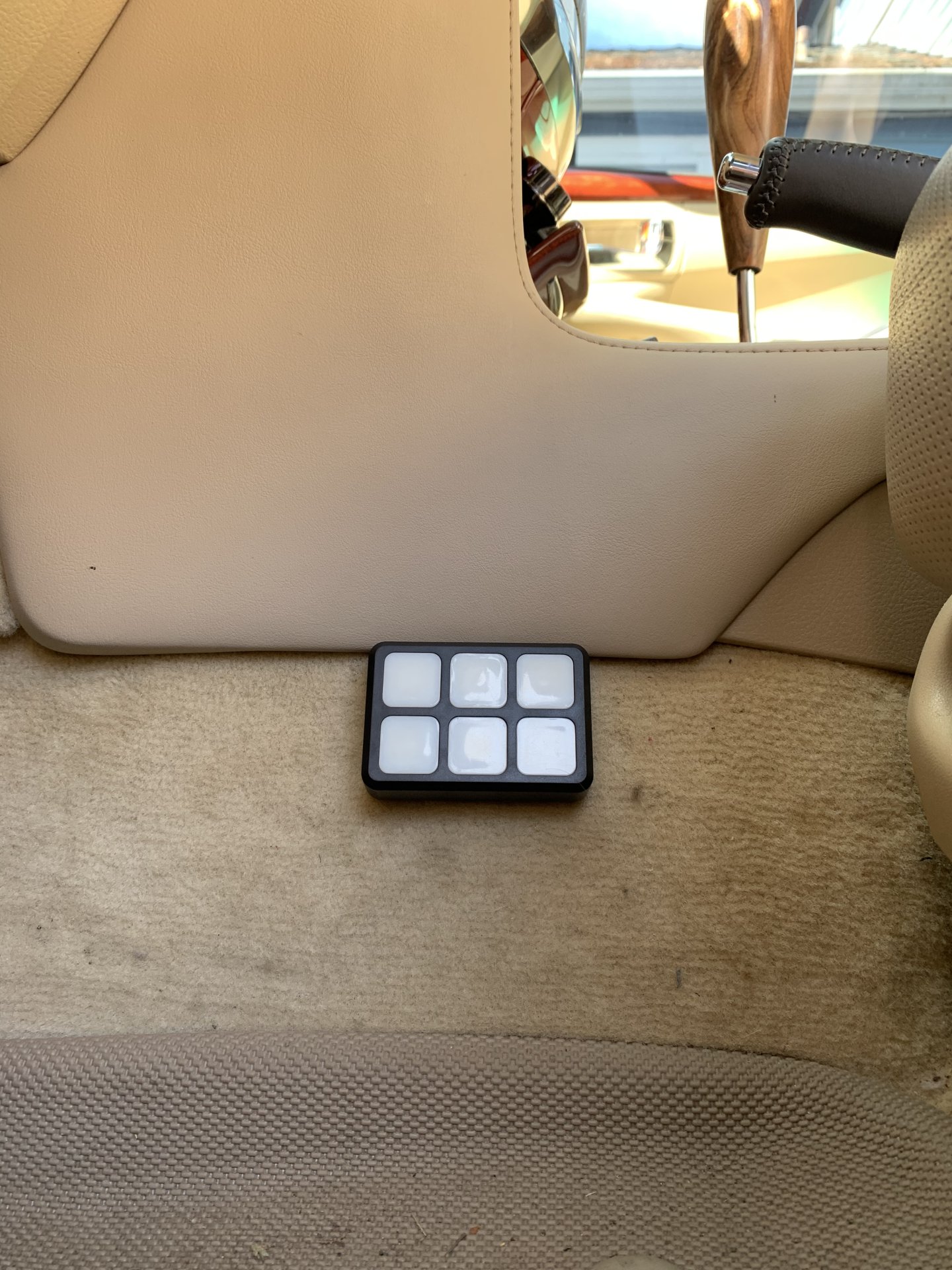

It’s a good question. Certainly any of the 8 switch option items in the $200+ or a switch pros at $500 could handle what I needed.
I had an older style 6 switch option that was a gift a couple years ago, and hadn’t installed it or gotten excited about it. I guess because there aren’t a bunch of great places for the control pad, and even when put in a place like the sunglasses holder, it would look generic when in use.
(I am not throwing shade at these installs, they just didn’t thrill me.) the one I was given also had no brightness control, so I was very Leary putting it anywhere in my eyeline
I used a Bluetooth 4 relay / switch installed under the hood for four years and it worked 100% during that time, but didn’t like having to switch to the phone app, just a bit too much friction.
With the upcoming bumper/winch I wanted easy, well placed in cab controls for the winch, and while I was thinking on that decided to add in the additional known items I had already installed, as well as finally found a purpose (lights) and place for the old 6 gang prebuilt, I was willing to do the integration on the backend, and thought it would be a good project.
I’m actually learning loads about what makes an electrical system work and how to leverage relays correctly. It’s been very educational and a fun project. I’ve had to draw a bunch of schematics, and the more Iearn the simpler and more reliable they become. The journey on this has been really good because now I much better understand how the stock electric works, how to troubleshoot it, and how to fix it. I think these kinds of skills are really important in case they are needed when out and about, as so much of our trucks run thru an ecu or relay to do things.
