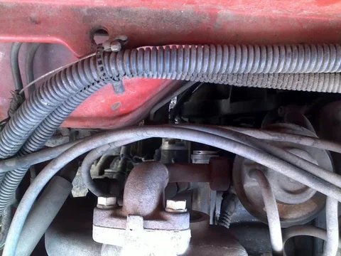

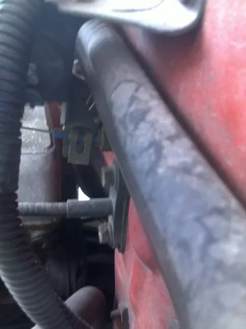

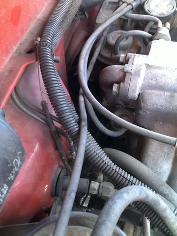

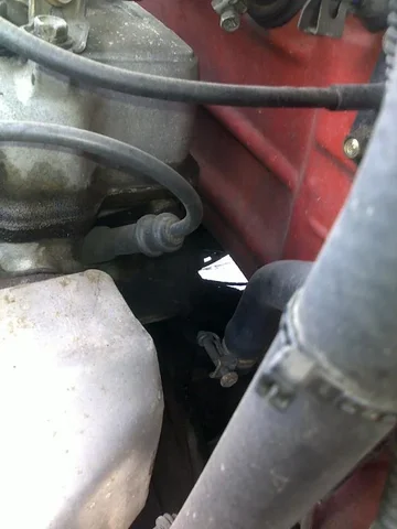

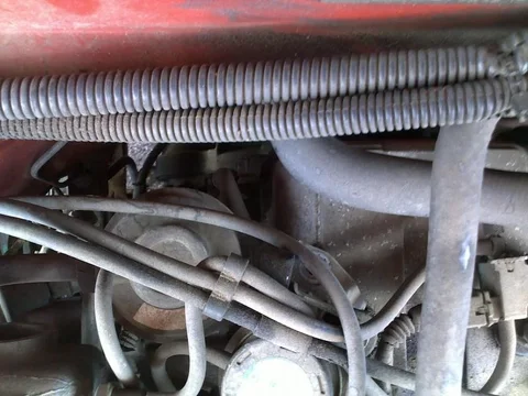

Quick question I'm hoping one of you guys can help me with. I'm thinking when I start putting this thing back together, rather than drop the engine into the bay and risk dinging up the freshly painted inner fenders, can I just put the engine on the frame, then drop the cab over it? Seems like that's how they would have been assembled at the factory.
But I need someone to take a look under the hood of a truck with a 22RE, make sure it will clear, mostly the intake. I *really* don't want to put the intake on after the cab is on, it's a huge pain to reach all the bolts. I will probably leave the header off until the cab is on, just for clearance.

Pictures
I don't know if these will help but here are some pics.
From passenger side
Directly above firewall at intake.
Directly above firewall at valve cover.
Yes, that does help, thanks. Looks pretty close. Hmm...
Maybe I could leave the VC off, drape a blanket over the engine. It will help that I won't have the bed in the way, so I guess I could come down with it a little too far back, then come forward after getting it on the frame.
