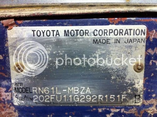

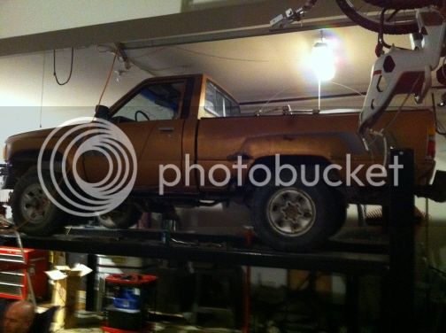

Purchased in 2013 from Iowa 1987 standard cab /short bed turbo sr5.
Started snowing as soon as we arrived to look at it and kept getting heavier, near whiteout as we pulled away. I live in southern IL. Near St.Louis and a friend of mine near Chicago was having a tech day at his place the following week and asked if I wanted to bring it there. He has a 4 post lift which made it really nice to work on.

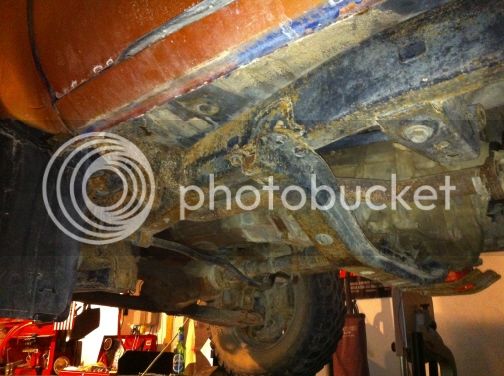

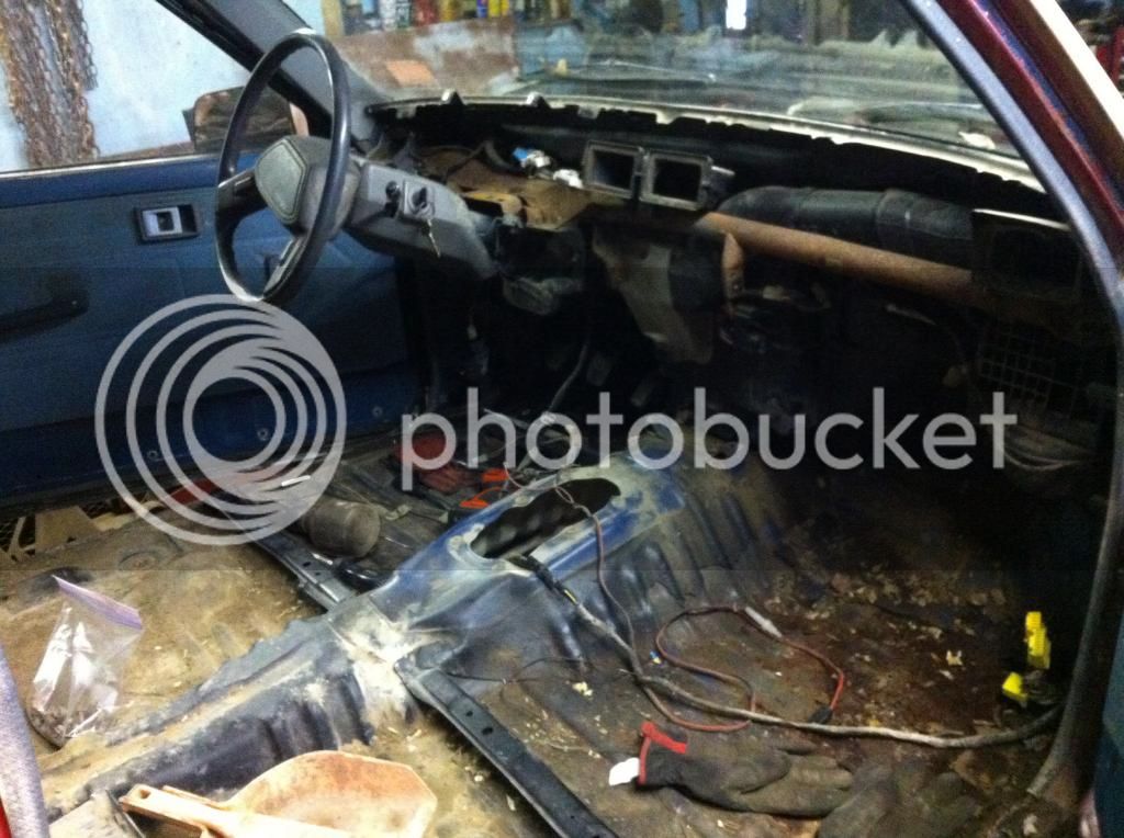

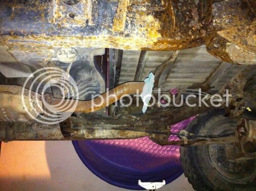

The frame is solid, only surface rust on back half. Cab is solid except for some crash damage on passenger side and one small hole in the floor.
I was surprised to see factory paint on the front half of the frame.
We pulled the gas tank to correct the non working factory pump and delete the after market external fuel pump which also did not work.
That got a little involved with having to clean out the pick up tube and return line tubes and also replacing a section of fuel line. Finished out tech day with BBQ, rc crawlers and cocktails! Good times!

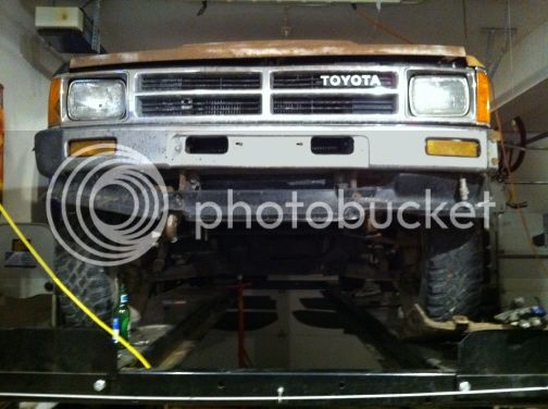

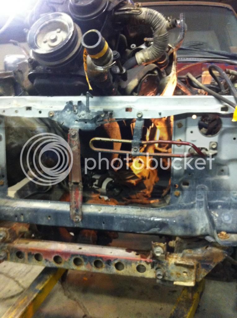

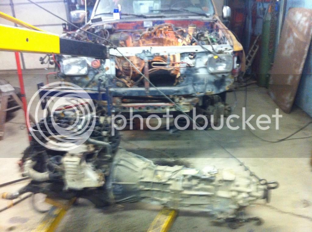

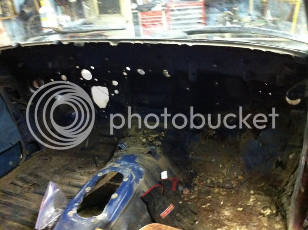

I decided to go ahead and tear it down to bare frame to get it ready for sand blasting. Started with engine and trans but made a poor decision to pull them as one unit. Got them out but very tough to manage by myself.

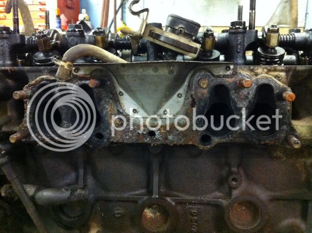

When removing the exhaust manifold and turbo assembly I found silicone on the gasket and what looked like a bad seal.
Removing the gasket made me a little more relaxed but still curious. I find out when it makes it to the machine shop.

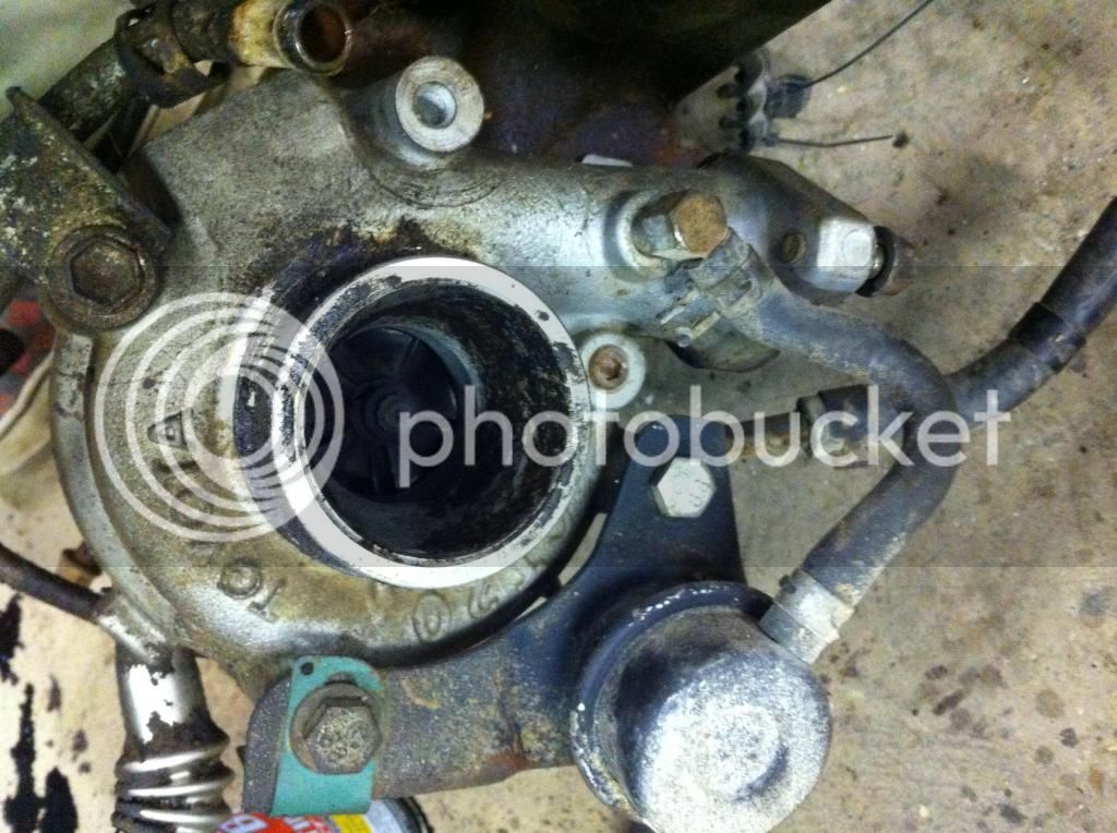

Turbo appears to have sum sludge in it. It will be sent off to see if is any good or not. If it isn't I will probably go with a kit from LCE.

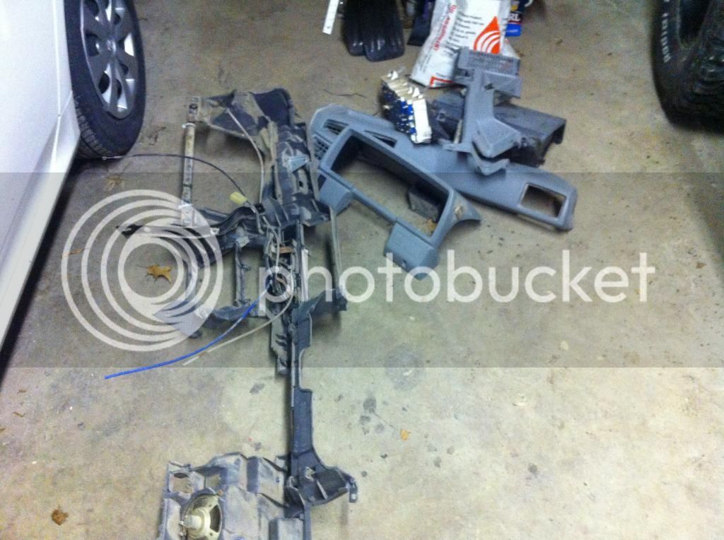

Heat/vent control panel has a broken face plate, po mounted a cb clip to the side of the gauge cluster cover, and the dash pad is cracked.
Bench seat needs recovered and the bottom foam repaired/replaced but will be used so our wiener dog Stanley has a comfortable place to sit.

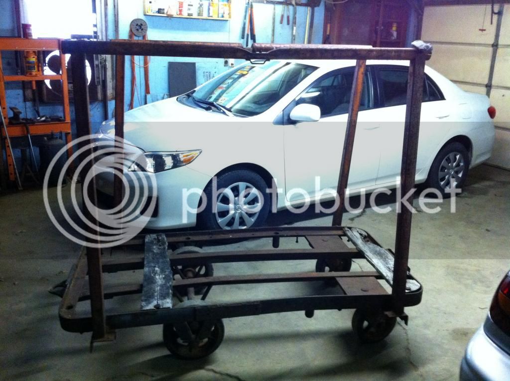

Picked up this old cart to modify for mounting the cab to for media blasting. Looks like it may have been an old railroad cart of some kind.
