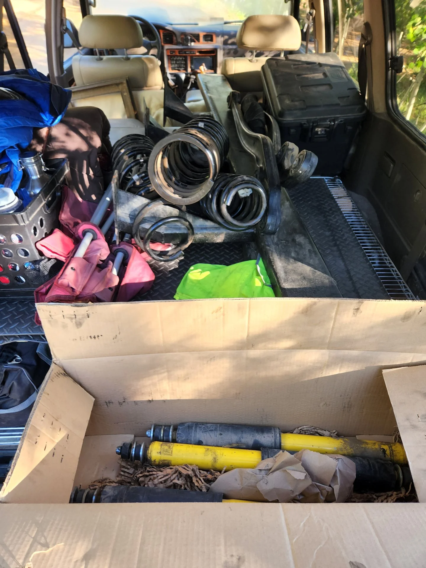

But this weekend I accumulated some parts that will be keeping me a little busy this week. Through a local Facebook group I found some BIOR sliders and a OME stock height suspension kit:
It's amazing to think that these bits will get this rig closer to being "complete". I'm going to add some floppy rubber mud flaps and I should be all set. Thank goodness for the upcoming long weekend, I've got wrenches to spin.
Edit: Sliders went on with minimal fuss. Not a horrible job to do solo

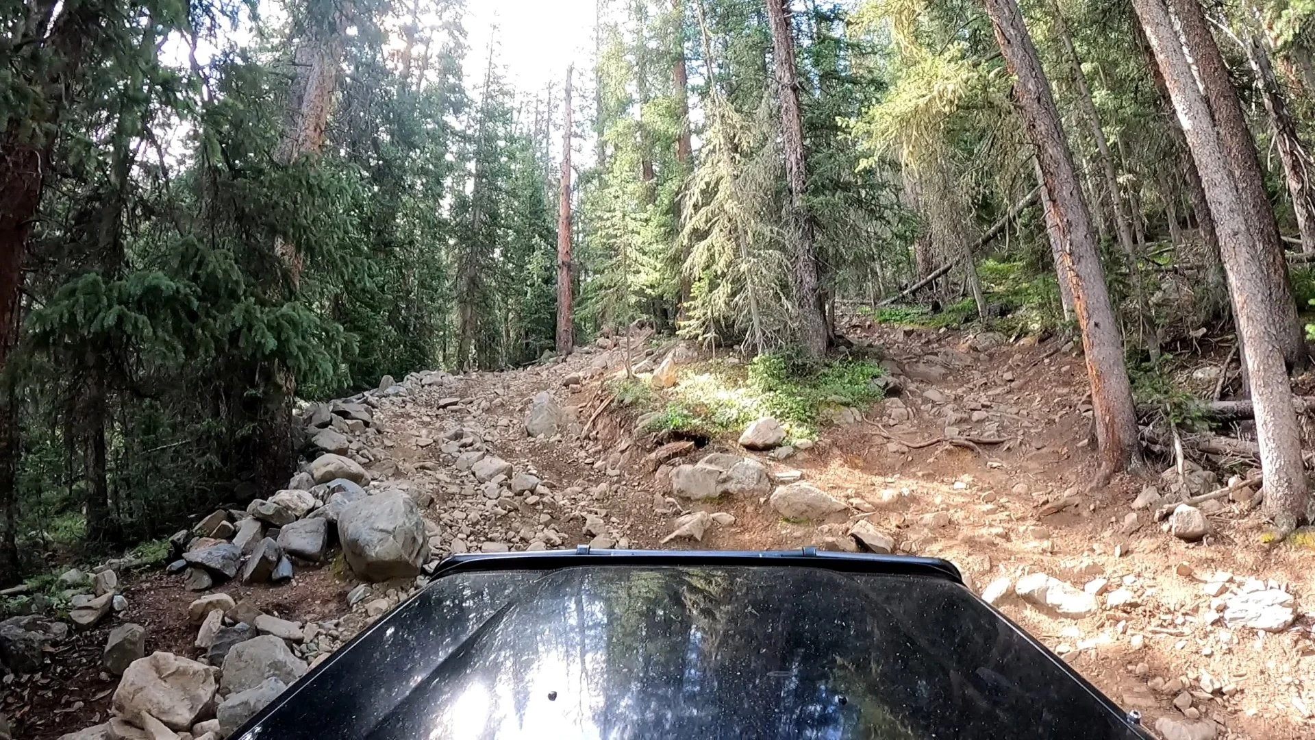

The entire drive I was mentally preparing myself for the SOB Hill obstacle along Glacier Ridge/Georgia Pass. I knew it was going to be a jarring challenge, especially uphill.
I came to the bottom, walked it a bit, then sent it. I made it 85% of the way up under my own power, had to do a bit of a winch pull, then completed the climb unassisted. Thank goodness I have sliders on now because I would have annihilated my rockers without them. If anyone cares to see the video, I can upload the Gopro footage.

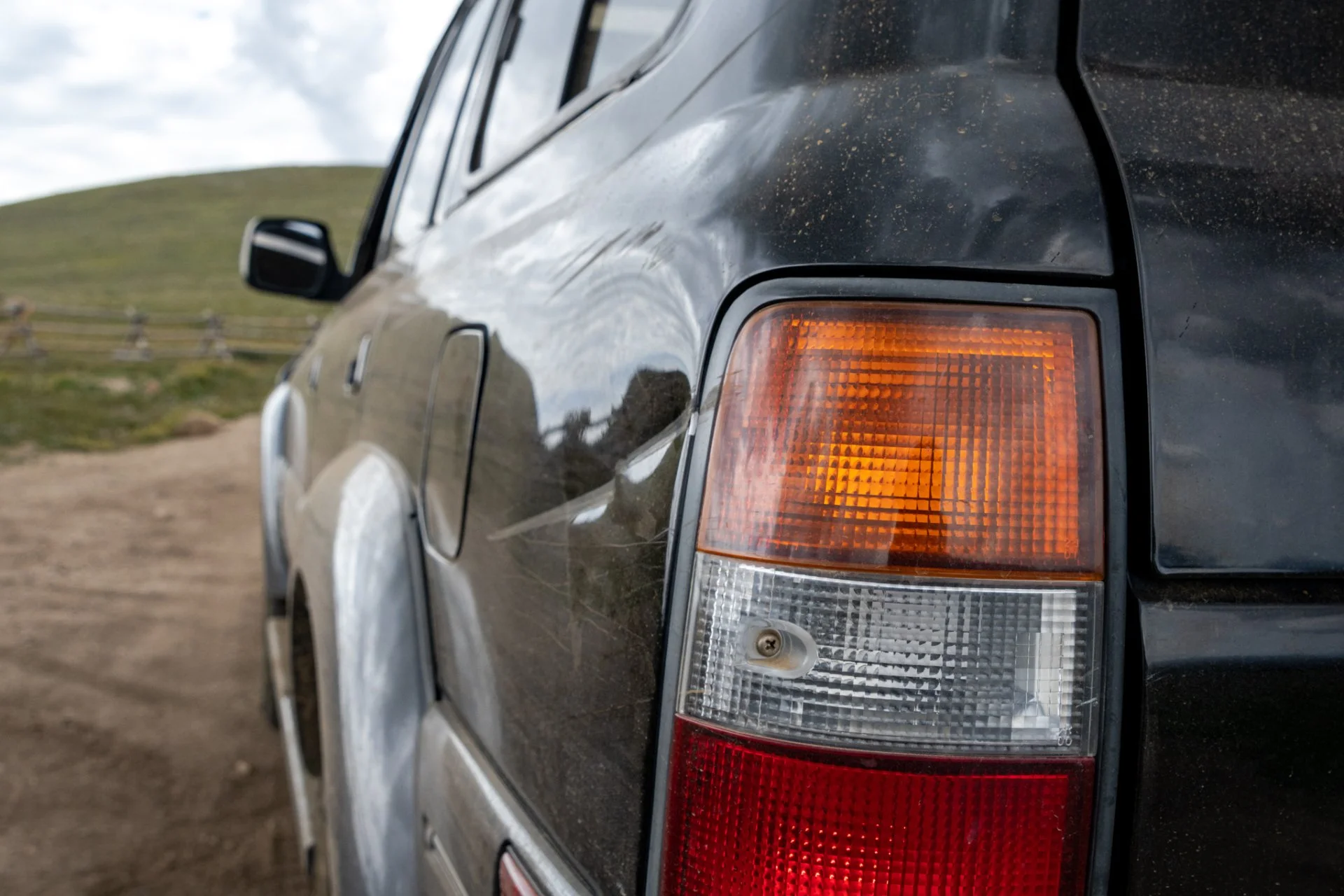

At some point during that climb I managed to tag the rear quarter, I didn't notice until later:

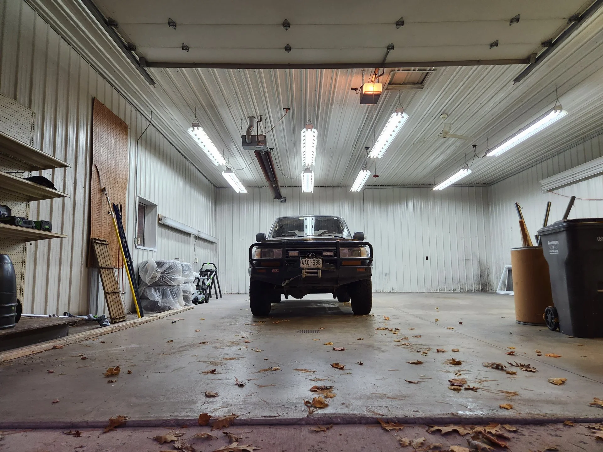

Last Thursday I headed far east for two weddings and a family visit. I'm currently halfway through this trip and this thing continues to just eat up miles and leak oil from the valve cover gasket.
At least it gets to leak in a garage tonight?
I'm thinking that when I get home, it's time for a spa day for the rig. Thanks for reading

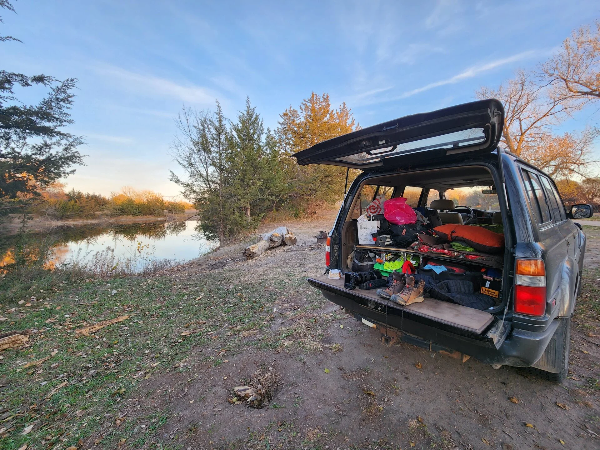

On the way home I stopped in western NE for a quick overnight in the back of the rig. After a week and a half of being in large metro areas, I needed some peace and quiet.

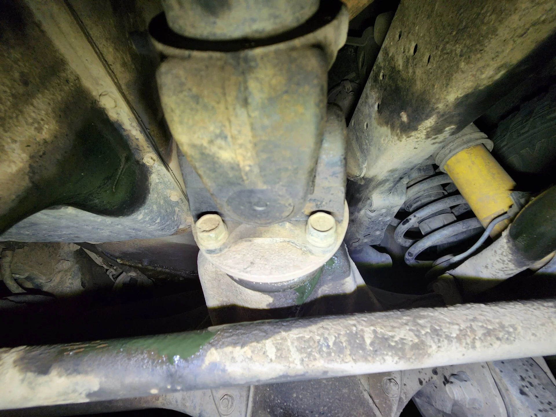

Whenever I'm covering a lot of miles, I like to do post-trip inspections after each journey leg. While poking around with a flashlight, I noticed that my front diff pinion had started to leak.
I popped the fill plug out and stuck my finger in - seemed like there still was plenty of diff oil in the case. The following morning I headed straight to an auto parts store to pick up some more and top it off. Once I started to add the fluid, it immediately started to flow back out. I took comfort in knowing that I hadn't run the diff dry.

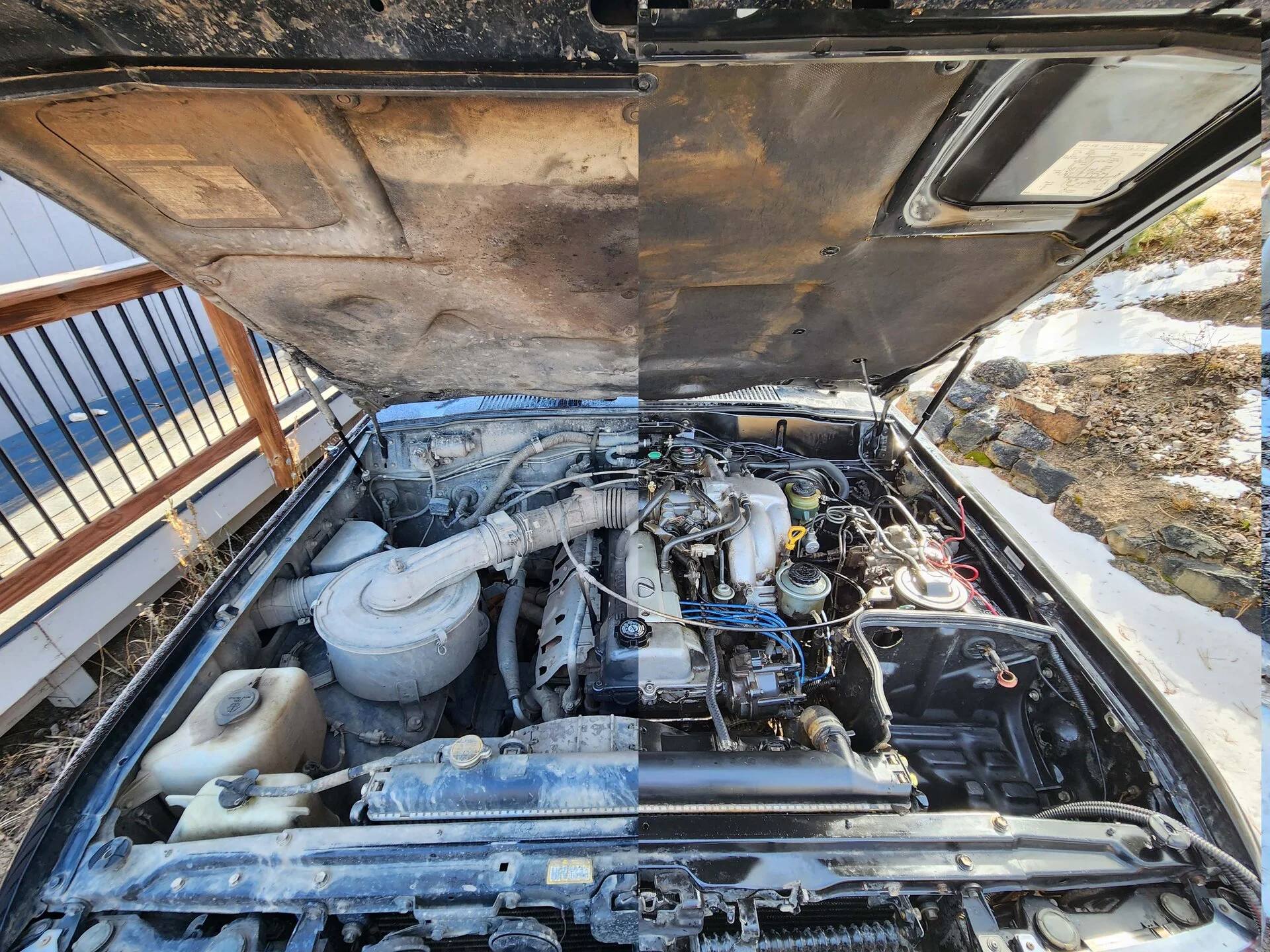

Once I had returned from the trip, I scheduled a dealer appointment and gave it a thorough wash, which included detailing the engine bay. Could I have done the diff seals myself? Probably. But did I want to in my gravel driveway with snow on the ground? Not really.

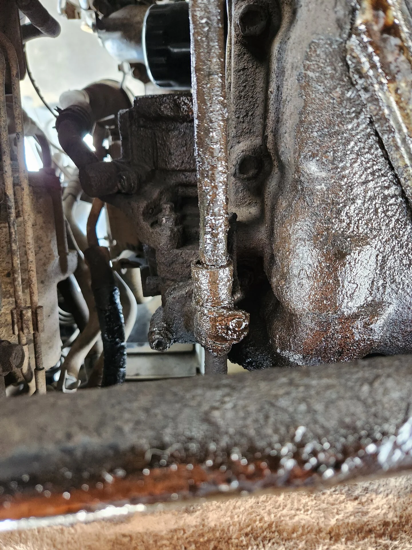

Crawled under the rig on Saturday for an oil change and observed the power steering drip has finally reached the hemorrhage stage. Still had plenty of fluid in the reservoir but it's time to get this fixed.

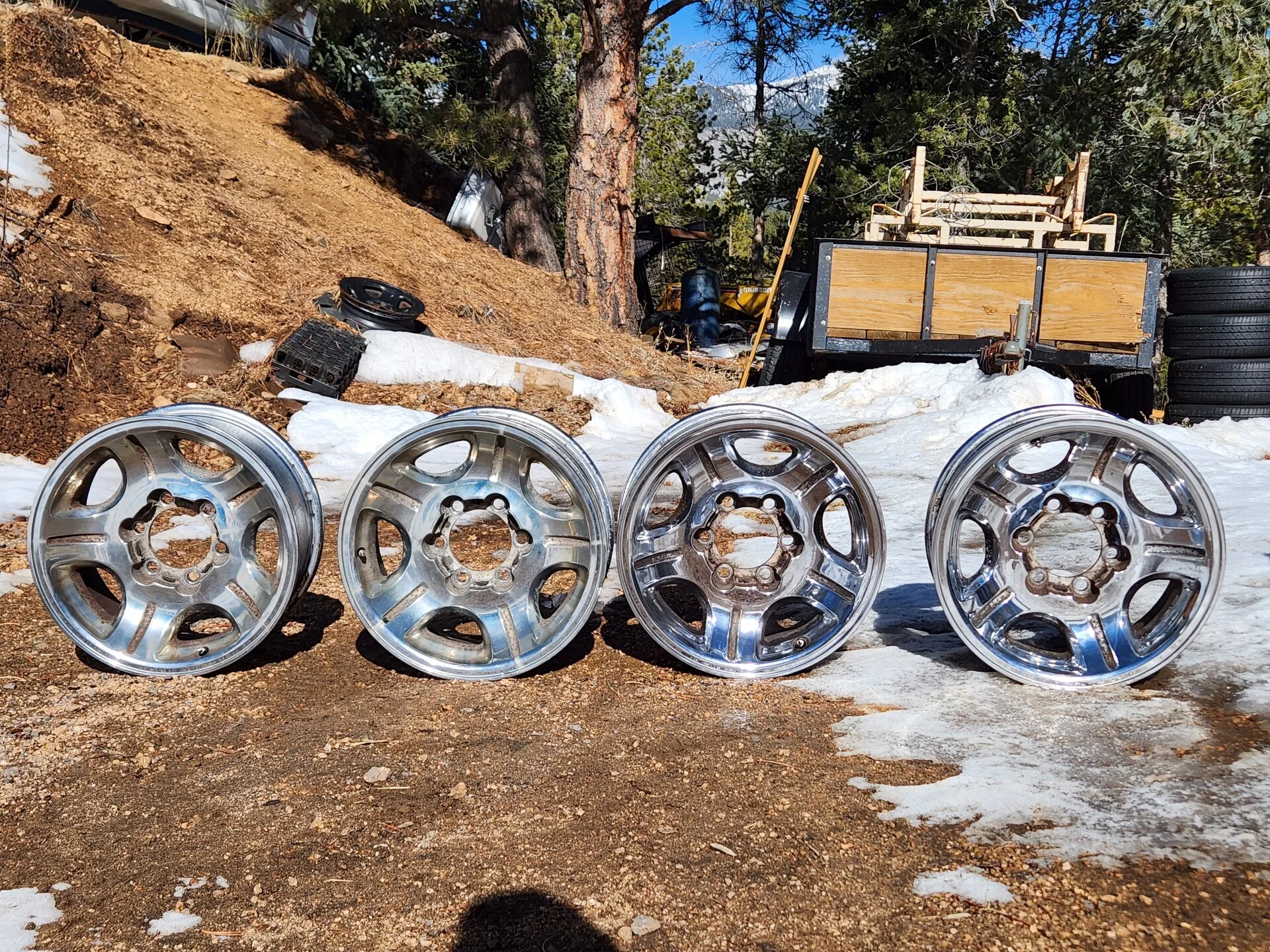

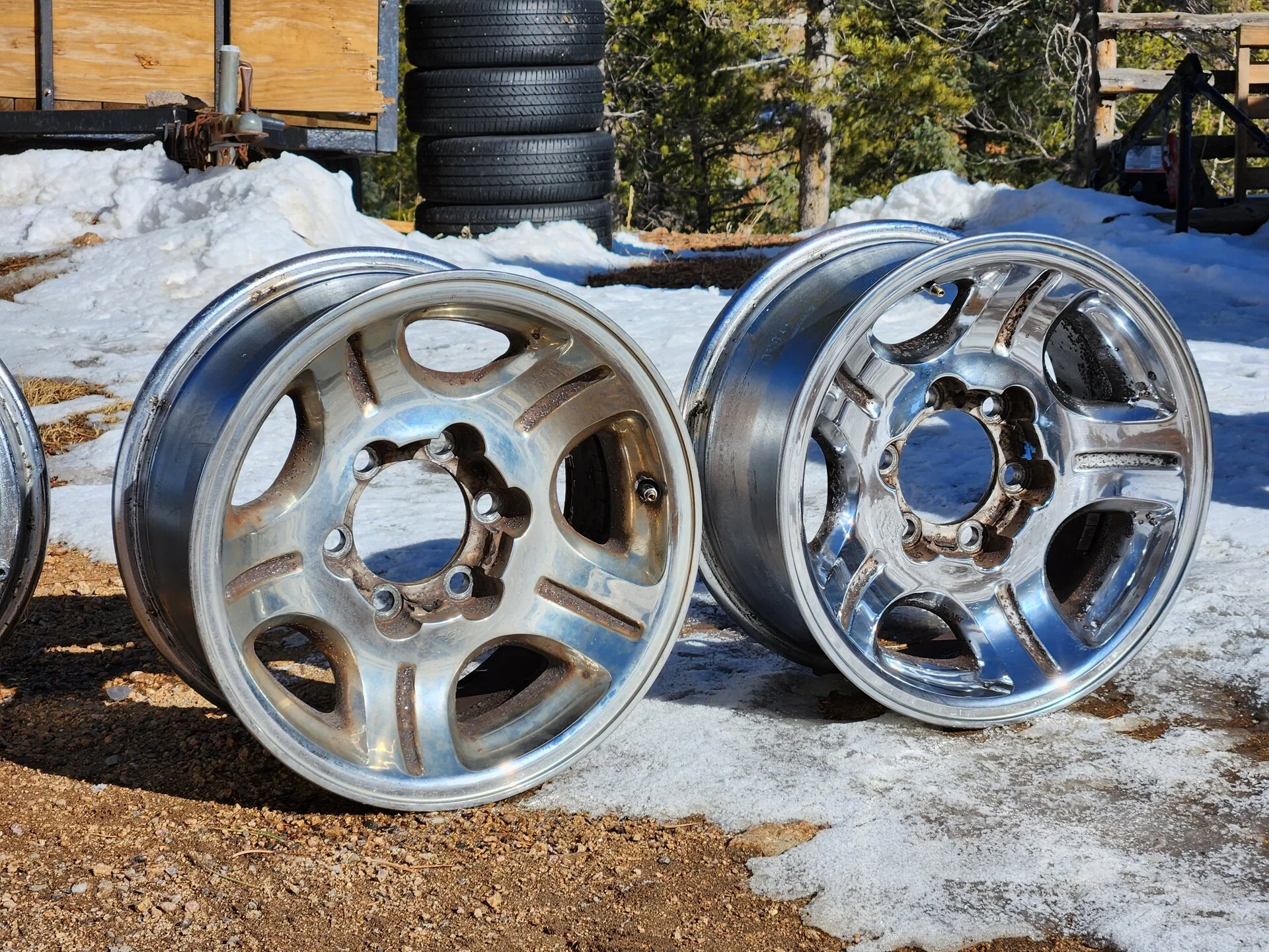

I picked up some OEM chrome wheels to run as my summer set. Before getting new tires mounted, I thought it would be nice to clean them up. Here's two before and two after:
I brought the faces back to live with a toilet brush on a power drill, soapy water, steel wool on a power drill, then buffed with a foam cone and some compound.
Not minting them out was a deliberate choice - I wanted them to shine but also match the patina of the rig.

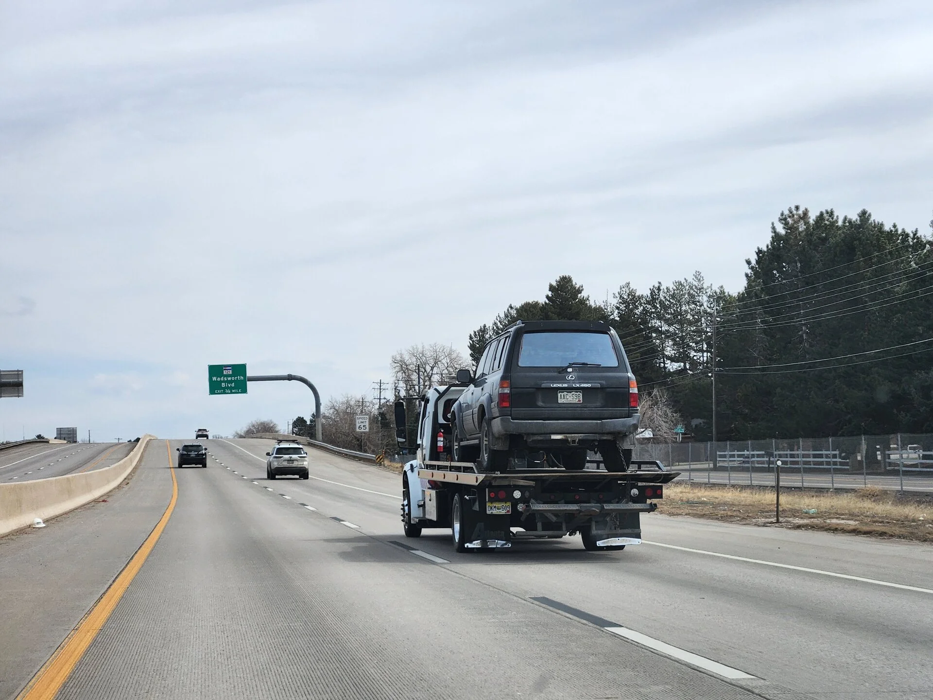

Not exactly what I wanted to do with my 80 today.
I had it in the shop for over a week to get my power steering system gone through. While I fully acknowledging the value and superiority of doing it myself; it's cold out, I have no garage, and sometimes I'm a total weenie and don't want to wrench with frozen and numb hands. New pump, lines, and cooler at a dealership I trust and genuinely like.
Anyway.

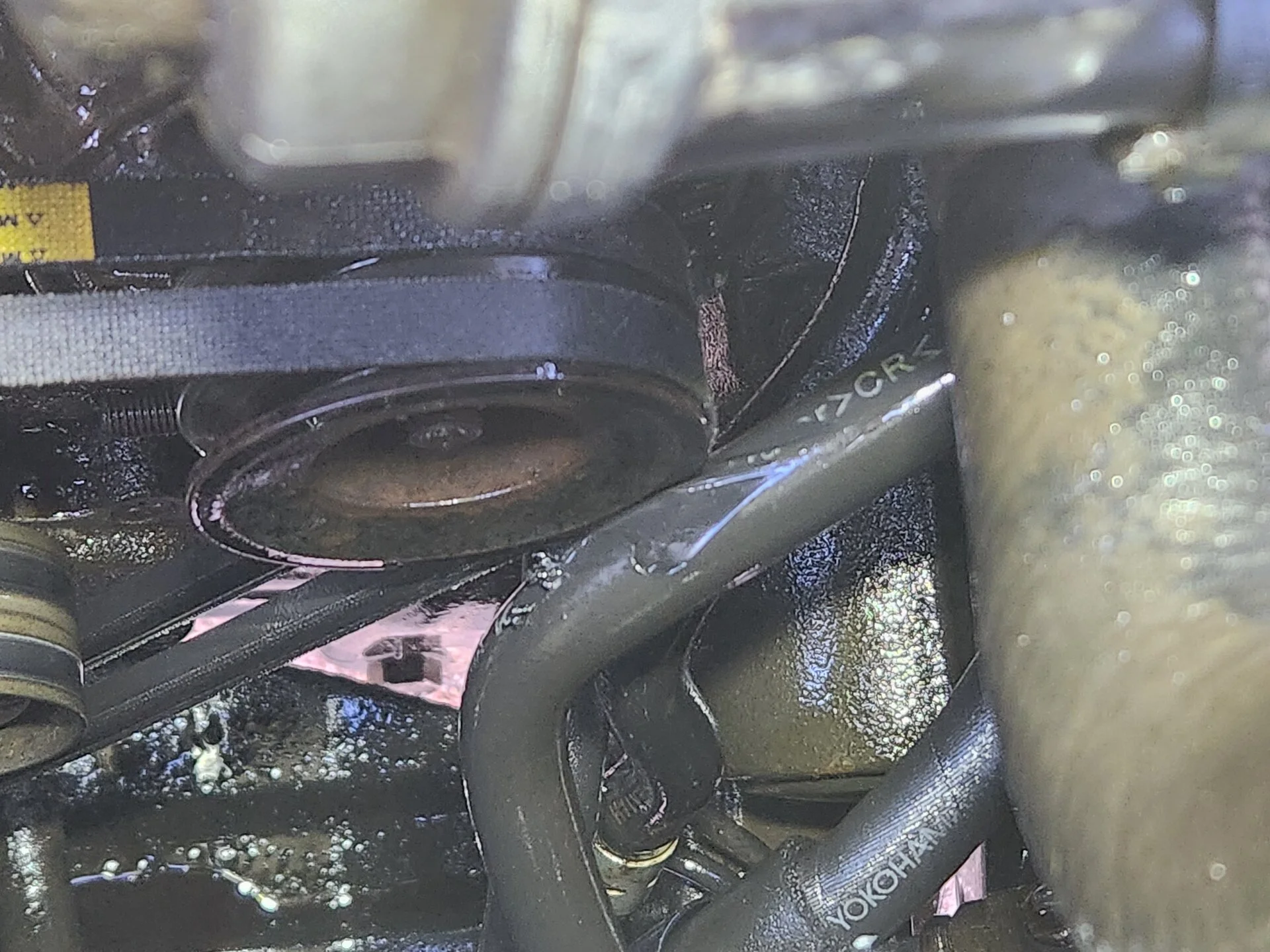

Dingus dealer tech somehow put the P/S lines in wrong and the alternator pulley ate straight through one. I didn't catch it until it was too late and every drop of fluid evacuated the system. Pulled over pretty quickly, hopefully no damage to the new pump.
I evaluated the situation. I did have more fluid, generic hose that would fit, zip ties, etc. I was prepared to do a trail fix but decided to let the shop do it under warranty instead. I had barely put two tanks of gas through before it blew.
My main question now is: My alternator is now saturated with ATF, is it ruined and is it fair to ask for a rebuild as part of the warranty work?
Not mad at the dealer. Just disappointed.

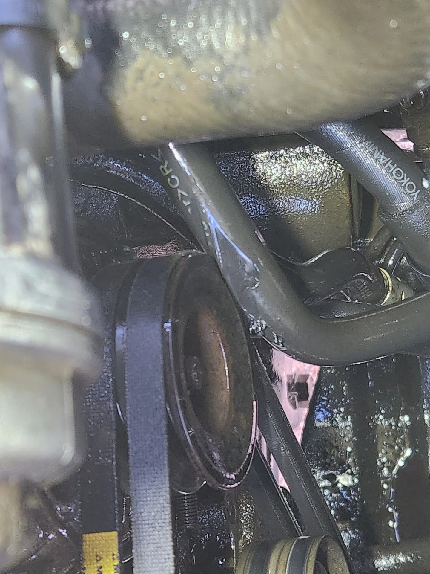

Sorry about the angle, the photo makes more sense rotated 90* clockwise:
I didn't even think to check the belts, but would have that impacted the interference between the hose and pulley?
Belts seem to be okay. That rotation makes it easier to visualize. That hose is just been routed/angled to close to the belt
Bit of an update - dealership made it right and without hassle. The alternator came out for a good cleaning, hoses got routed correctly, etc. A new reservoir also went in while the system was empty.

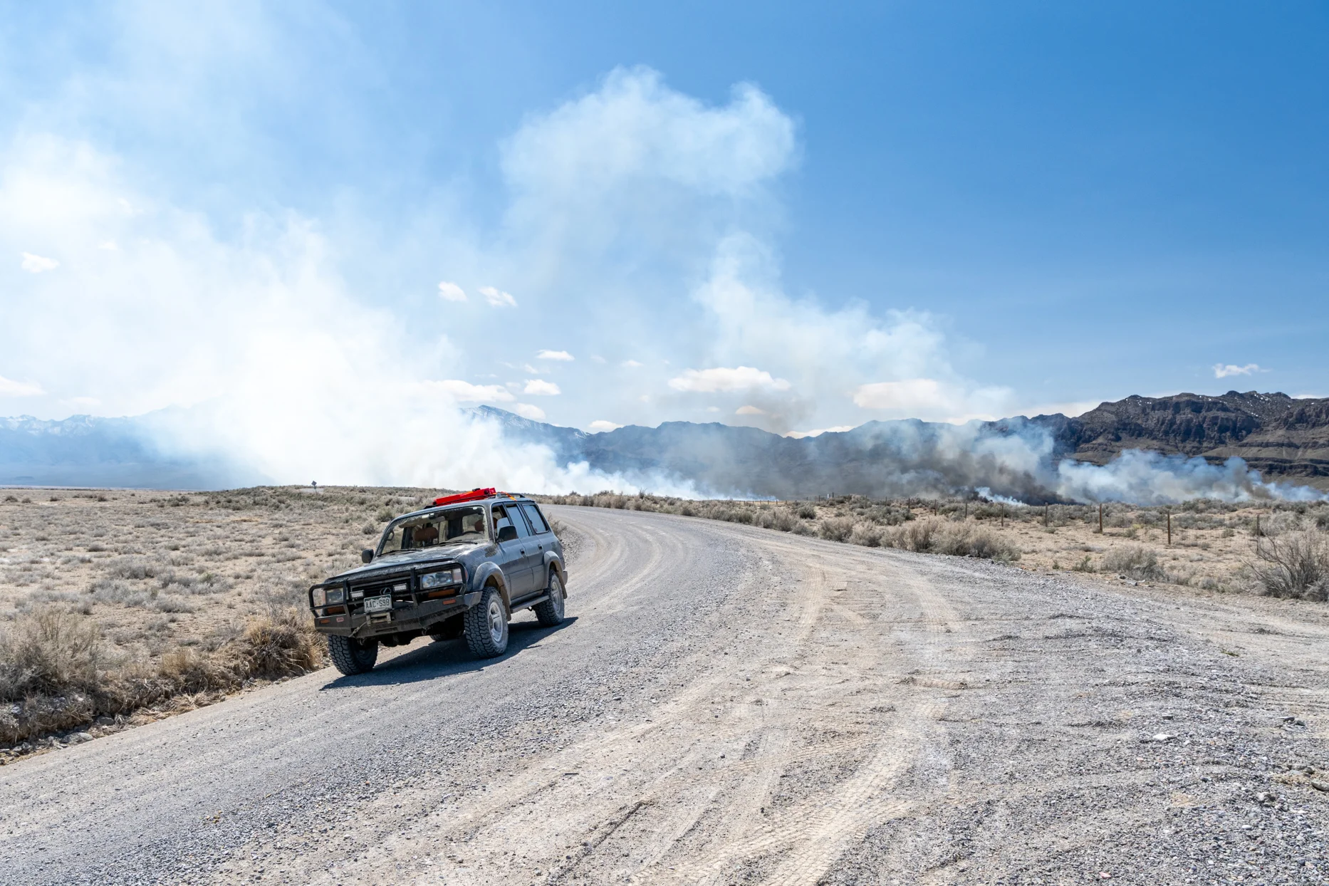

As I rounded a corner and started approaching a bird refuge that I was interested in visiting, I noticed something was off.
The avian oasis seemed to be on fire.
To be continued...
As I approached the flames it became apparent that it was a prescribed burn. There were fire workers out and about with cans of accelerant igniting the brush. The first one I spoke with indicated that I wouldn't be able to drive through. I flipped a U-Turn and pulled over to review the map and make a detour plan. Things weren't looking great.
After a few minutes of studying and fretting, a different group of workers approached on a UTV. I applied the "Mom said no, maybe dad will say yes" logic and flagged them down to ask about getting escorted through. They disappeared into the smoke for a few minutes, then returned with good news.
So now I can say I've driven through a brush fire.

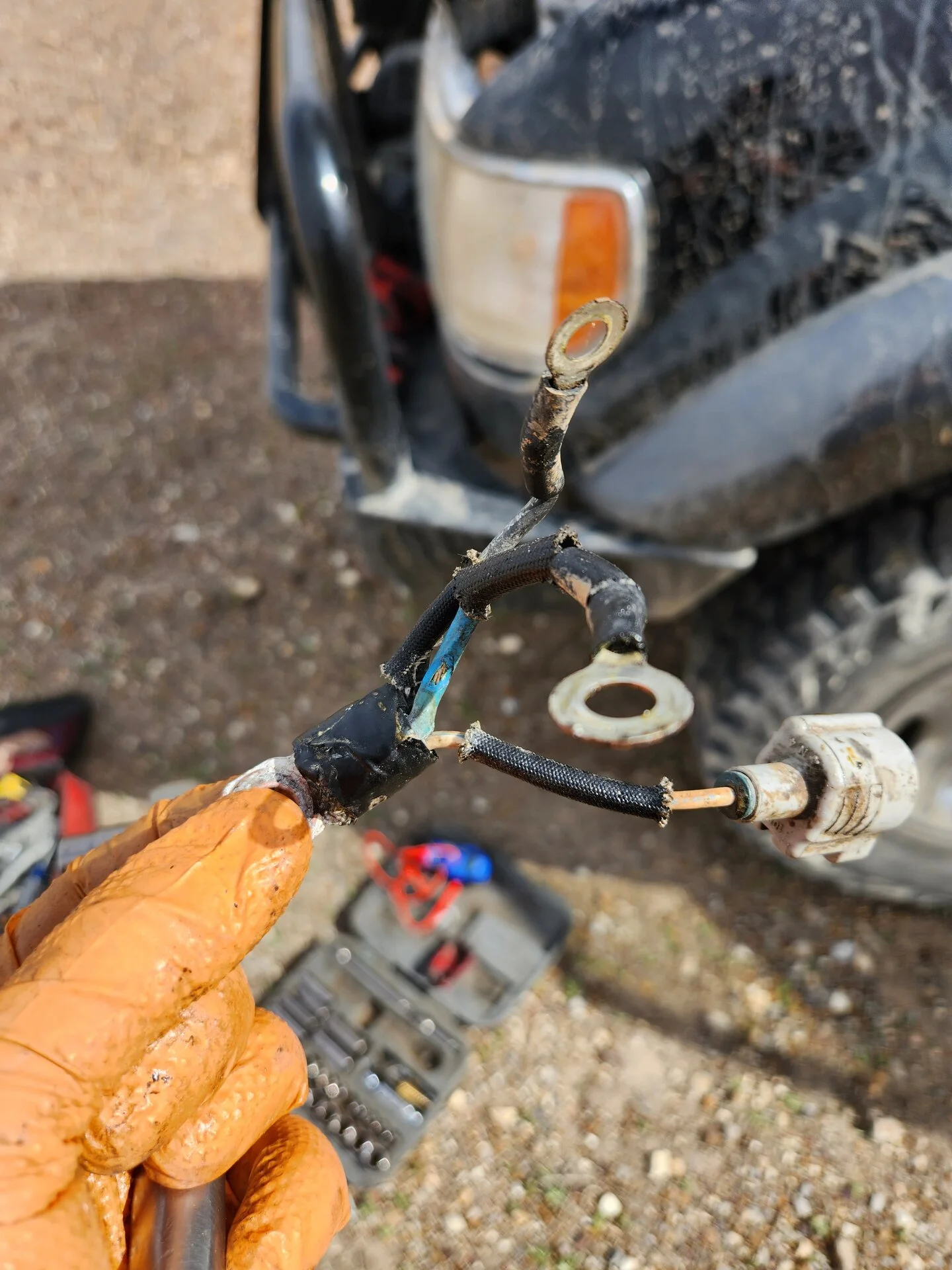

Sufficiently amused I hopped back into the LX and went to fire it up. It cranked for a millisecond then everything electrical died. My mind immediately went to the fusible link. I grabbed one of my two spares, swapped it in, and the truck roared back to life. Crisis averted.
The old one was looking pretty haggard.

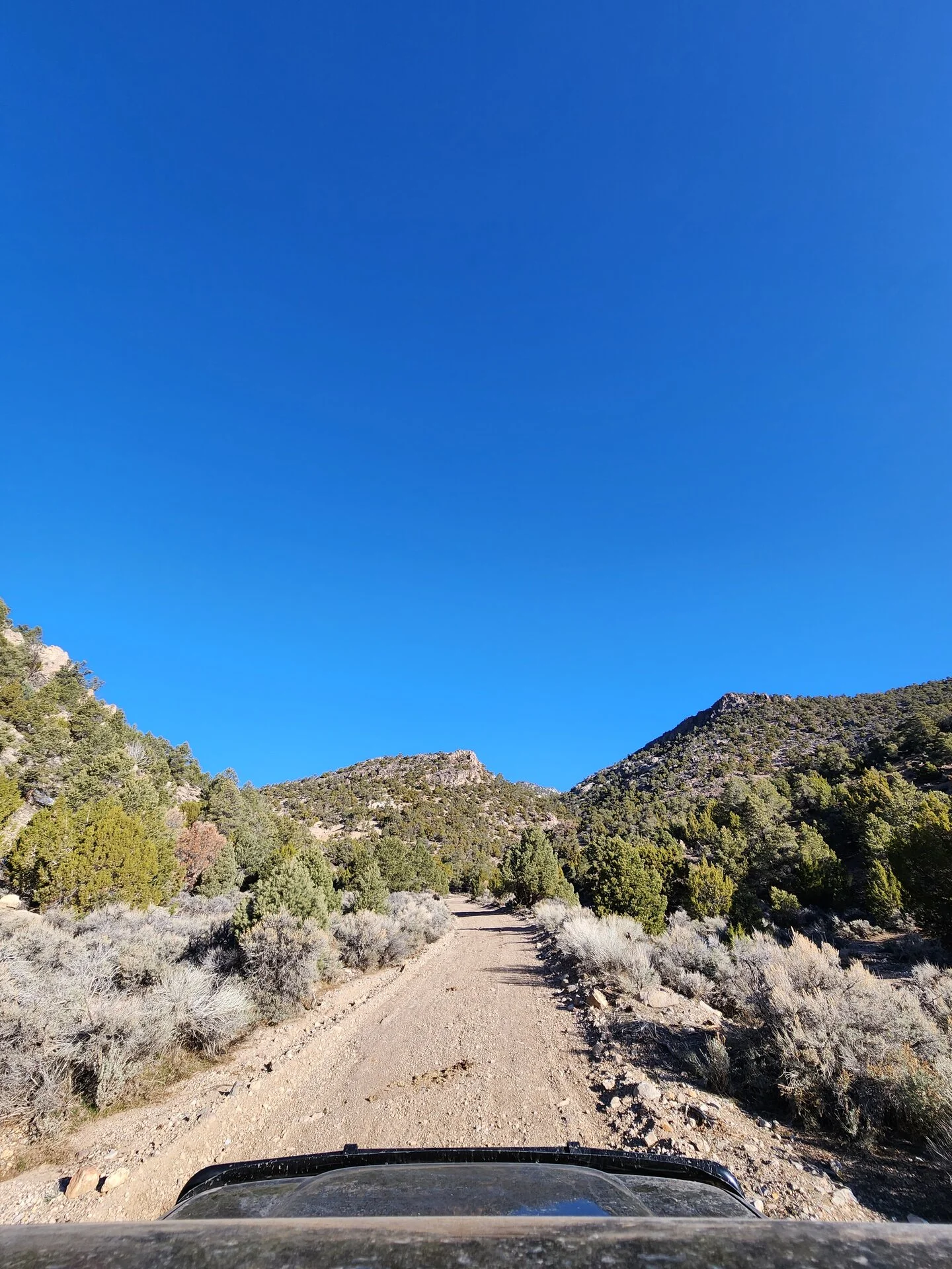

Working my way west, I eventually came to a point at which the trail began to narrow from a washboard road to a two track and headed into a valley.
