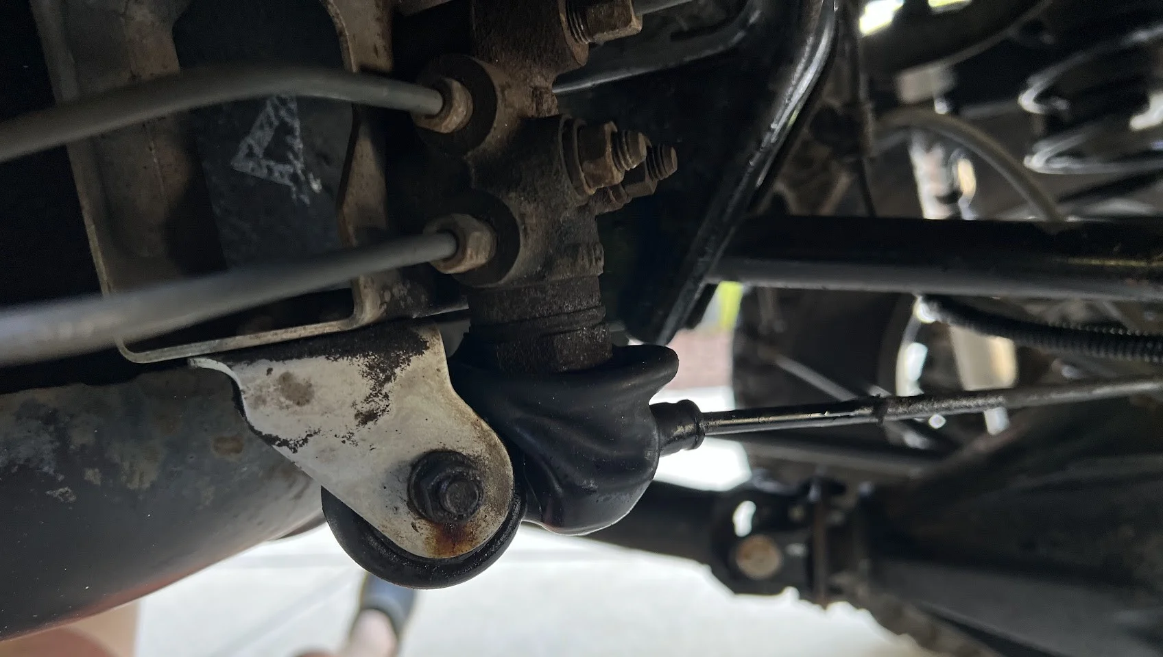

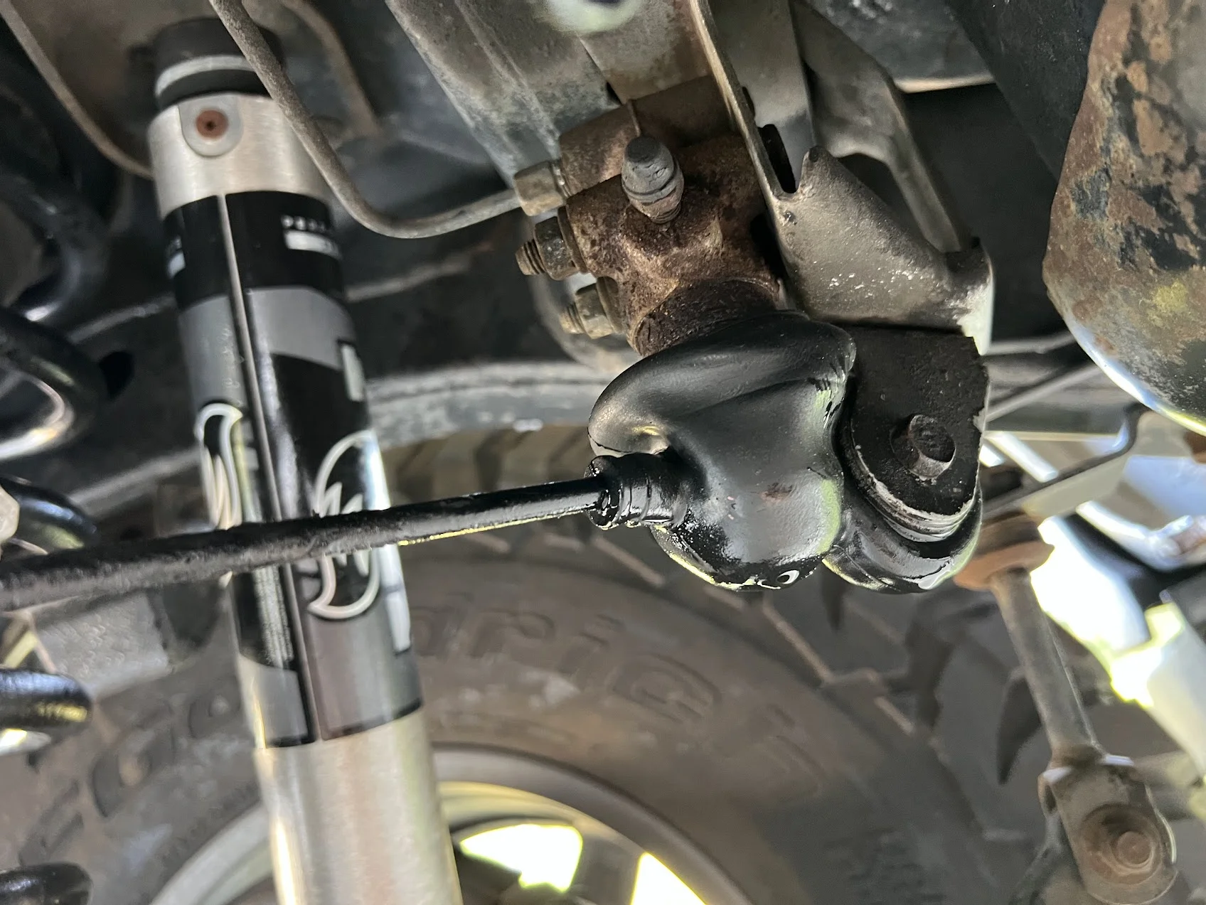

Definitely! I'm searching for information for this area where I'm seeing brake fluid. Anyone know the name/part? I'll take on some more research from there. Thanks!

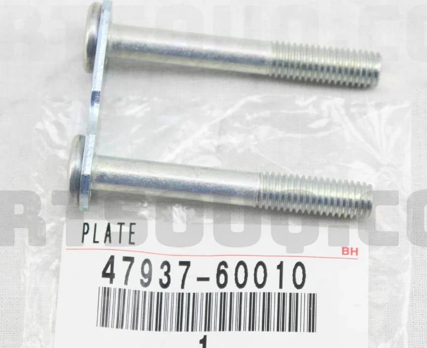

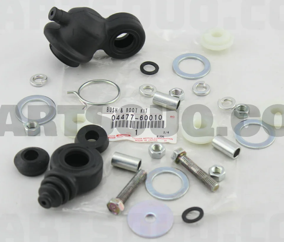

I would also recommend you buy:
You need (2) nuts. These are for the plate above. They are the same as the ones in the kit, but there aren't enough of them in the kit to mount the valve. Your plate and nuts will be rusted beyond use.

Ordered! Thank you.
