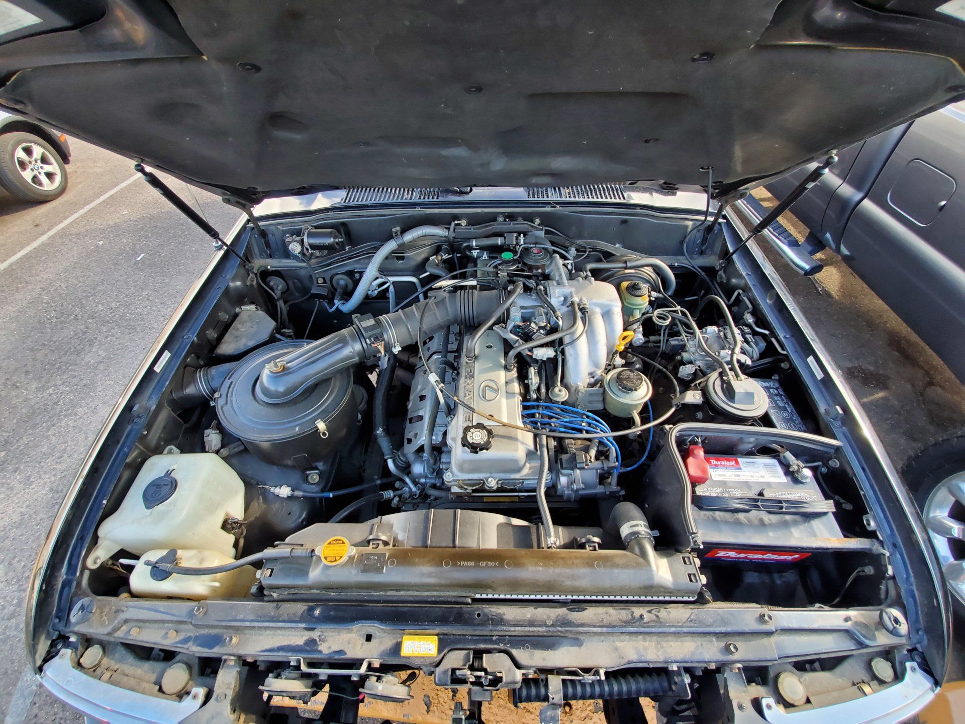

Under the hood, the day I picked it up:

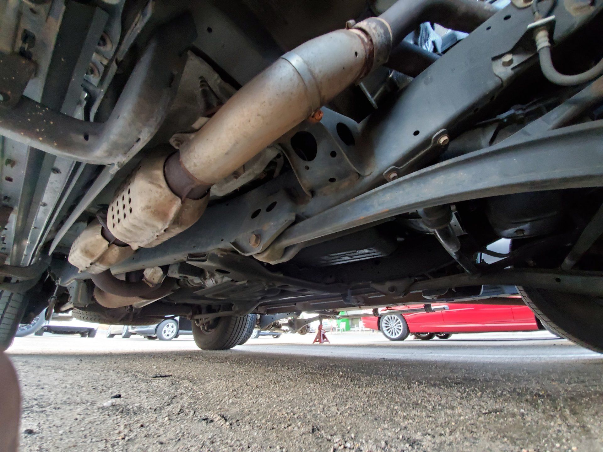

Under the truck:

I would set a few bills aside for a new radiator as funds allow. That yellowing is the early signs of aging. From here the heater valve looks newer but good insurance to check or ad to the list as the health of the cooling system is paramount. And grab some factory ignition wites when the time is due.

The original radiator in my Miata was the same color at 160k, I was thinking I'd be due for one in the LX before the weather gets hot again. I started researching OEM vs. Upgraded aftermarket this morning.

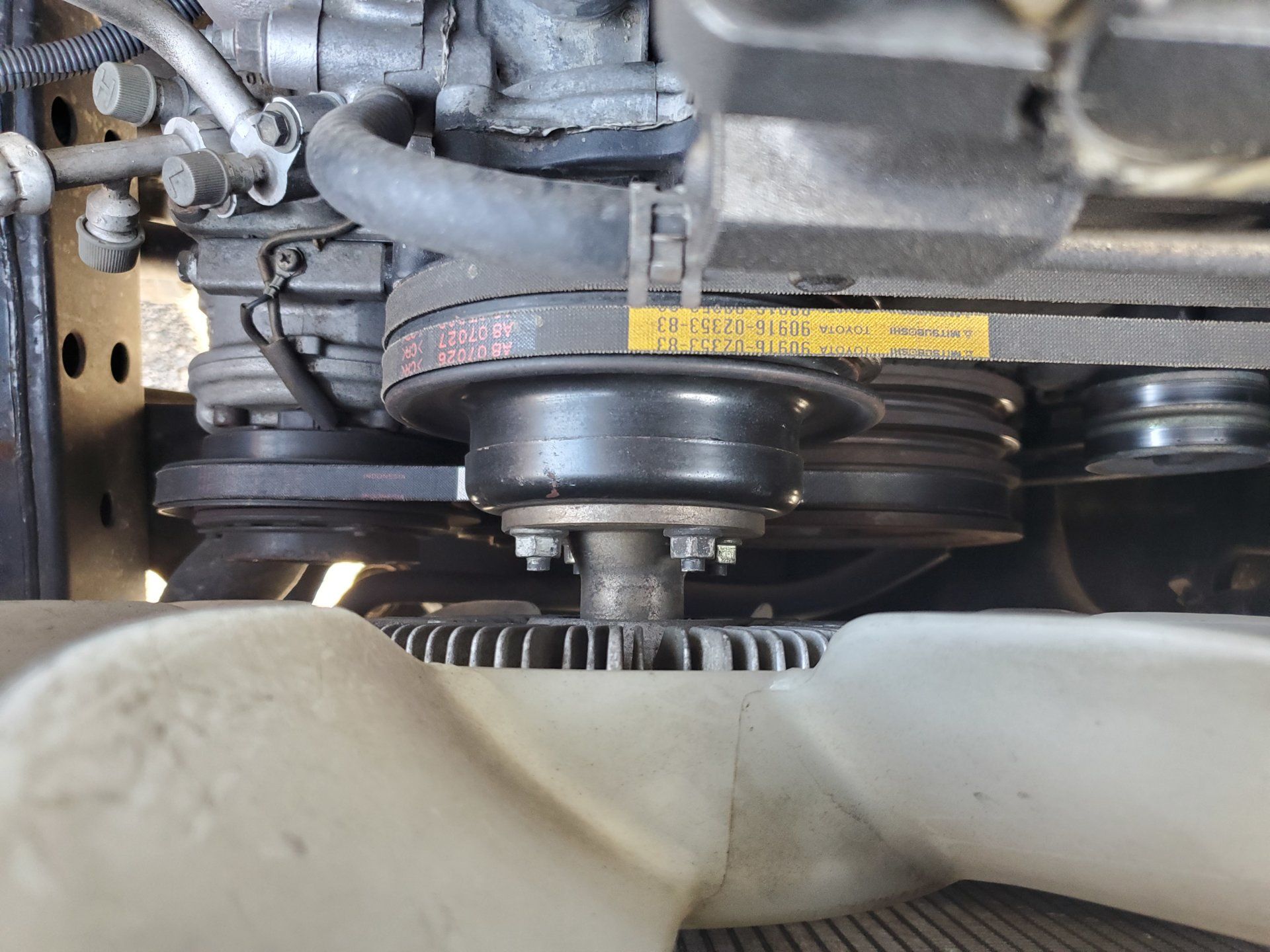

I popped the hood to check on belts and hoses but everything looks pretty good to me. The fan clutch feels like it has good resistance/ viscosity. I'll do my research on what else should be done while I'm in there.
Being at high altitude, will there be a benefit to upgrading to a higher performance unit, or will an OE Denso be an acceptable replacement? I'll be consulting the FAQ.
You probably won't know until summer time.
I have an older OEM radiator and I get into the 210-215* ballpark climbing Floyd Hill and the like on a 95* day. I have replaced my fan clutch with a modded one, which helped, but still didn't quite bring temps down to where I wanted. I bought a TYC 1918 to replace it based on MUD research. Cliffs notes on all that research: the TYC results in significantly lower temps for the Arizona guys, but it will not last nearly as long as OEM (or some of the other better aftermarket brands) and also may also be damaged in shipping. Should be treated more like a disposable radiator, but one that does a great job at lowering temps. Expect to replace every few years.

Search for the landtank blue fan hub mod thread.
Blue fan hub is probably the one to go for if you're going to buy a new replacement. Look at getting a modded one from Wits End.
Fan operation can be critical to keeping coolant temps under control. Particularly if you're working it hard climbing highway mountain passes in summer. I'm guessing Colorado has the occasional hill? :hmm:
You should be able to hear the fan roar as it cycles in and out.

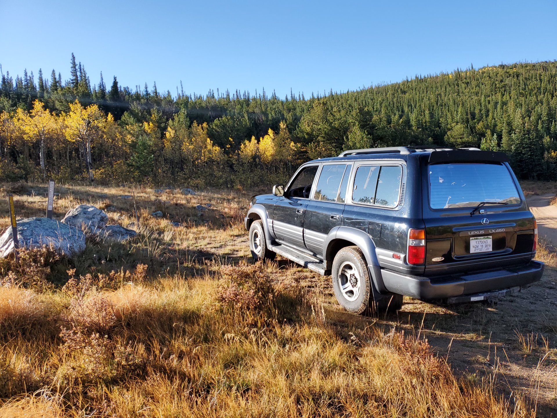

Not even a week after driving off the lot, I took it up to Caribou Flats, a moderate trail outside of Nederland, CO.
The September fall colors were spectacular, and the trail was fairly easy.
As a former employee of Land Rover, I'd recieved some extensive off-road training. I felt pretty confident. Aired down to 25 psi, the LX comfortably trundled through the woods. I know running solo is sketchy, which is why I picked a trail within walking distance to civilization and came prepared with a good radio, camping supplies, and lots of water.
Everything was going smoothly until I encountered a big ol mud hole. It had rained the night before. I am smart.
Pictures don't do it justice. Anyone who has run this trail can probably attest that it's a little gnarly. I came in from the high line on the right, then promptly slid into the hole. After 4-5 attempts at rocking back and forth, Chungus clawed it's way out, and off I went. Incredible.
Unfortunately, I did tag the front bumper. It's a touch dented now, nothing major. A small price to pay for a big lesson learned - run better tires. And pick better lines. I'm grateful that this was the only trail rash from my first time out.
Fun little trail. In the spring time, the mud holes just on the Caribou side of the creek crossing get pretty massive, but can usually be bypassed. My buddy in a Ram on 38" swampers got stuck in one of those holes a couple years ago. Would definitely be a chore on Michelin LTX's :)
