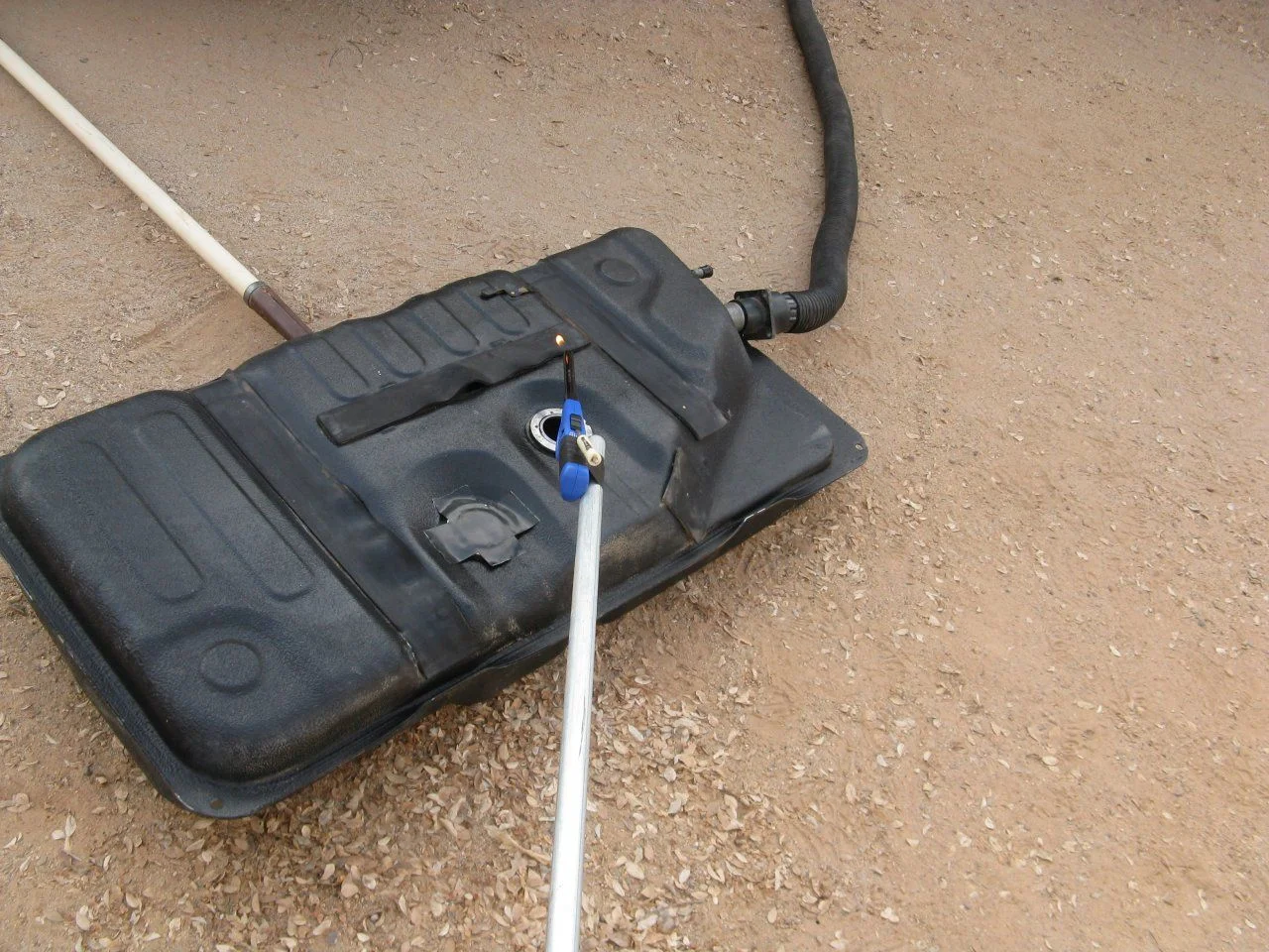

Try this.
I toss the Hose and Replace with the Reinforced Hose that will not Collapse.
Super Handy for Fuel Transfer.
The higher you lift the Filling gas Jug the faster it will flow.
I have filled my Cruiser many times this way.
Have a Drawer setup so put Jerry Can (or Scepter) on Drawer and Slide open Window and start Siphon.
Works Slick.
Stored in a Piece of 1.5" PVC with Cap that is Zip Tied to Roof Rack. If a POS Steals it, will buy another for $20.
