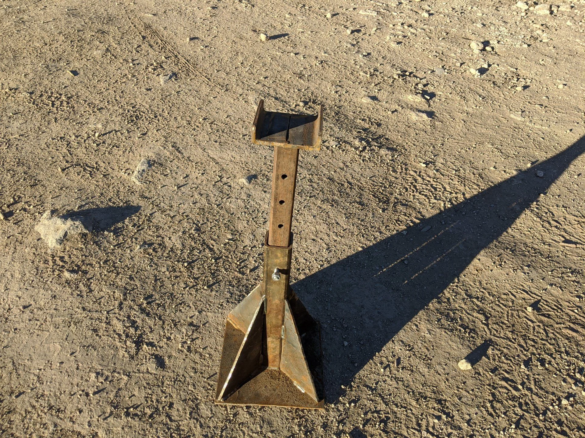

I built a set of these.

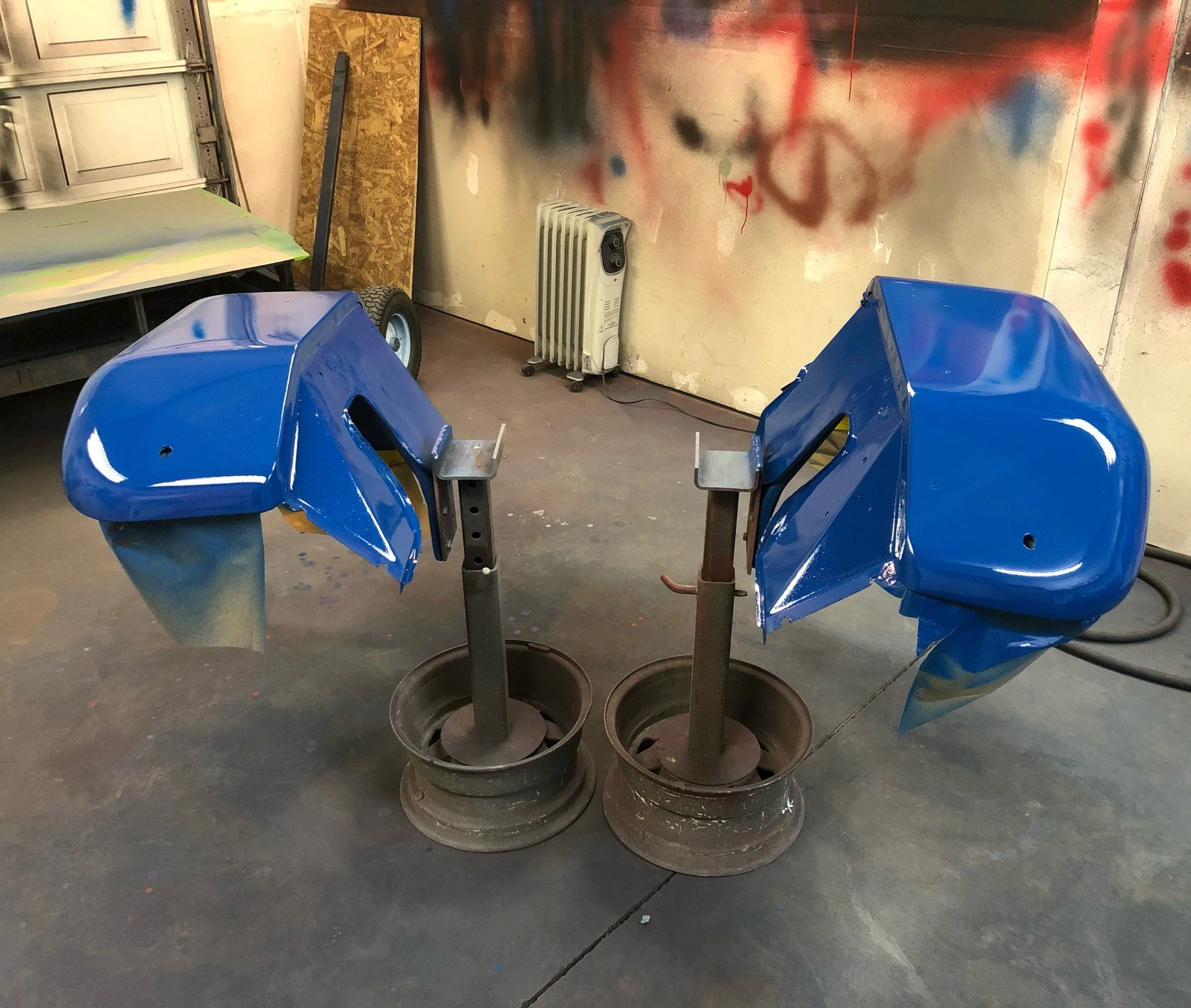

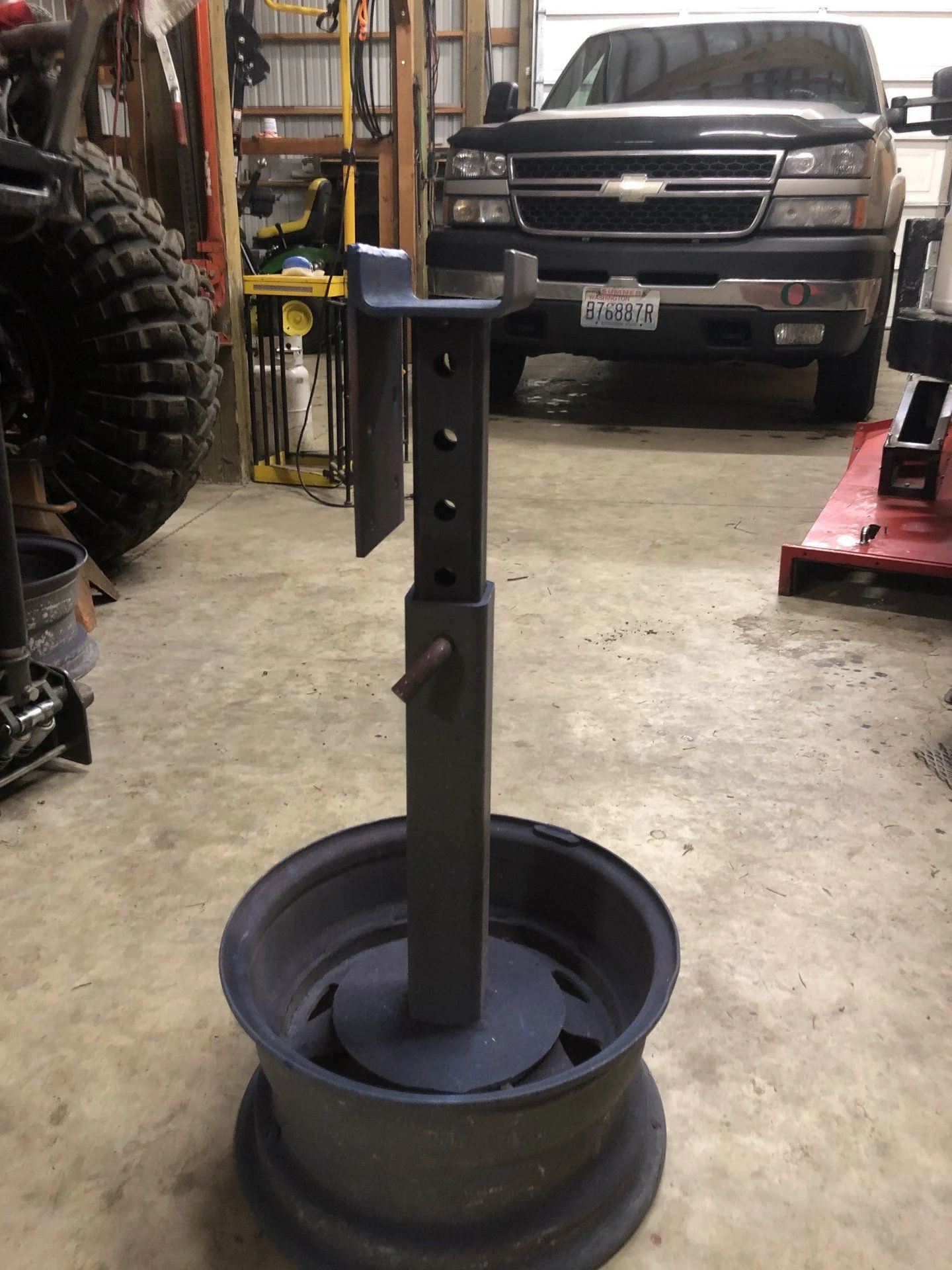

Any old wheel + 2" square receiver tube (male and female) + c-channel on top + 2" -- spaced holes in the male receiver = ultra heavy duty jack stand. This one ranges from 20" to 32" and has an auxiliary plate to hold FJ40 fenders (the last application):)
Nice, very interesting idea. I have plenty of junk wheels around here and I was just thinking of what to do with them 😀
