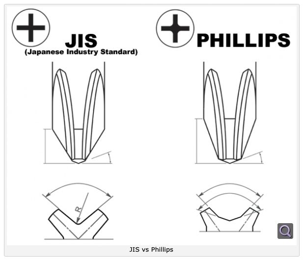

For those that wonder what in the world I'm rambling about, pretty much anything manufactured in Japan uses tools and fasteners that follow Japanese Industry Standards for size and fitment. What got my attention in particular is the JIS screwdrivers and screws. Which is basically their version of the Phillips but it has sharper angles and edges to prevent "cam out".

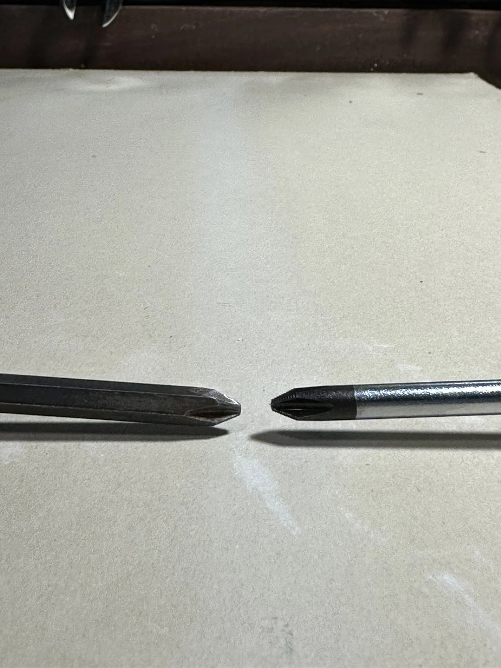

Vessel is one of the oldest tooI makers in Japan and I wanted JIS screwdrivers that were actually made in Japan. I got them in today and they are excellent quality and I'm looking forward to using them. They do seem to fit some Japanese made screws I had laying around better than my old #2 Phillips and they seem to fit just regular Phillips screws better too. I did my best to get a picture comparing the new Vessel "Phillips" to my old and very well used, Craftsman Professional I've had in service since the 90s.

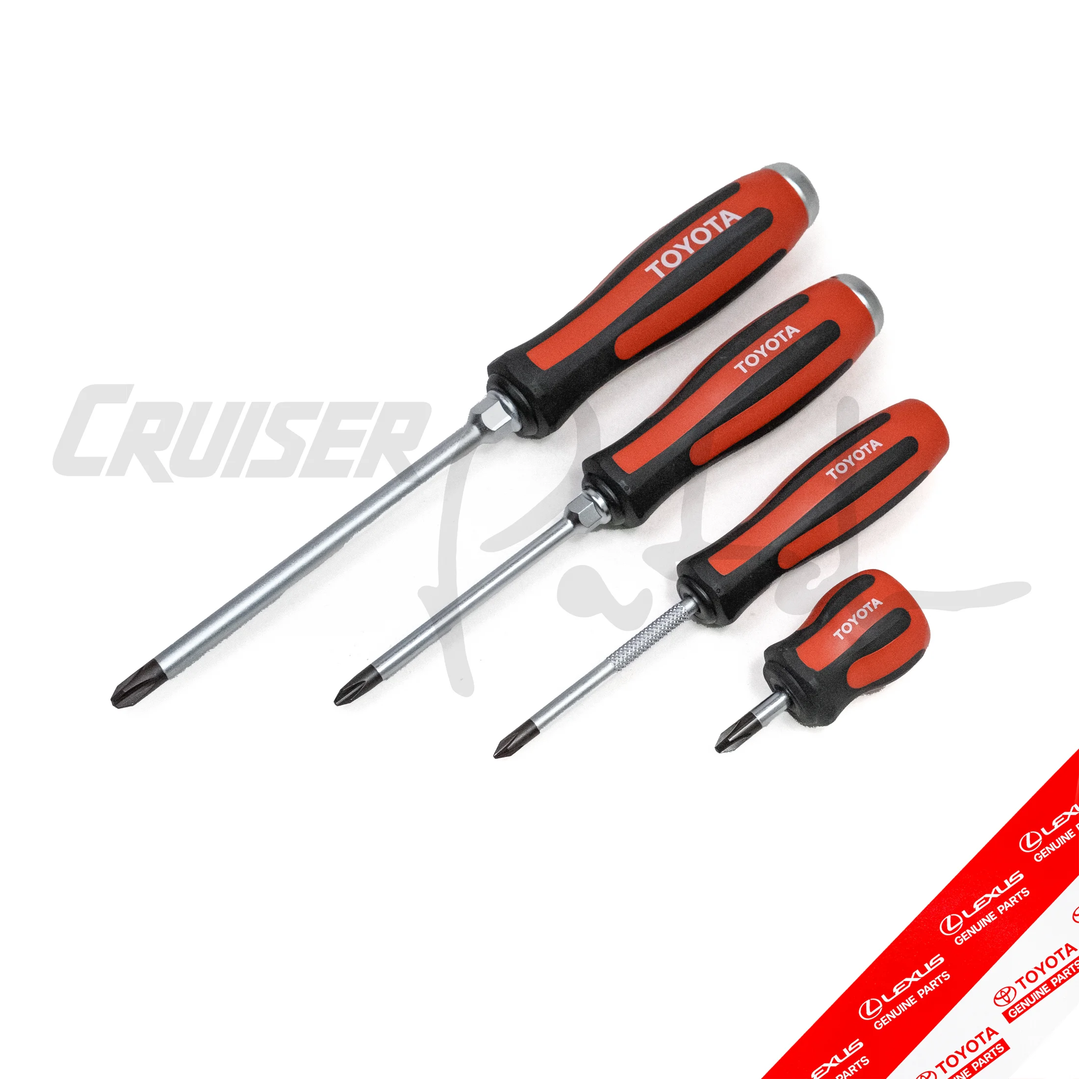

We stock a variety of OEM JIS drivers- some made for Toyota by Vessel.
See some examples here: Search: 8 results found for "jis" - https://www.cruiserpatch.com/search?q=jis
Full disclosure, I personally use Vessel’s JIS with Jawsfit technology but have not noticed any significant difference in use over the standard versions made for Toyota.
The right tool really does make the difference.

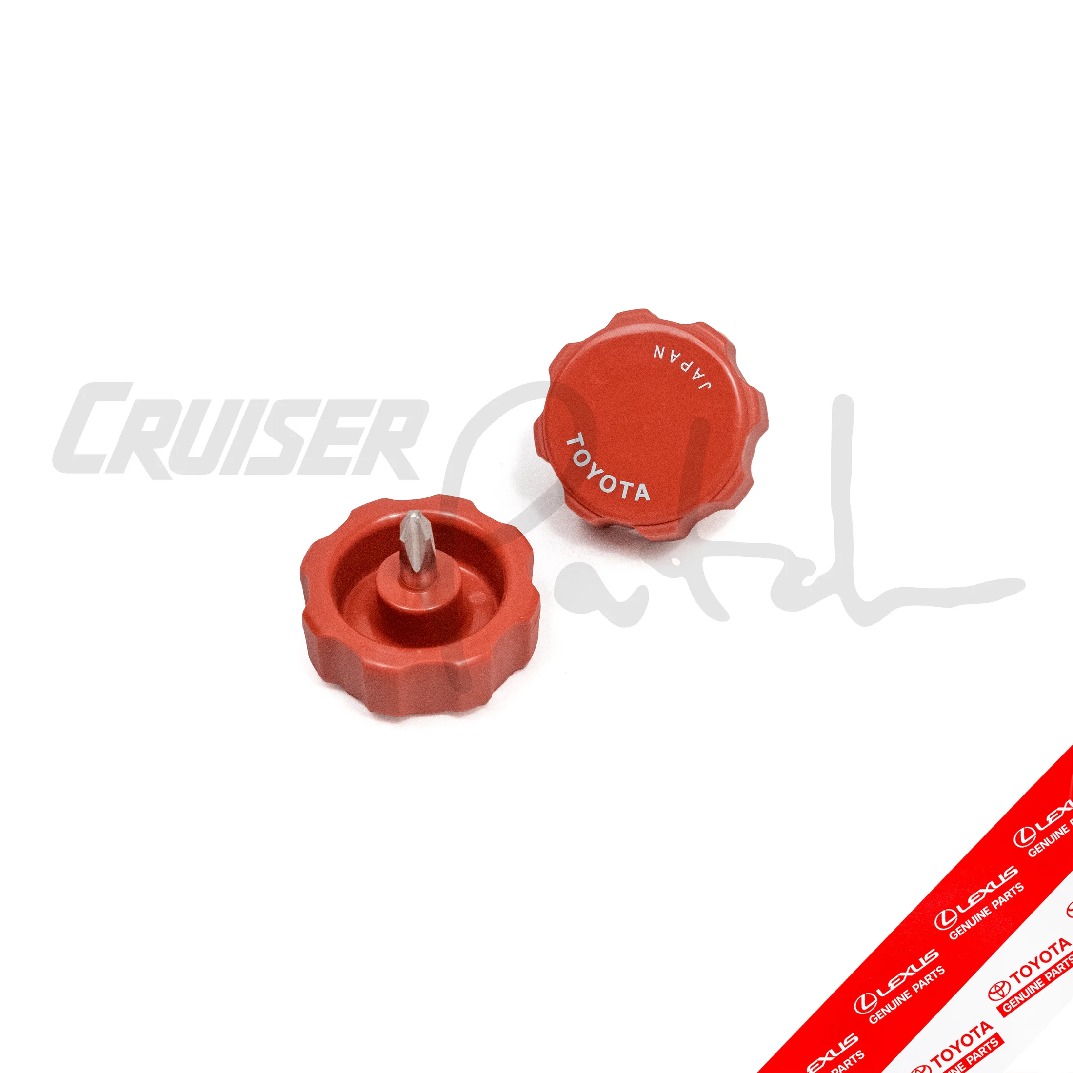

Thinking about putting together a good tool roll to keep in my truck using the original FJ40 tool kits as a guide with a modern twist. That switchable JIS/Slotted driver looks like a perfect addition.
Thanks!
^ I got one for free!
