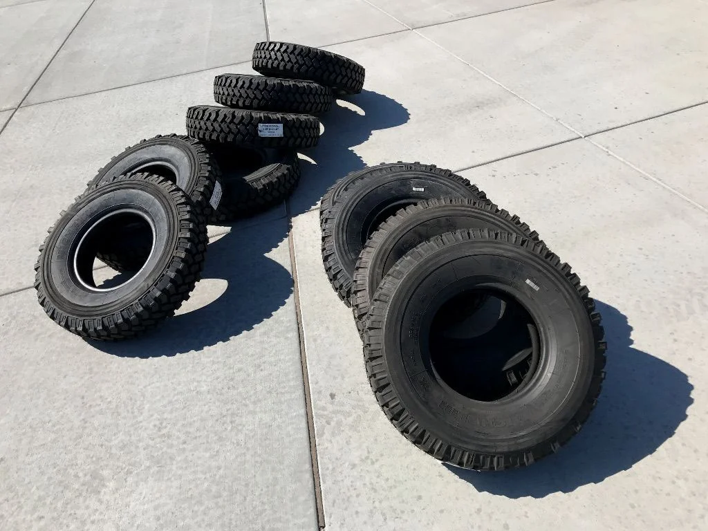

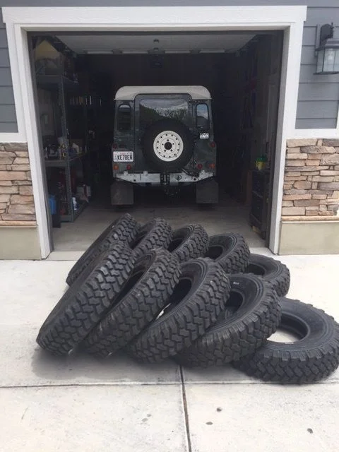

Now using 7.5016 and all I hear is remove those ugly wheels, even from the :princess:
But more comfortable riding, acceleration is worse, with trailer uphill a challenge, far less rear diff locker sound, 2 inch higher, better grip in mud, the pattern is michelin, sound is a bit more but no problem, they are very heavy and seem impossible to get in usa for a normal price.
no need for special rims or spacers.
All terrain or not is simple to me, I don't carry extra mud rims, the tire I have must do it all.
file.php
file.php
file.php
I know the question is not post pictures, :hillbilly: but wide tires are not for me, they just spin on the mud, the skinny digs in and gives forward momentum.

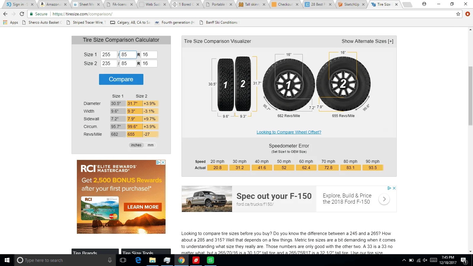

My tire of choice at the moment is the 235/85/16.
Been on my '45 (cooper st maxx) for a year or so and I have set going on my camper van (falken AT3/w) tomorrow.
It works out to a 32ish x 9.5ish size. Both trucks have about 2" of lift.
I think a larger variety of the 255/85/16 would be close to ideal for guys with more than a couple of inches of lift.
They are closer to 35x9.5.

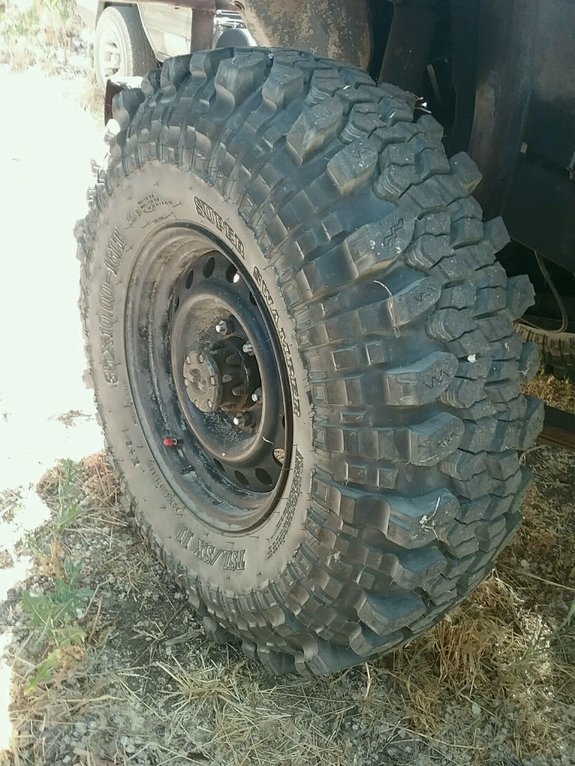

I've been running Super Swampers based on the sizes they offer currently running (Bias ply) 35x10.00-16LT SX2's on the 40 series mounted on Tundra steelies and 36x12.50r16 TSL radials on the 80 series stock alloys.
full
full
To have more options available in a tall skinny would be great, Interco has the sizes but are limited by construction being bias only in the SX2 line | Interco Tire

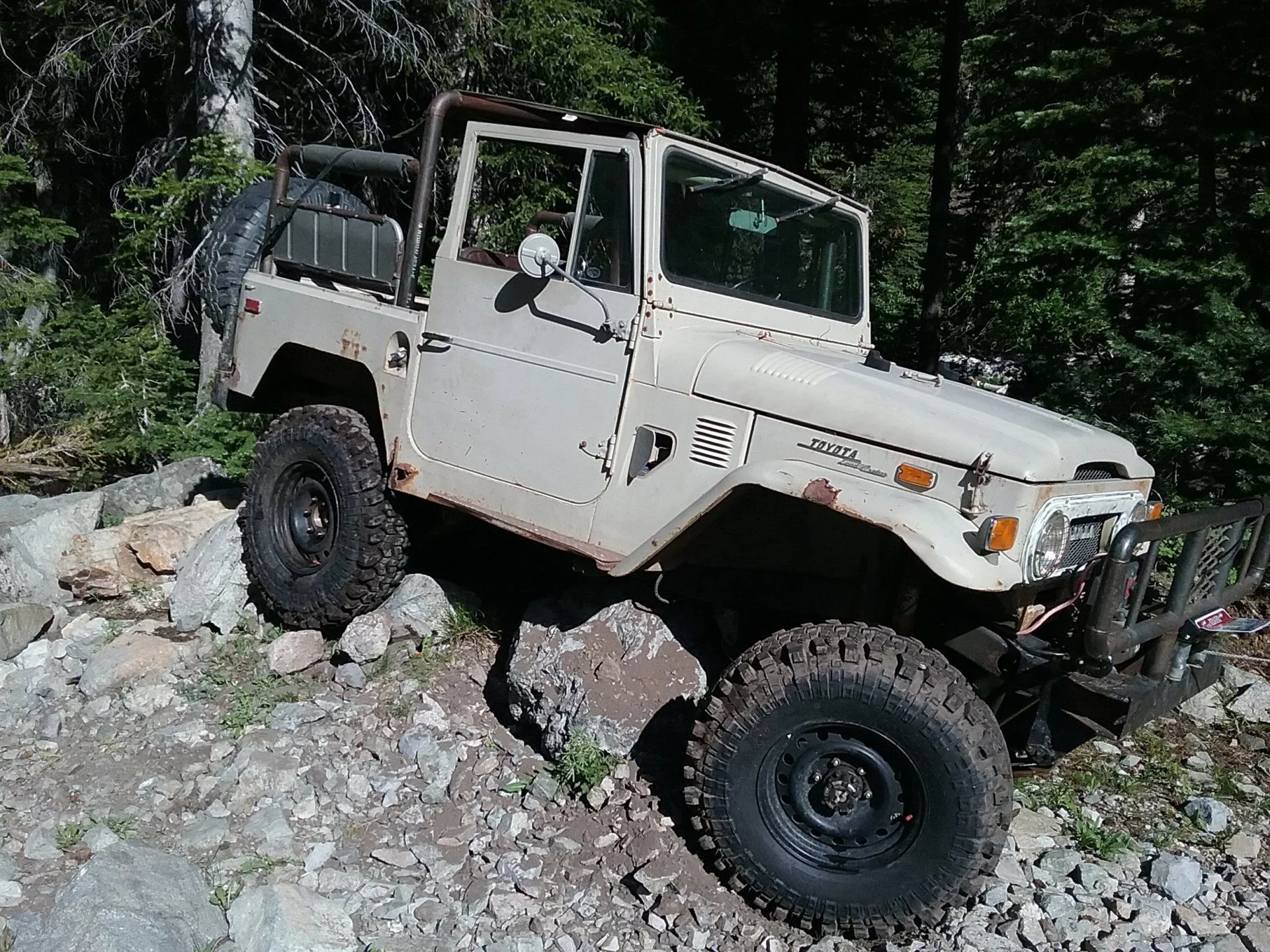

WOW! :worms: To each his own, but I always thought that a 32/10/15 would be about perfect for the "keep it stock", resto guys who want to run the stock steelies on their FJ40. My .02
